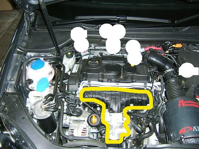

        could the intake manifold be used as a sludge indicator?
        I ask cause it does seem like the easiest part to get to.
        or is it possible for the intake manifold to be clean and all the other pipes and stuff dirty?
              Ignore the white dots, erasing other labels. Sludgeville is outlined in yellow, but includes inlet ports in the head.
