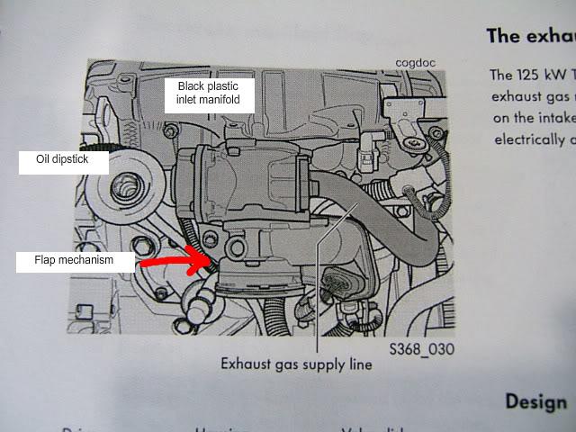

            The run away prevention is the throttle flap mechanism, a seperate mechanism below the EGR pipe, it shuts off the inlet on shutdown, and if there was a case of runaway, turning the car off would save it. I've also unplugged that, and it is noticably harsher on shutdown, has a bit of over run. I'd be leaving that in, but again, I'd like to tune it so it just does the start stop function.
            The sludge starts where the egr pipe enter just prior to the black plastis inlet manifold, and it's a good bet the entire plastic manifold is similarily coated in sludge.
