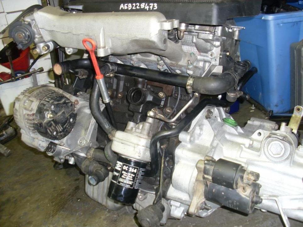

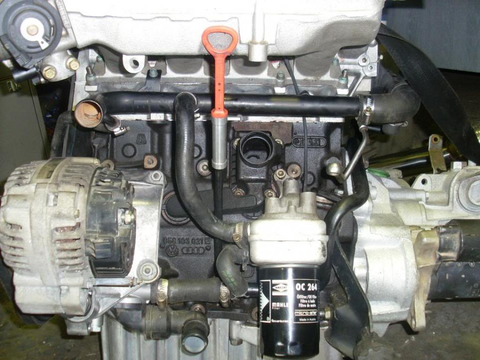

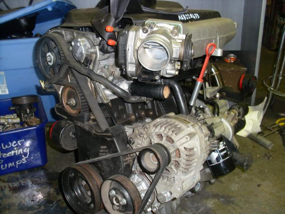

  • Pics of assembled engine with my custom water piping to change it from a longtidudinally mounted Audi engine to a transverse setup.
    Just gotta put that in here

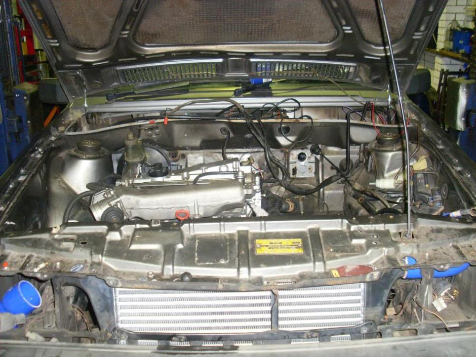

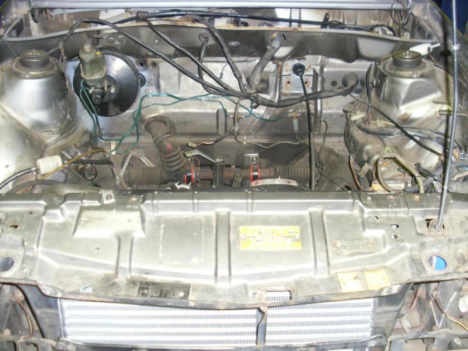

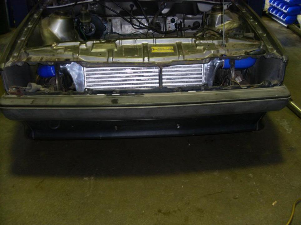

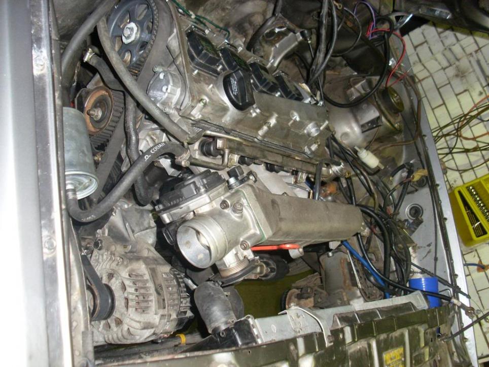

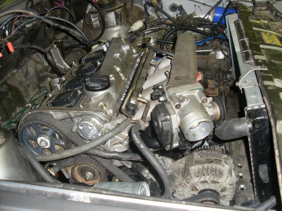

    And finally after some swearing and wrestling, its in.
    Heaps left to connect and a modified shift linkage to make, but ITS IN!

      What's it take to fit one of these in? In physical terms, ie engine mounts etc
      • WOOOHOOOO nice work Matt saw the mans handy work last week looking farkin sick man!!!
          Well done.
          just for interests sake.
          You need an early 1.8T block from a Passat or Audi A4 for a Mk1, as it has the boltholes for the Mk1 Engine Mt. Use a Diesel or GTI Mount.
          You can use the later motors in a Mk2 or 3 as they use different brackets.

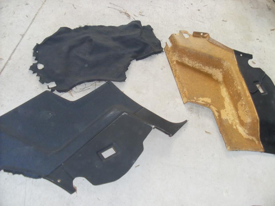

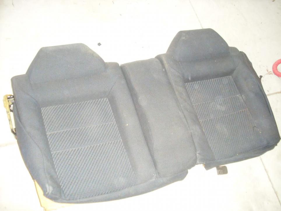

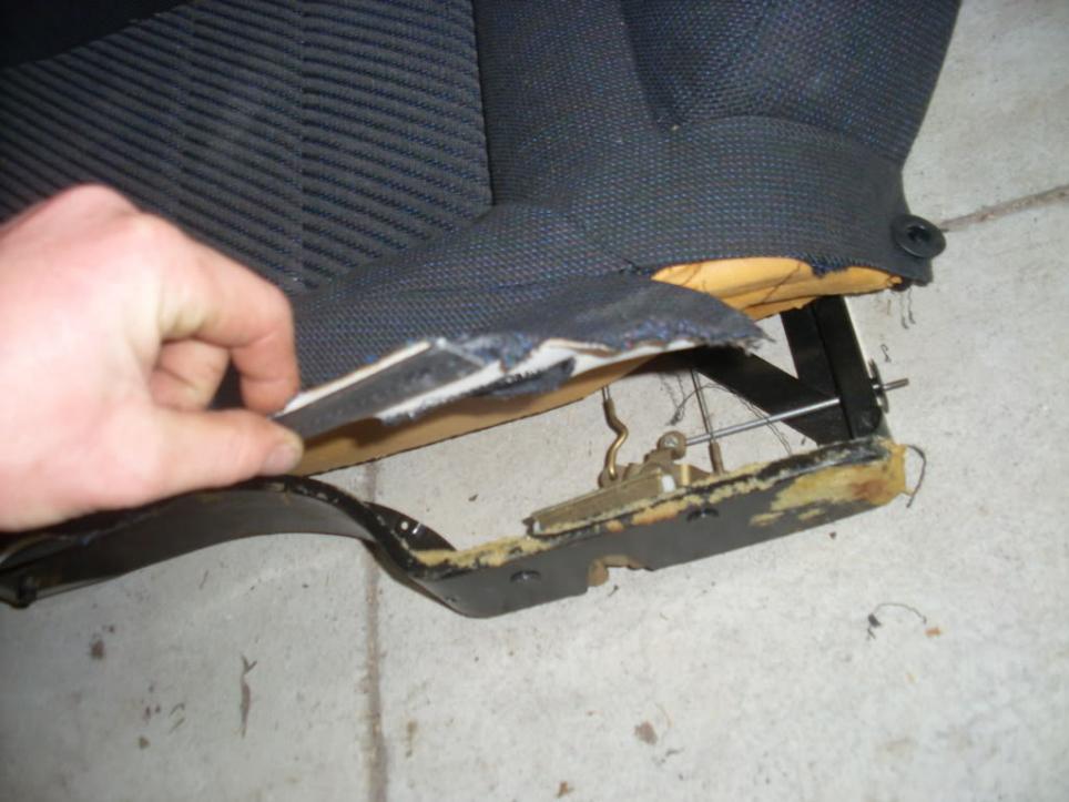

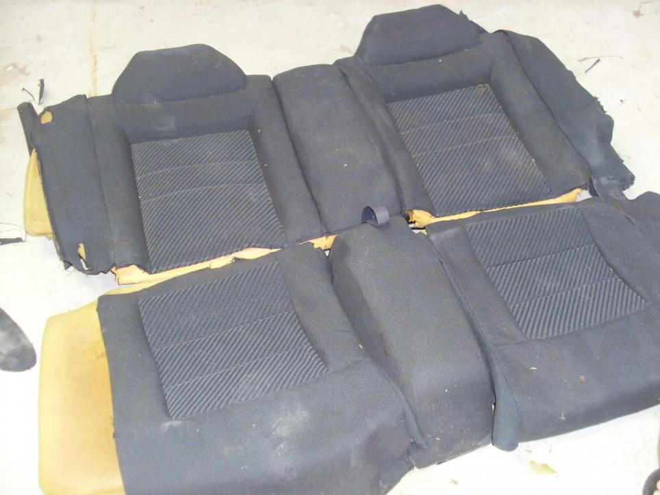

            • OK, so whilst the engine is nearly in and the interior is out for the pedal box and other mods, I took the opportunity to sort out the seats. The original ones were baked and faded.
              I recently imported a set of Corrado seats for the car. Fronts fit and are glorious, rear is not even close, but I couldnt sleep if the front and rear seats dont match, so I`m gonna use the Corrado Skins and the Rocco bases and hopefully keep the centre armrest.
              Here is what I did today.
              Pulled the fabric off both sets of seats
              Rocco frame with foam and cloth from the Corrado
              Gonna need to add a bit of fabric here for this seam
              So I steal some from the doortrims. This was hard yakka, that glue is strong.
              The base of the rocco seat with the corrado cloth, gonna need to add some fabric here and get the armrest to fit in the middle.
              Fortunately the Mrs is a seamstress and we have an industrial sewing machine. Some more measuring and sewing tomorrow hopefully.

                      The rear seat of both cars are a similar size, but different shapes. I reckon with the retrimming of the corrado fabric, I can end up with something that looks factory and is a factory fit into the rocco, but incorporates the headrests and bolster features of the corrado.

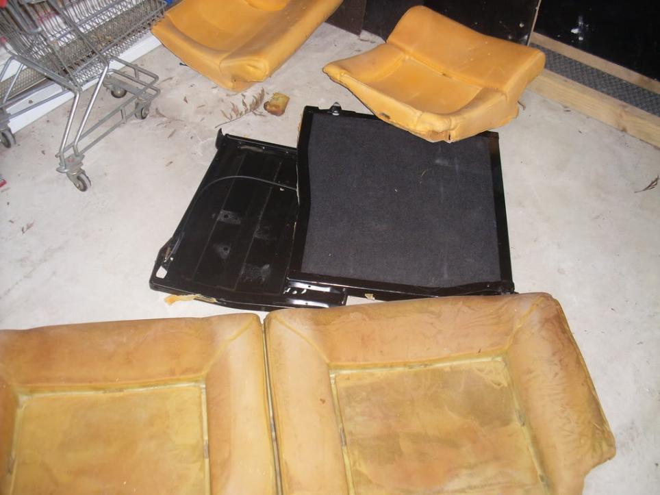

                              • Did some more sewing today, or I hindered and the Mrs ignored my plan and started cutting and sewing.
                                Basically we are putting in a panel at each end of the seats to make em fit the wider scirocco bench seat. I cut up the rocco rear padding to give shape to the sides and cut a chunk out of the foam in the base of the seat to allow for the arm rest.
                                Here is a mock up of how it will look.
                                Plenty of seams to finish and tidying to do, then onto the frame it goes.
                                Hopefully this will motivate me to finish the rest of the car.
