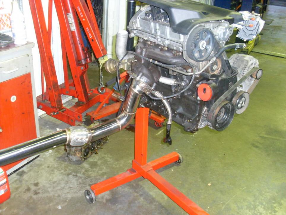

When I rang up to pay for this, I looked on their website and saw their new line in 2.5" stainless downpipes to connect a 20VT into a Mk1 or Scirocco. I had to have one and it arrived yesterday.
Bolted it up to the motor for a trial fit
Motor could go into the car in a day now, just needs the sump and a few hoses.

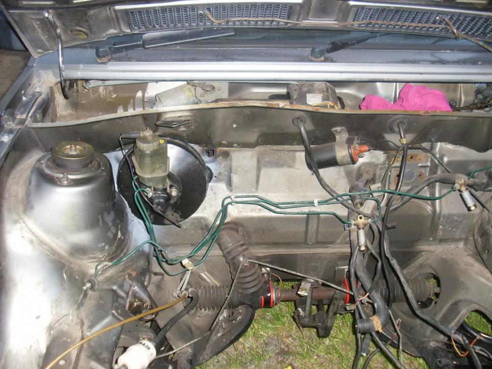

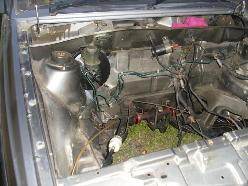

However, I had pulled all the brake linkage bar setup apart, and the pedal box, so this has to be fixed before the motor can go in.
This is what I achieved today.
No more linkage bar and vague brakes for me. I used a Seat Ibiza 1.4 8" booster, master cylinder and pedal box. In front of the driver. Tomorrow I will modify the rocco column to fit into the beeza pedal box and that should be that. Will also have to fettle the acellerator position a little too, but that wil be beneficial for the throttle body position on the 20VT.
It brought a tear to my eye having to hit the car with a hammer and a holesaw, but it will be worth it for the sake of good brakes and an uncluttered engine bay. I reckon I can make it look factory by the time I`m done anyway.sigpic Camden GTI Performance. VW / AUDI Specialists

Will be very interesting to see how the brake booster/MC relocation turns out.

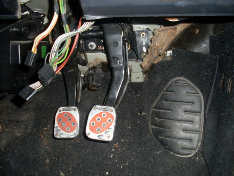

Had a bit of time recently to get this baby hapenning.
Finally finished off the pedal box and steering colum. Had to custom make and modify a few thing. Its now virtually a Mk3 setup, acellerator pedal goes along the bulkhead on a rolling beam and comes out on the passenger side. Means I can use a nice short throttle cable and it will be a standard VW one, not a custom jobbie.
Brake booster is in properly and brake lines are connected up.
