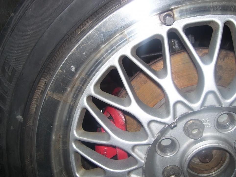

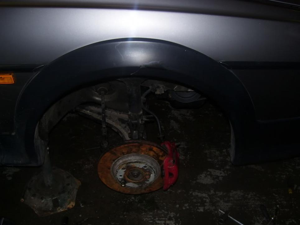

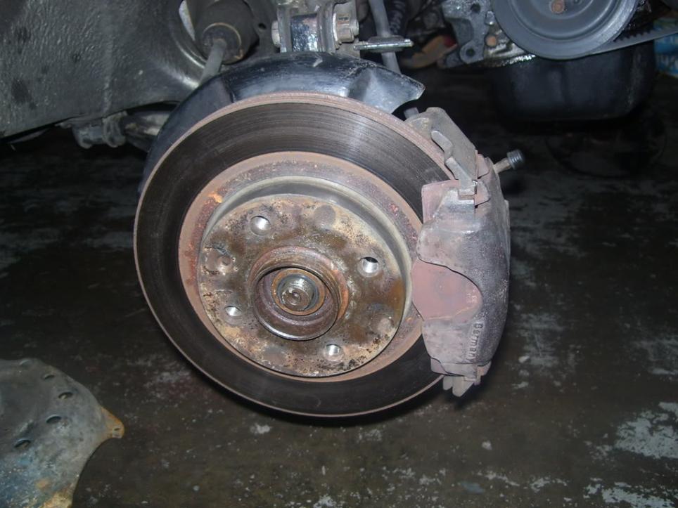

            However, the brakes are pretty average, so i took the opportunity this week to put on the 280mm stoppers I sourced from Tim and his engineer friend.
            Before
            After
            Through the wheel
            Changed the whole hub including rotor and caliper.
            All was sweet with a wheel alignment
            Car stops heaps better and will do even better with a proper bleed and some better back brakes.... Sooon

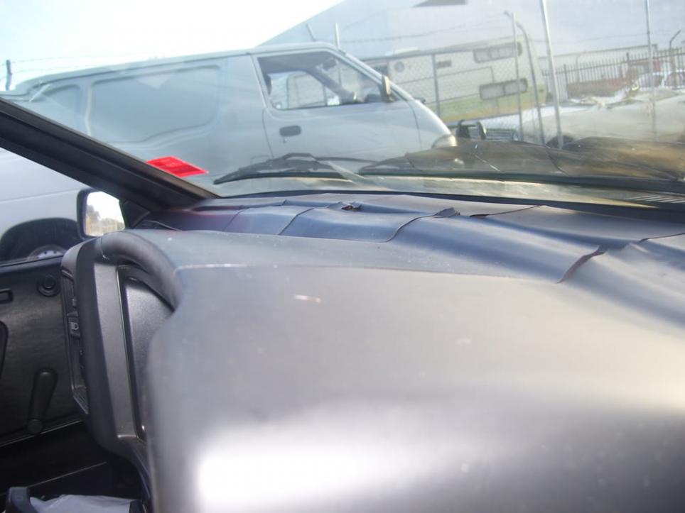

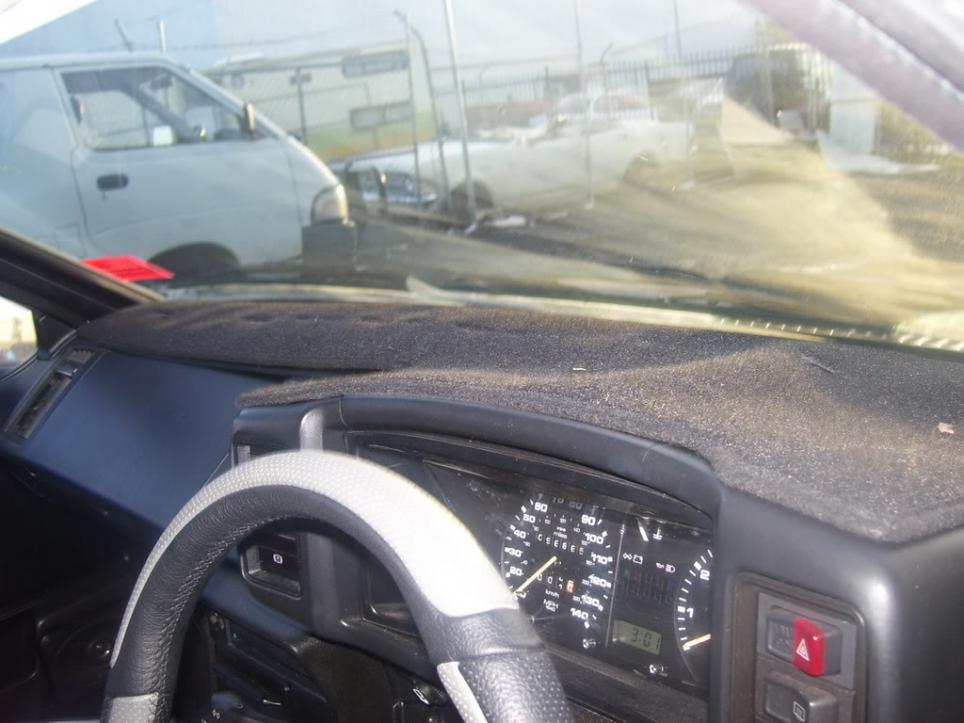

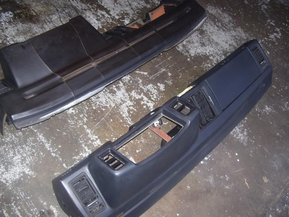

                Had a bit of time left, so wanted to swop the old rooted dash for the uncracked one I got from the UK last year that has been waiting in the shed.
                Old one with cover. YUK
                Old and New
                Originale
                Didnt quite get it finished, so no final shots, but it looks heaps better, will update when I finish it.

                  Matt... I hope you remebered to put the nut back on the end of the CV joint! (Or is it just in deep??)
                  • #69
                    Thanks Brackie, I sure did, that pic was taken earlier. All nuts were on and tight and then the centrecap was fitted.
                    • #70
                      Nice work Matt looks really good better than brembos
                      Is that Scirocco dash like the Corrado dash it looks similar?

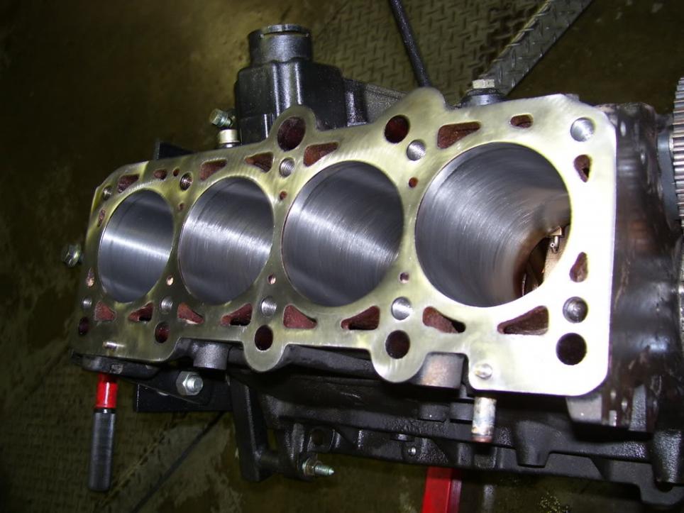

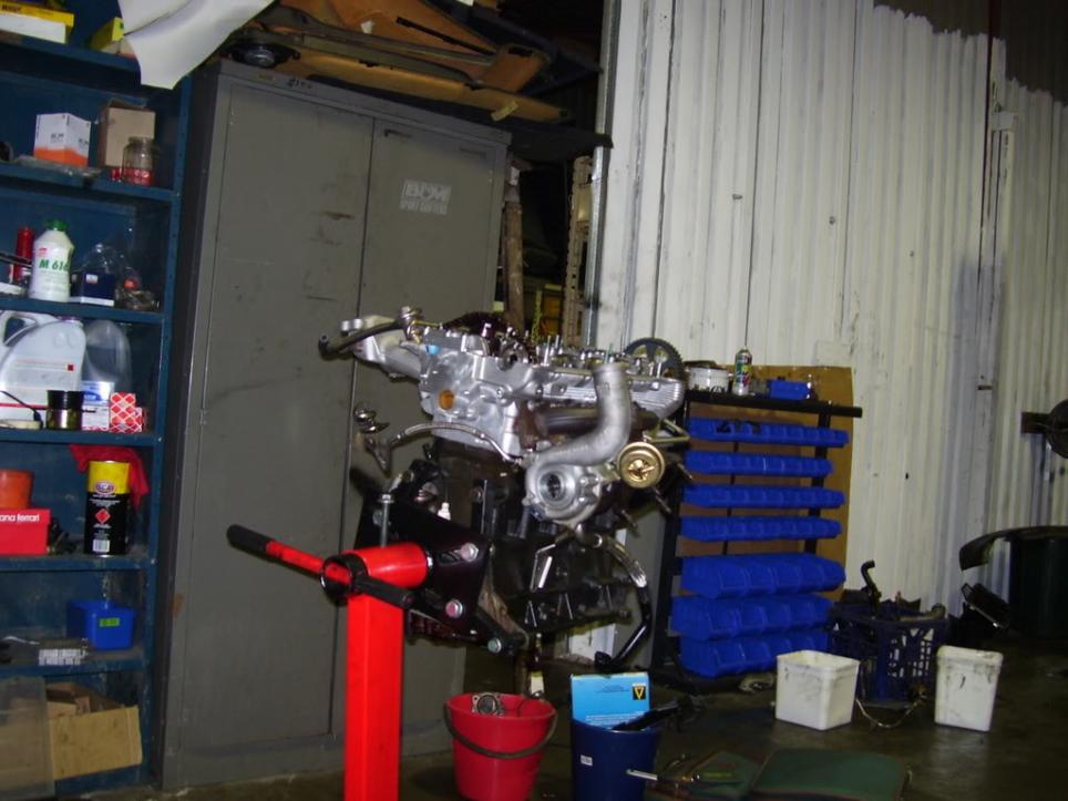

                            So managed to find some time this week to start building the engine for the Rocco.
                            Its an AEB Engine code from a 1.8T Passat 1998. I bought the motor with a snapped timing belt and got the head rebuilt to the tune of $800! 16 out of 20 valves were cactus.
                            I was gonna just slap the head on the original bottom end, but mastertech Beau did not like the condition of the pistons, so we pulled it all down.
                            New rings were no dramas, bores honed up nice. Conrod bearings are some fancy butterbearing that crushes when tightened, $290 Trade price from VW. Not Happy.
                            Block honed and polished ready for pistons.

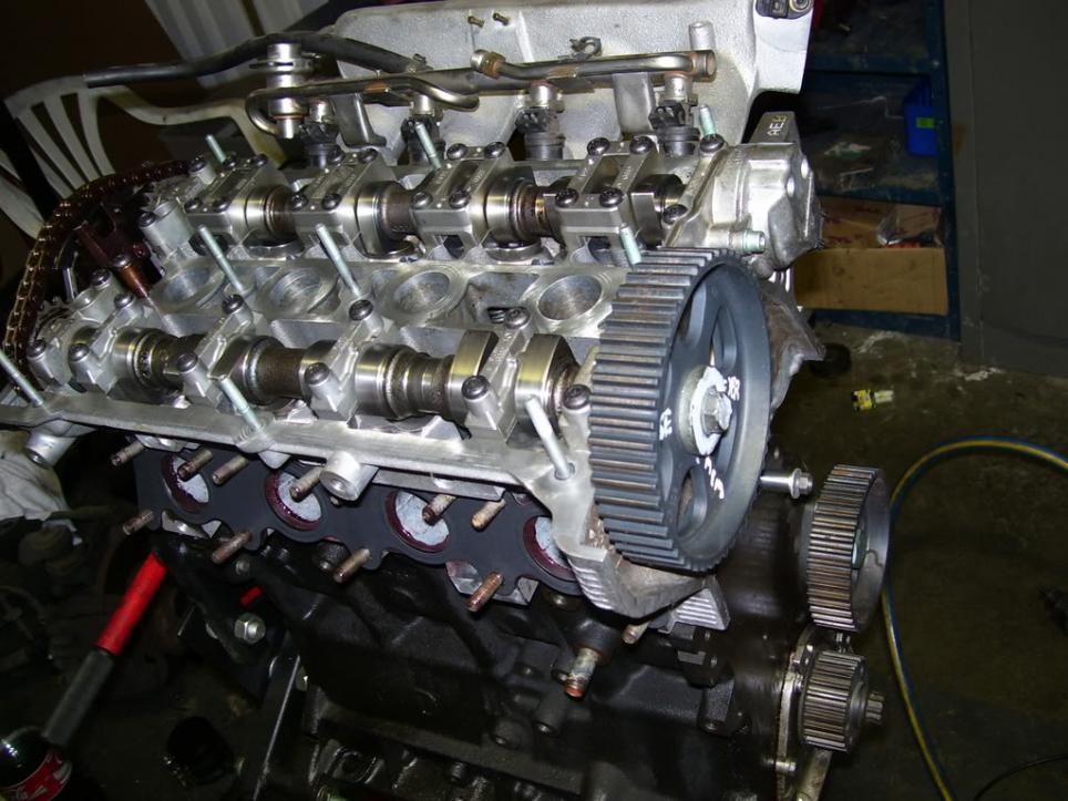

                            Head sitting on
                            Close of play today, manifolds and turbo sitting on there.
                            Got hold of the Golf intake, as the passat one is the wrong way round, thanks h100vw
                            Also scored a turbo from dub20v. Thanks mate.
                            Some of the lines for the oil and the water to the turbo need to be modified as there are differences between the engines.
                            I am using the AEB block, as it has the external waterpump and the boltholes for a Mk1 engine Mount
                            I have a custom idler pulley and a longer timing belt to clear the mount.
                            The rocco runs out of rego in april, so will probably pull it apart after that.
