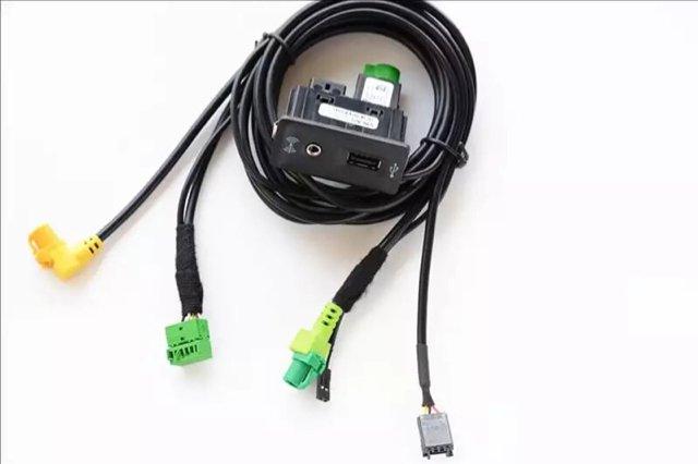

              • Hello Kamold,
                I successfully installed my vehicle this device. But I have 2 small problems.
                I use a can filter adapter and I have a 3D cluster. The adapter didnt have a USB connection. I found the correct pins connected and I started, but I could not find where to plug the Aux Pins.

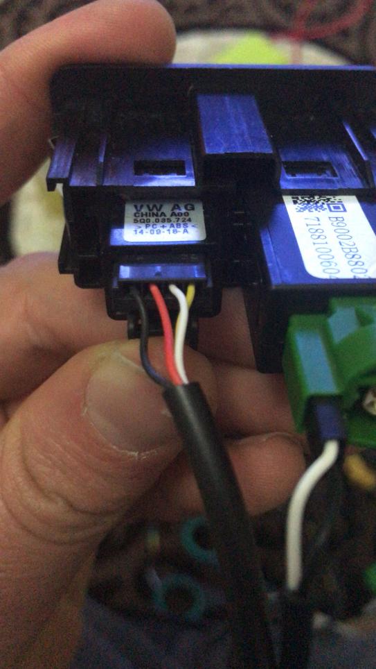

                My aux switch has 4 pins I posted my aux pins photo.

                • What do you want aux for?
                  It's pretty much obsolete these days I would think?
                  Aux pins are:
                  T12j/2 (green)AUX/MDI Left
                  T12j/1 (green)Aux/MDI GND
                  T12j/7 (green)Aux/MDI Right
                  Maps sdcard you can just format it and install the correct maps.

                    Hello, thanks for your reply. I want to use completely this device [emoji4]
                    I am using this harness but it has 4 aux pins [emoji4] 3 ok but 4th pins? [emoji16]

                    • For USB port you can get a generic aftermarket USB port for Golf and plug into the discover plug hidden behind.
                      Yes you can use golf 7 camera, it requires some body panel cutting like mk6 camera in mk5.
                      Aux pins you only need left right and ground. Not sure what the 4th pin is maybe just shielding?
