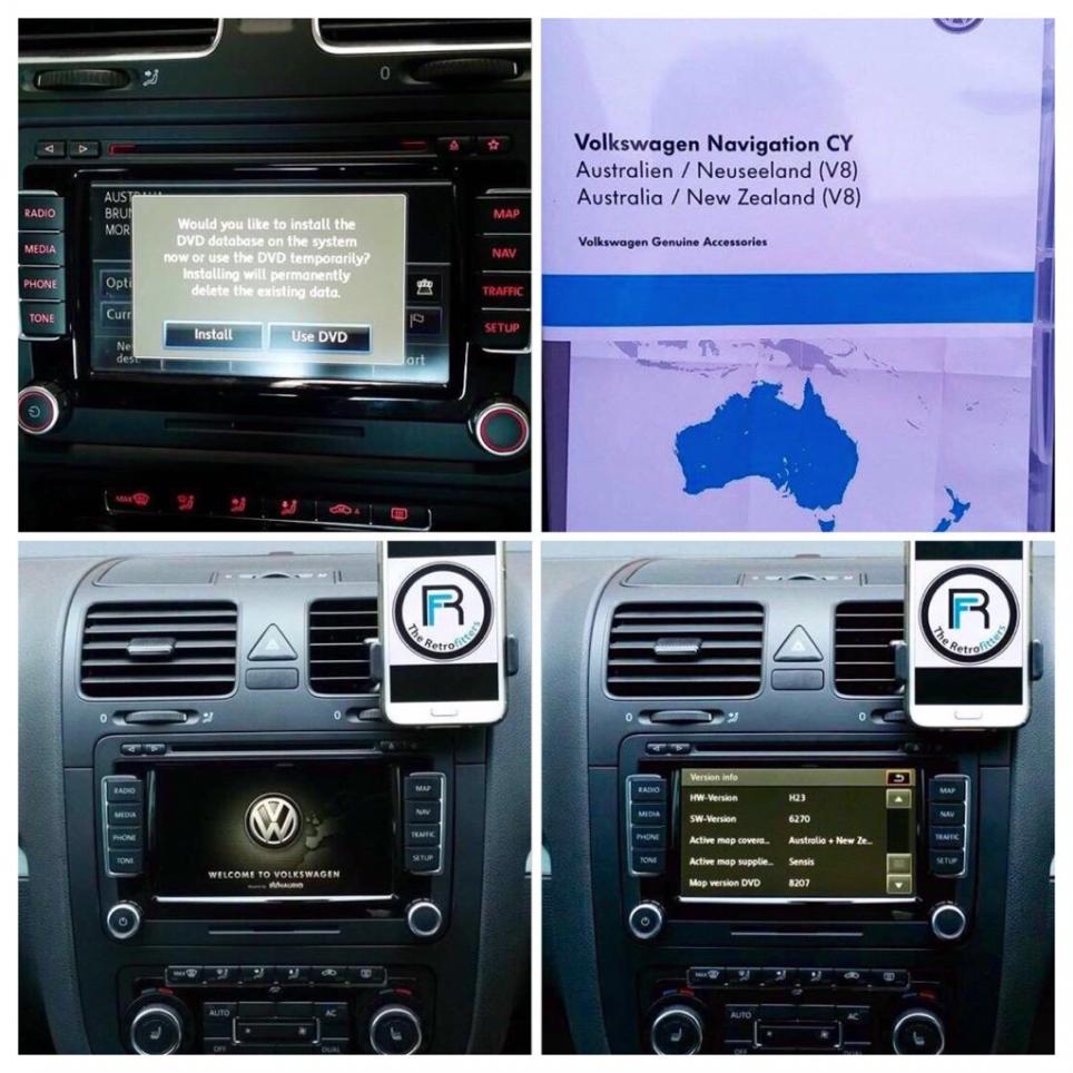

    Ok Got disc and it is genuine..... saved me $810 dollars .......
        I hope he extends this genuineness to those he is dealing with remotely. I have ordered from him too, but he is being a little cagey about sending the Article ID off the Australia Post receipt. Guess I'll know next week, and will report back here to let others know too.

              • He told me he got the disc delivered with a new Tiguan and decided he did not need it since they were pre loaded will be interesting to see if he has more....

                  • Got the V8 nav pack from Alex, and it is sealed and genuine. I offered to post the results of my buy from Gumtree here because I thought that might be useful to others if he had more to sell. Unfortunately, he indicated in a text to me that he only had two, and both of those are gone.

                    • Just updated my RNS510 from 2720 to 4120 with thanks to all that have posted here with instructions and feedback. Also updated my Aust maps to v7 and am pretty happy with the results!
                      Only thing I seem to have lost is the 'next turn' navigation view on my dashboard console (next to the speedometer). Anyone have any experience with this and know why and/or what can be done to bring it back?
                      • Still works on mine Scroll across with your r/h steering wheel buttons to see if its there but hasnt swapped over to it
