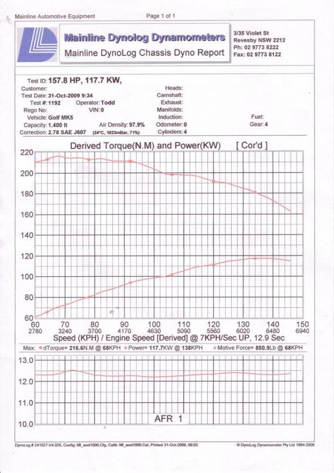

                    Results from the dyno day:
                    (Mine is a MkV 1.4)

                      Would be awesome if someone with a stock GTI posted results from the same dyno, to see how closely the tune gets you to GTI performance..
                      also has anyone tried any tunes other than apr for the 1.4tsi?...
                      not long ago I saw a bluefin superchips for the 1.4tsi on special for 800aud.

                        Nice one GTom. Any chance you did a second run without the tune active to highlight the difference the remap makes? Seems sort of meaningless unless there is anything to compare it to.
                        I have little understanding of dynos, so a Question: This engine is supposed to be around 118KW stock (or maybe more for yours) and your report shows it only develops the same 118KW with the remap. On face value one would expect more. Is this because one is measured at the flywheel and the other at the wheels? If so is there a rule of thumb to convert the methods?

                          gday, yes before AND after are key.
                          manufacturers quote Brake Horsepower/Kilowatts at the engine. A significant amount of power is lost through the driveline.....this varies for every vehicle depending on drive type (FWD/RWD/AWD) , transmission type and other variables. This is why before / after is key.

                            Thanks now I understand. Wonder if we can scrounge a stock standard MK5 twincharger dyno run from somewhere to use as a rough comparison. No doubt plenty of variables still, but better than nothing.

                              yes, that would be ideal. on the same dyno / transmission / dyno mode and ideally similar ambient temperature..of course there is some variance individual vehicle to the other but its close enough

                                If I get a chance to do another run somewhere/time in the future I'll try getting both tunes run....
                                But next will possibly be some sort of Down Pipe and air intake....
