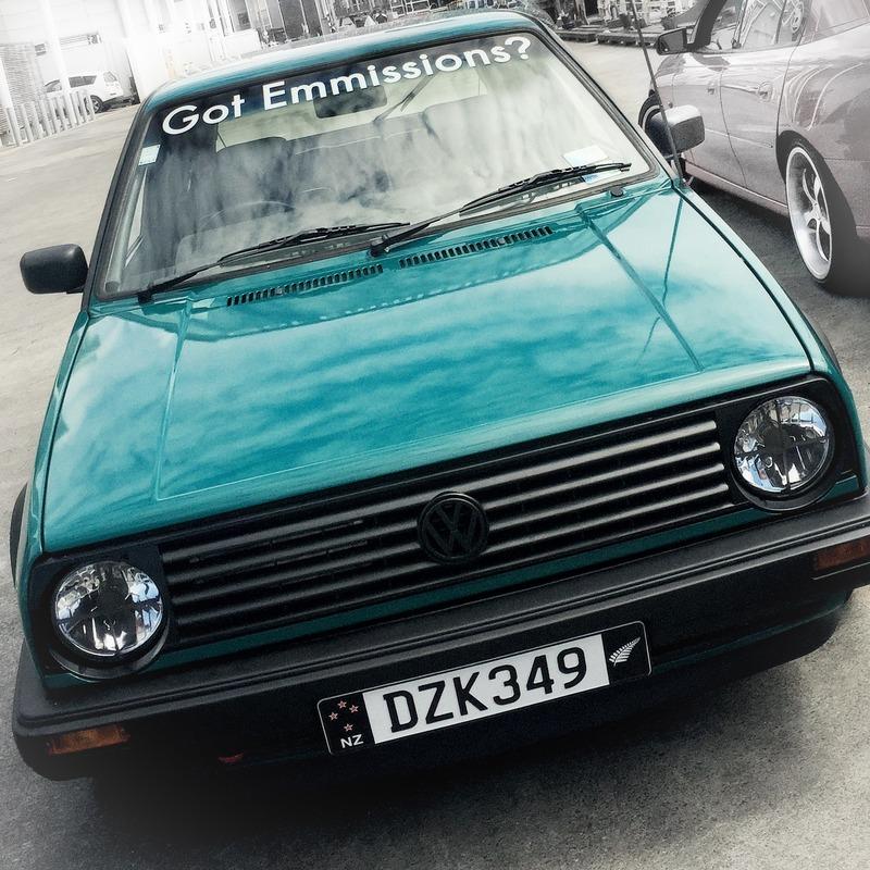

The Story begins here... on the 10th of July 2015

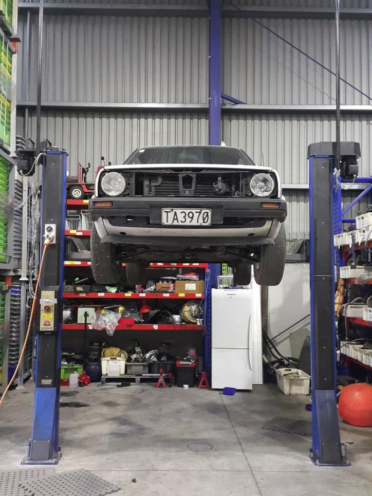

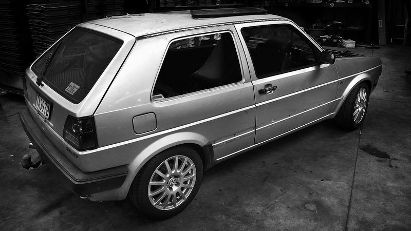

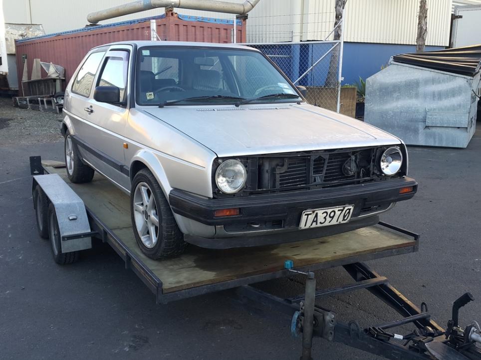

So I picked up this MK2 Diesel several months ago.
The specs.
- 3 Door, no sunroof.
- 1.6 Litre Diesel manual
- 240,000km on the body.
- The body itself is pretty mint, but the paint is ****

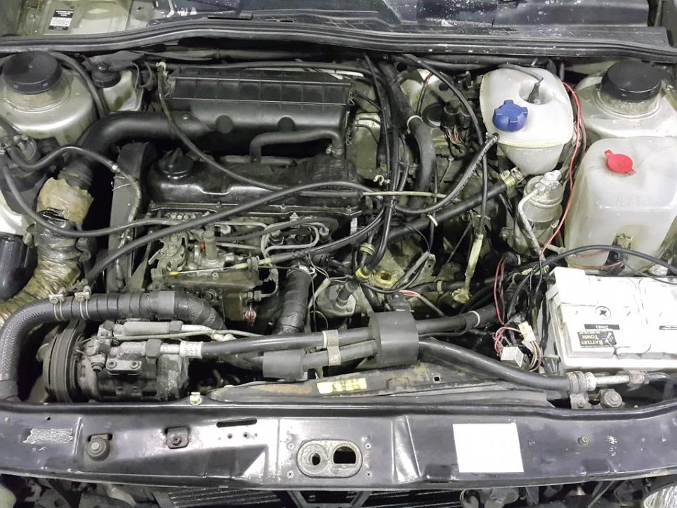

The existing motor is pretty well shot now.
It looks as thou someone has rolled paint on the roof and bonnet at some point in its life.

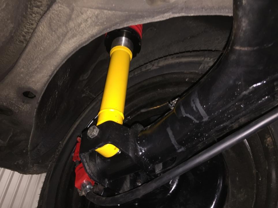

Wide track suspension with 5 Stud conversion
Bigger brakes
Coilovers etc

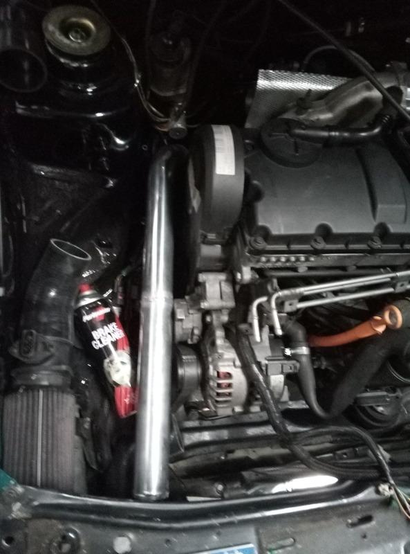

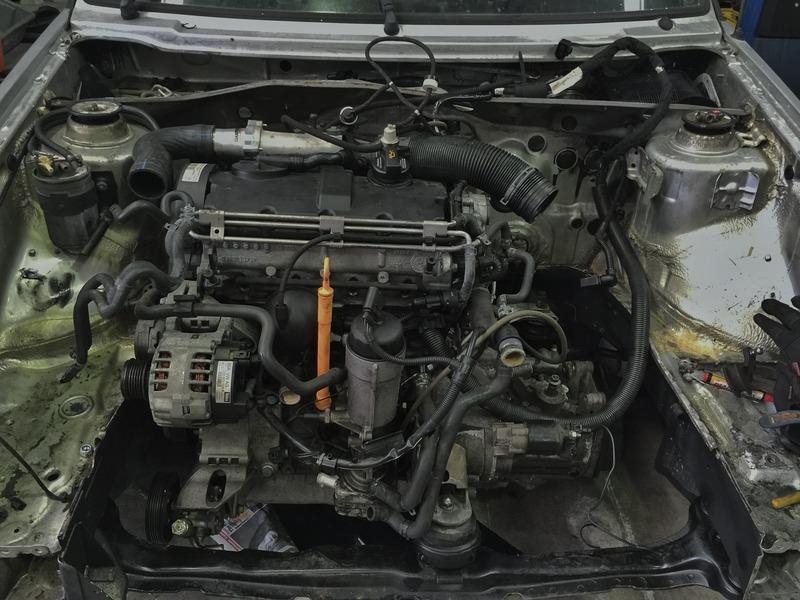

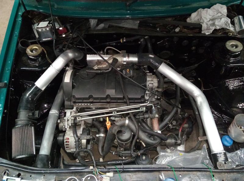

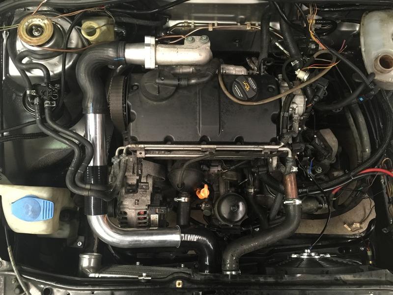

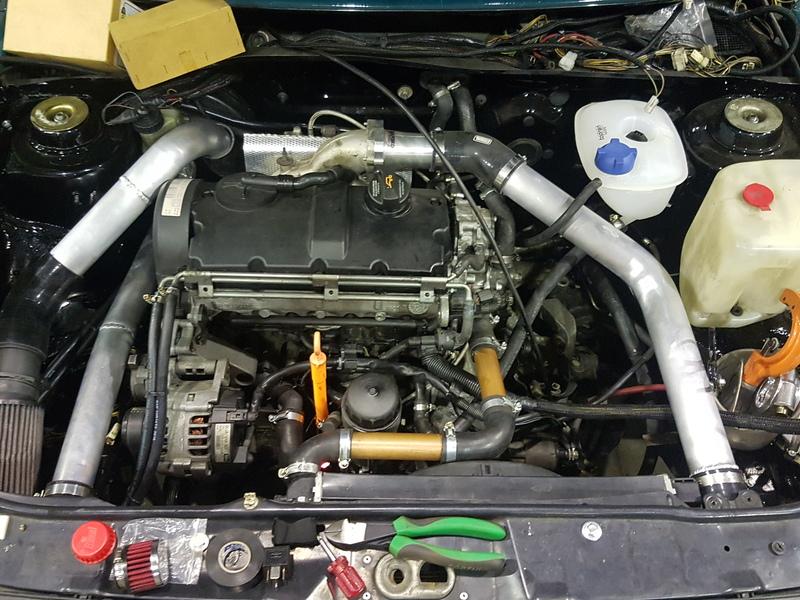

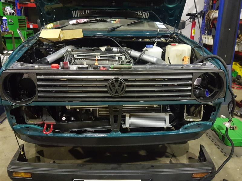

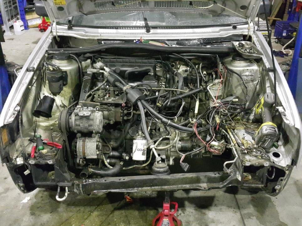

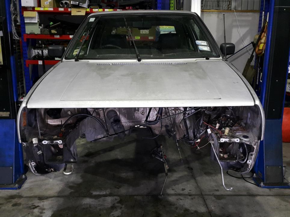

The engine bay as it is currently.

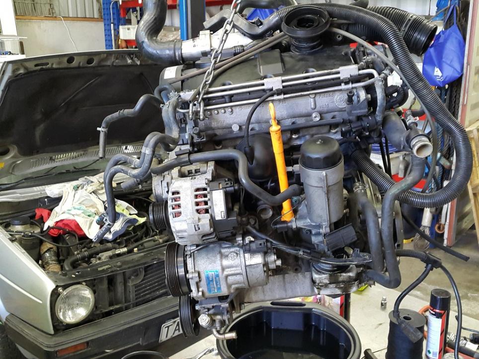

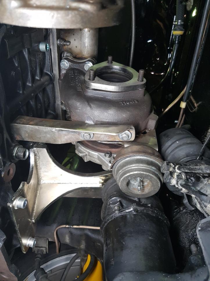

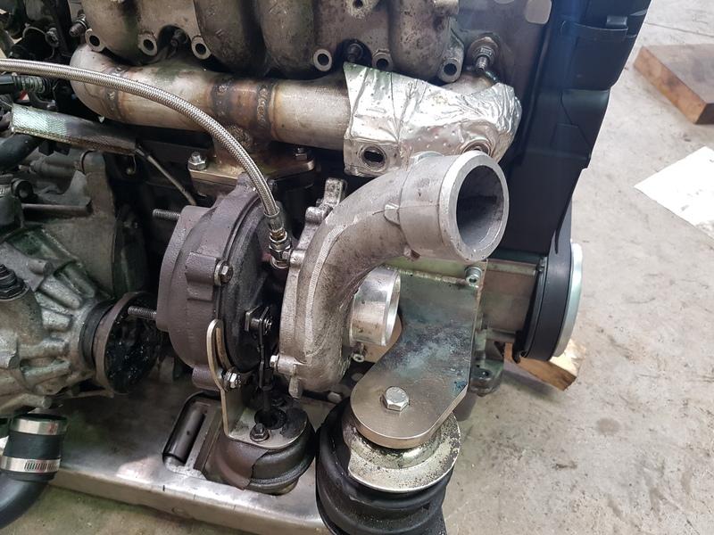

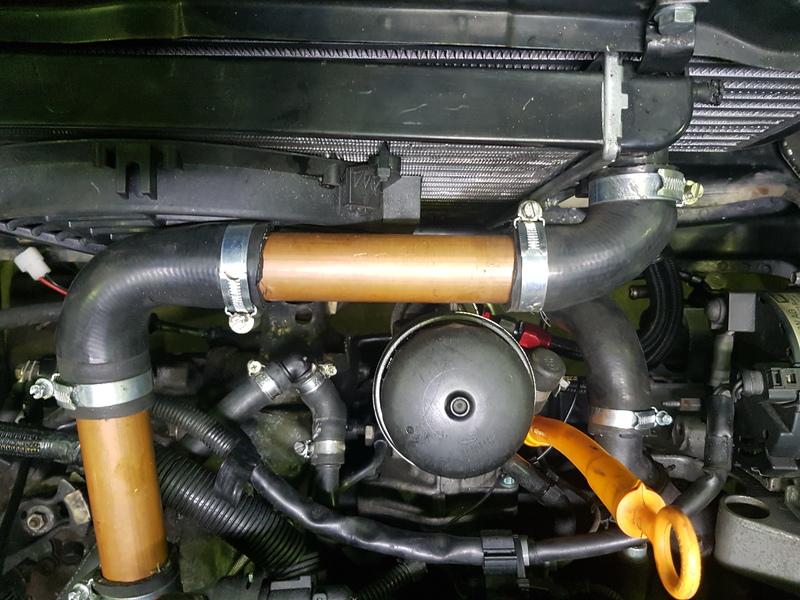

Re shimmed and re assembled the transmission and did a few odd jobs on the donor engine today.

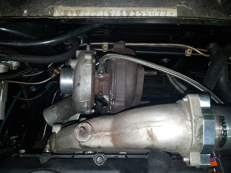

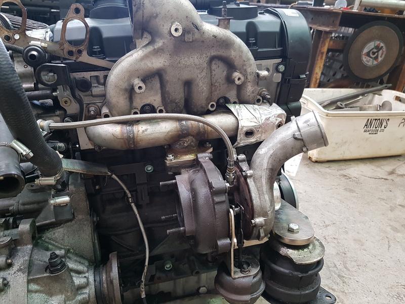

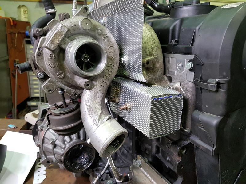

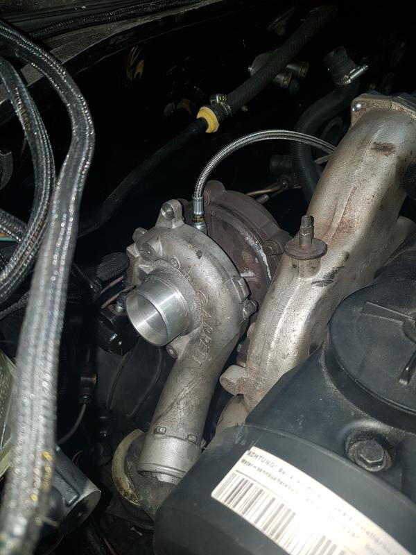

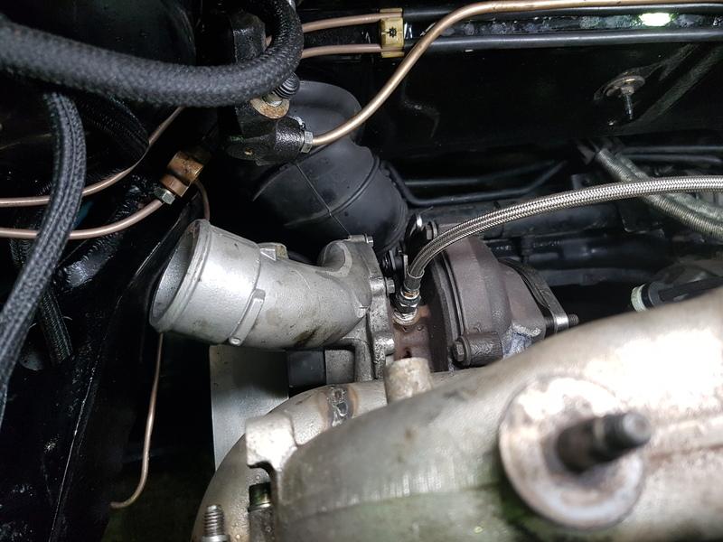

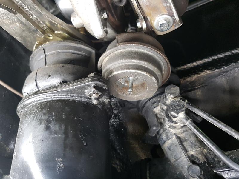

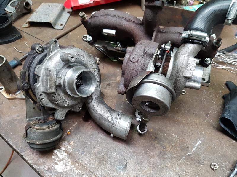

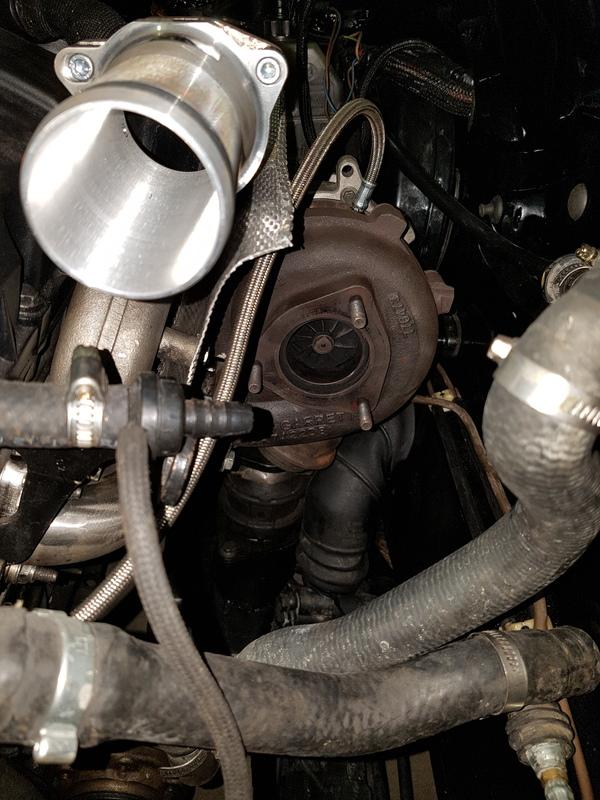

1. Clocked around the turbo for Engine mount clearance.
The turbo itself is very small but it will do for now.
2. installed the rear engine mount to suit the MK2 Platform
3. Deleted EGR and started eliminating some of the unneeded functions (anti shudder valve etc)

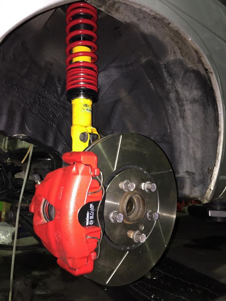

Also yesterday I got my new Brake discs back from being Slotted

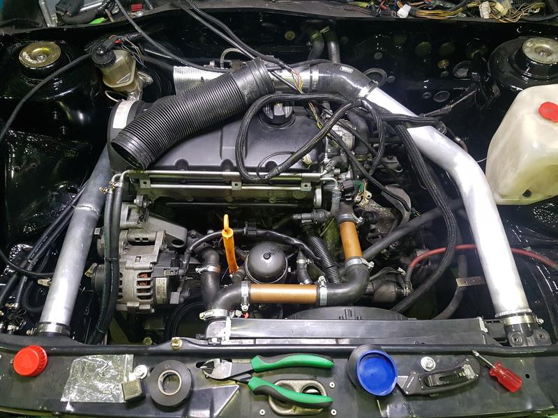

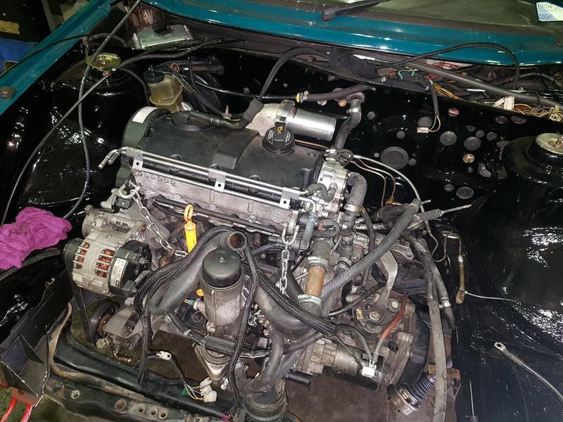

The new 1.9TDI Unit Injector engine.
Got my discs back from being Slotted also.

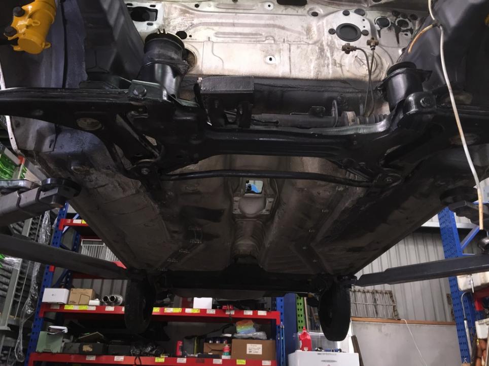

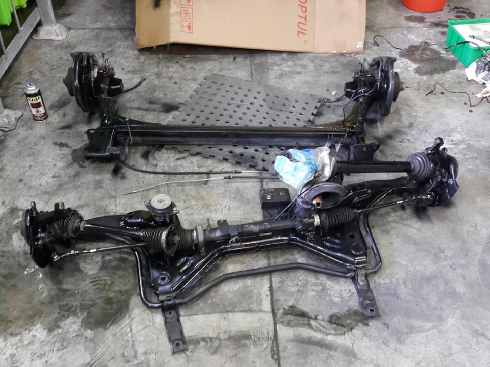

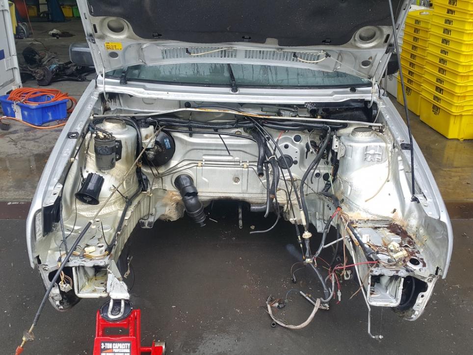

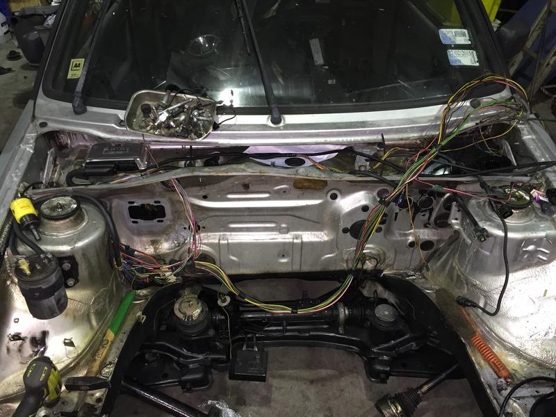

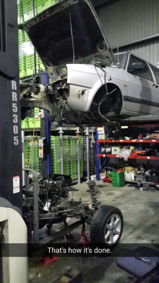

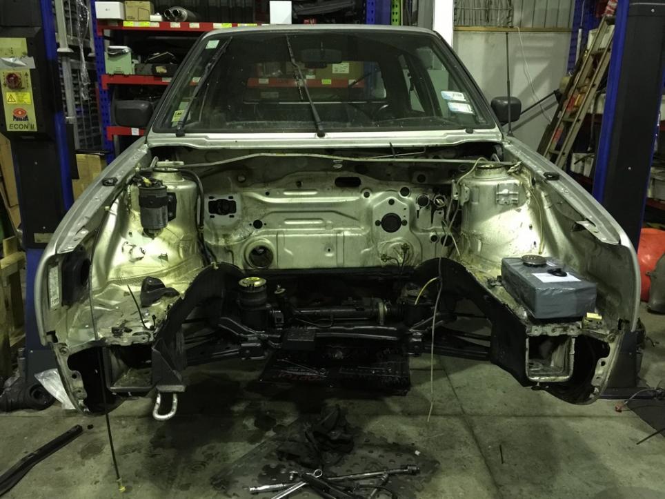

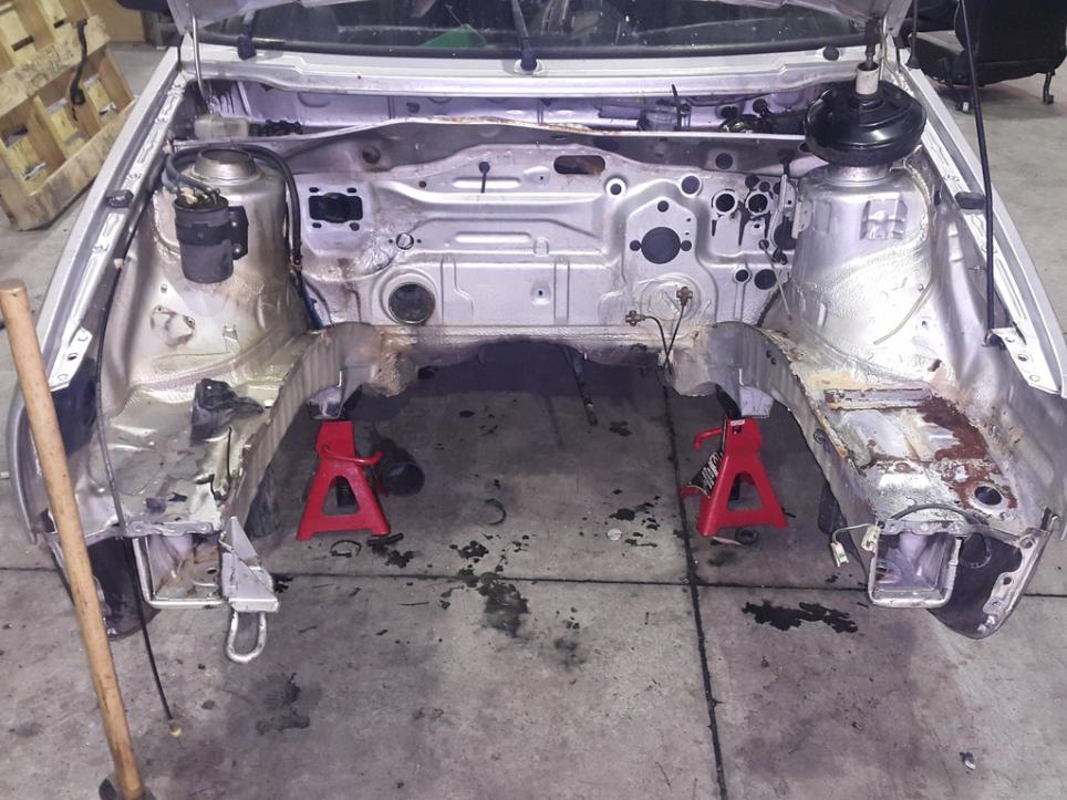

Today after work the front came off & the engine, subframe and suspension all came out.
That was that for the night.
- Next job get the new suspension up and mounted and the body rolling again.

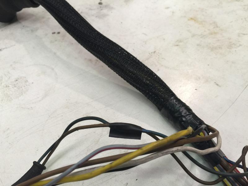

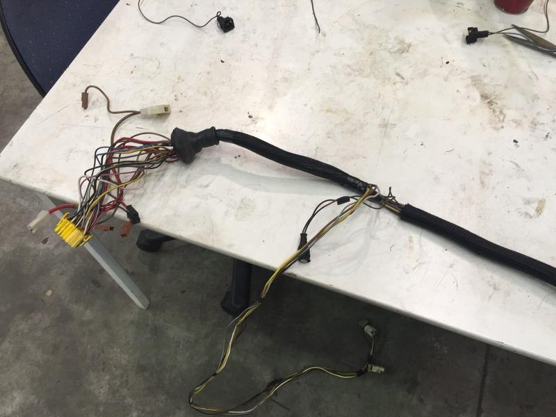

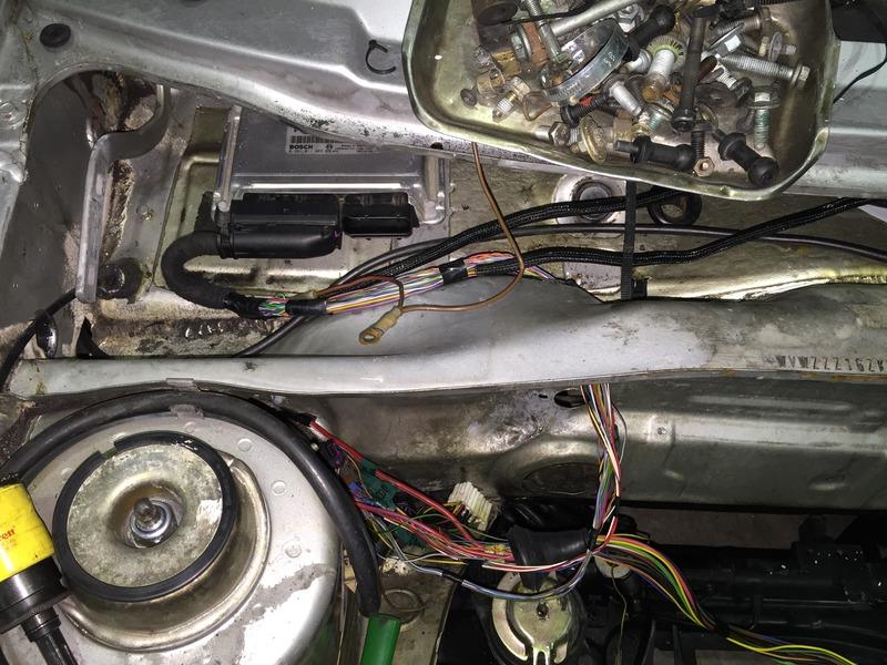

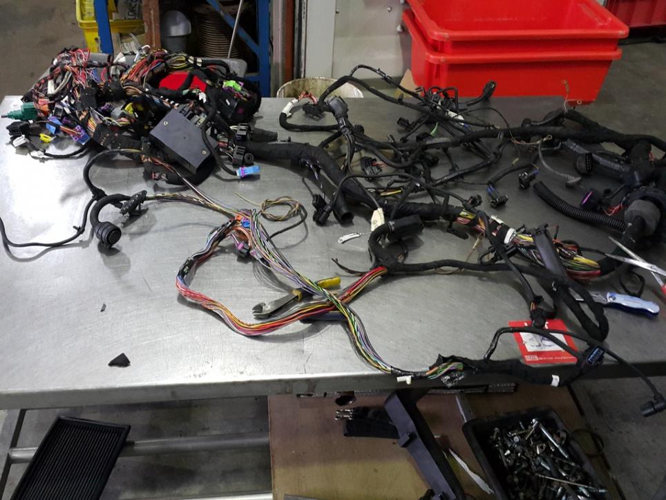

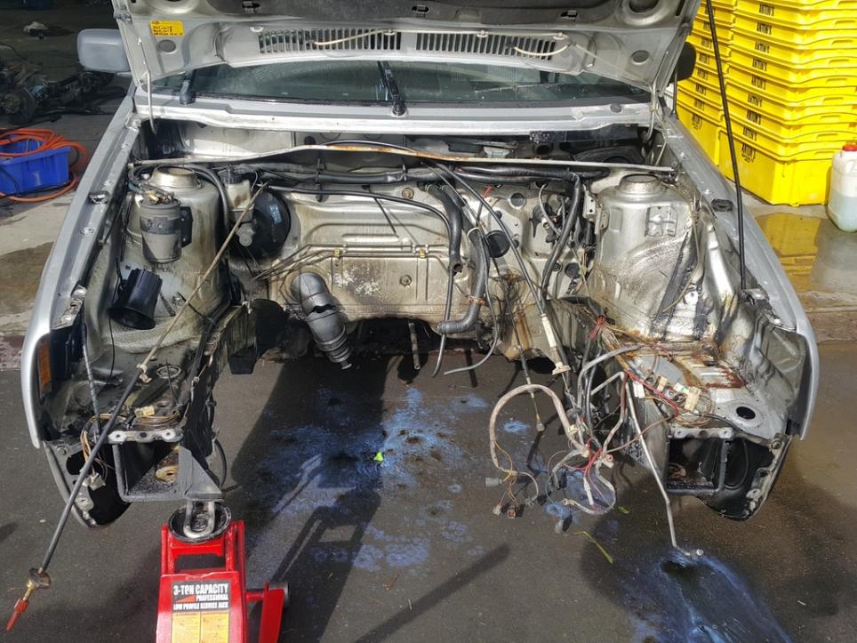

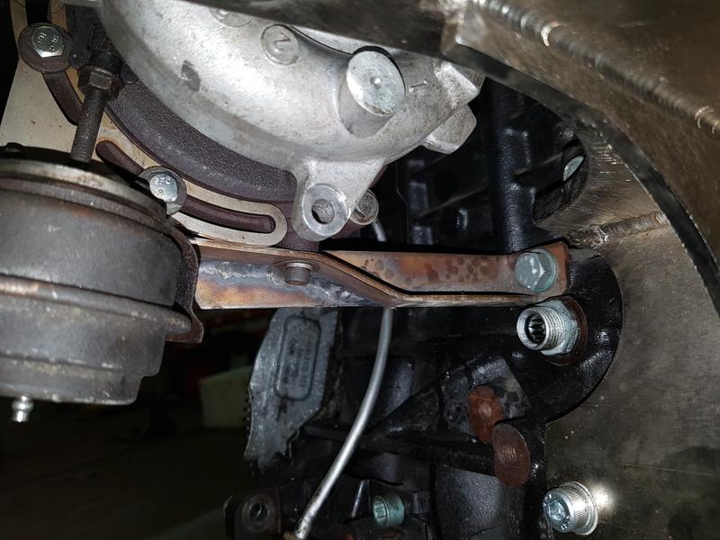

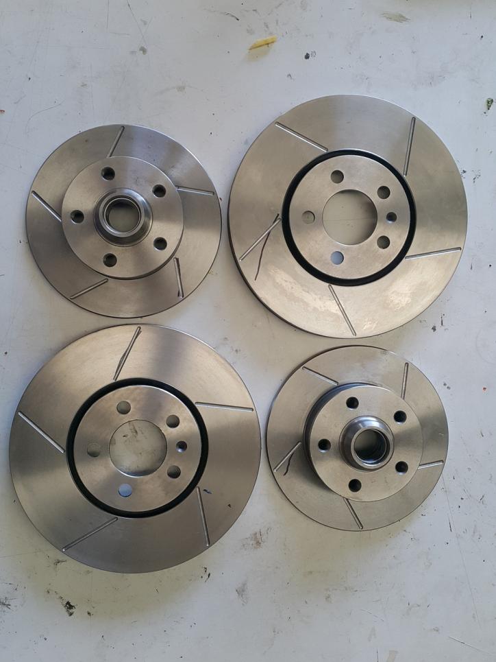

- Strip out dash and ****ty factory wiring and begin the splicing and re-looming of the car.
