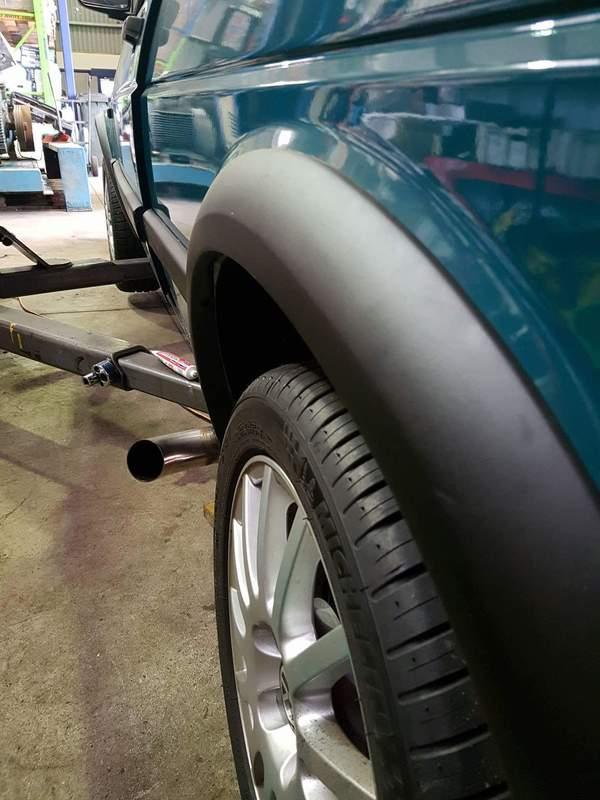

            I made the Side exit exhaust which takes a few minutes to swap between one exhaust and the other. using a V band clamp.
            also heat wrapped the lower section of the down pipe, to protect the CV Joint. and surrounding tunnel area.
            Need to make some additional heat shielding to protect the Brake Hard lines from Turbo heat-soak.
            Going to do some Data logging today... to get the tuning underway.

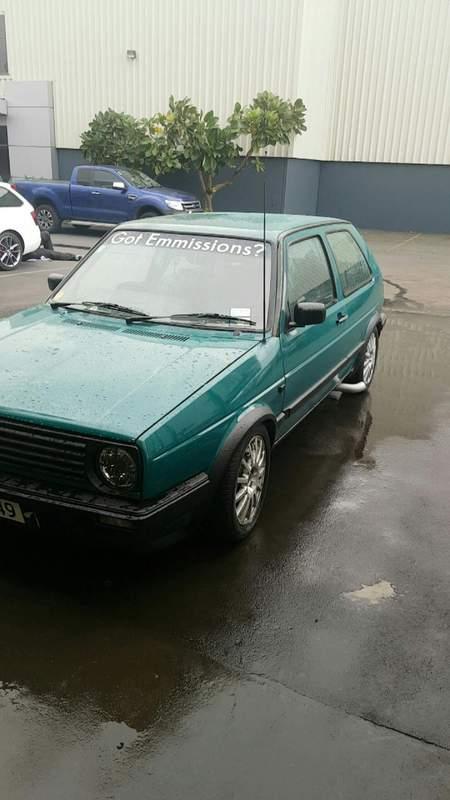

                    She is now Legitimately Road Legal (Certified) and has made an appearance at a few local drag meets
                    Its invoked a few different emotions from various people, but mostly has been received positively by most people..
                    I was told a range of things like my car had ****ed piston rings, and/or that something was wrong with it.
                    at Night Speed Drag wars, I only managed two runs before the weather packed in and my top radiator hose blew (my fault for re using old VW hoses)
                    Installed some LED Strips just for the LOLs
                    Video from the Nightwars
                    first Run was a 14.3 @ 108mph
                    Second run was 13.7 @ 106.8mph
