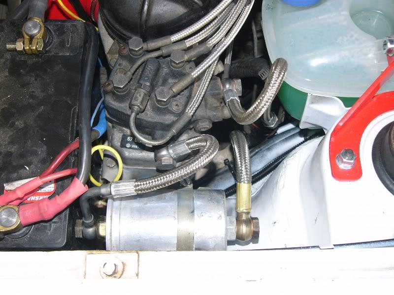

        3 New hoses made up and installed. One of the original ones had been crushed, I could only see it when we cut the sheath off at ENZED. There's a new fuel filter arriving in the mail this week.

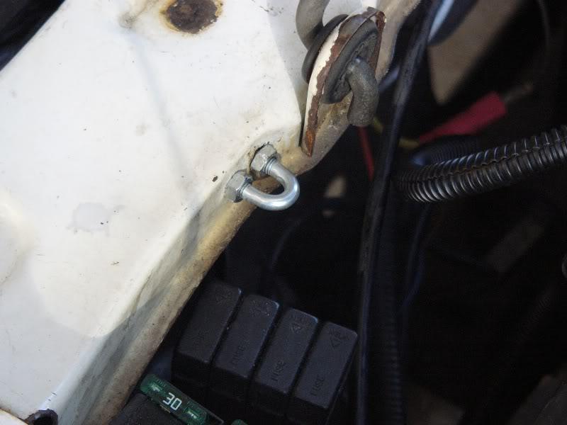

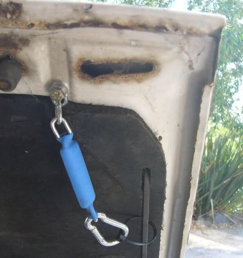

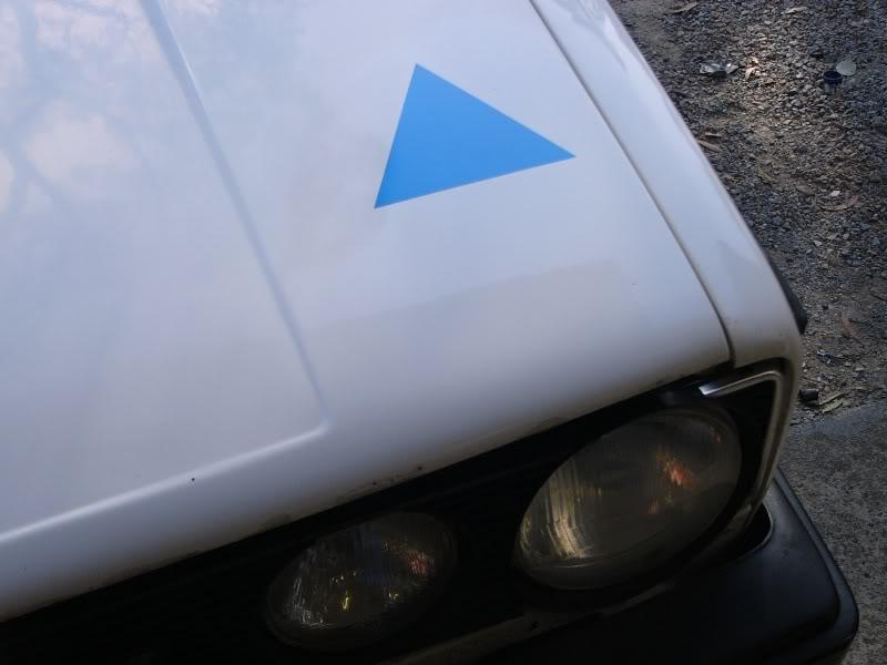

        My solution to the "Supplimentary bonnet restraints"

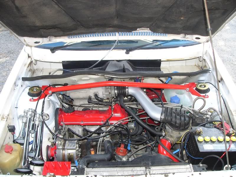

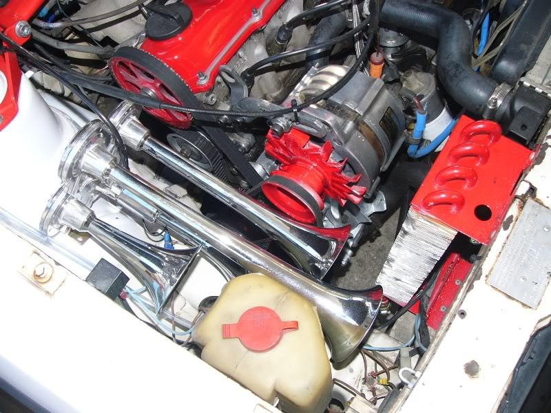

        Gratuitous engine bay shot.

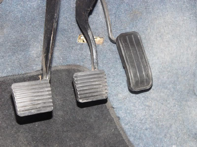

        New pedal rubbers just for the hell of it really, they were only a few dollars each along with some other stuff I ordered.

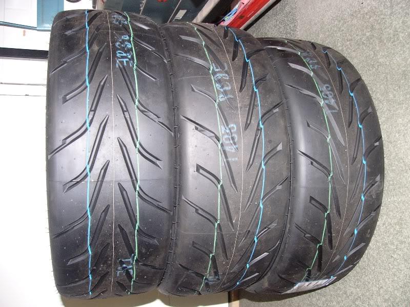

          Toyo Proxes R888 GG 185/60/14 $213ea from Meridian Motorsport.
          I know it's an indulgence and breaks away from the conservative build model, but the way I figure it they're probably the most important part of the car.
          In any case $213 for a semi slick is a bargain when those MK5 and Polo drivers are paying double that for street tyres.
          And yes they do stick like sh:t to a blanket and I haven't even got them up to temp yet.

            Were you planning on removing the horns for the track days, or just keep them in for kicks?? lol
            What have you done with the bonnet restraints. Does the shackle just hook onto the "U" bolt there? Is that what you've done?
            • #96
              Excellent Pete.
              I'll take the horns out for track days. They run off a big air tank in the boot which I can't be bothered anchoring down properly (and it weighs a bit too) so I'll pull the lot out and pop a conventional horn in there.
              The chains clip onto the U bolts. Theres one on each side of the engine bay. Once they're clipped on you can only open the bonnet about 4 inches which is just enough to be able to reach in and unclip them. Should do the trick.

                    Those tyres look very nice. Quick question, why didn't you go to something like a 205/55R14?
                    Much bigger foot print for $20 more a tyre.

                    Useless info, but the standard pedal rubber's can become very slippery with only alittle bit of moisture.
                    I removed my clutch & brake pedal rubber's & fitted some racing pedal's, grinded them flat & Arildited some low grit (can't remember what grade but was very rough) sand paper on to the pedal's.
                    No more feet slipping off the pedal's. Ever!
                        I think these will suffice. I wanted an all round tyre that could be driven to events if I had to. I have 195s on my other car and it's a PITA with tyre scrub. On the track I didn't want to have tyres anywhere near the bodywork. There's still scope with these to push the rears out by 10mm each side. I also had a look at what other people were running on Golfs, this was a pretty popular size. It's also the cheapest tyre in the R888 range for some reason.
                        They're a good place to start from for my first set of race tyres.
                        Good solution! I'm trying to work out what to do with my pedals. I've got a nasty habit of leaving my left foot on the clutch pedal which can lead to me riding the clutch out of corners. Ideally I'd like a foot rest to brace against but my foot is a bit wide too fit between the clutch and the console. More thought required but I thought I'd start off with the standard setup and develop from there.
                        Nice engine bay by the way. Is that a factory K-Jet install?

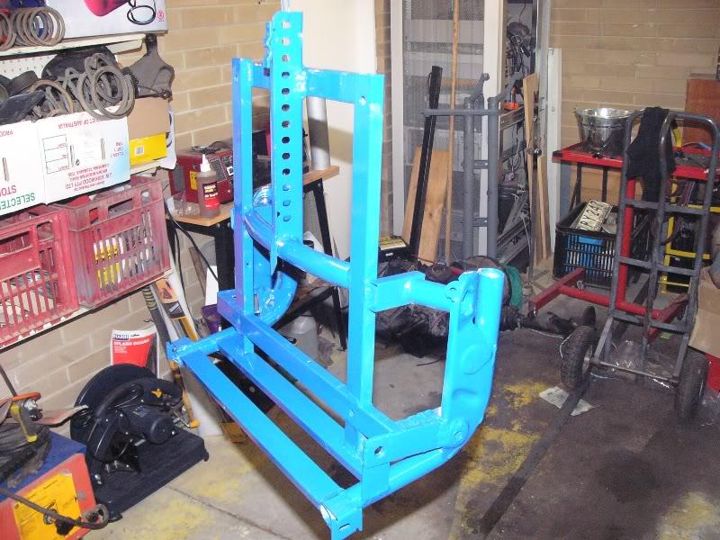

                        • I made up the seat frame today - what a PITA!
                          I was working with one I'd started on and one I bought from an ex racer.
                          I bolted up the purchased one but it made the seat too high in the cabin so I used it as a reference to take measurements from and went back to modifying my first attempt.
                          It's really hard to get a race seat low enough over the standard mounts.
                          My goal was to use the original mounting system in the car to avoid engineering issues. I also wanted to be able to mount a stock seat belt buckle so I could have both a harness and a street legal seat belt in there.
                          I tacked the frame together , bolted it to the seat and tried it out... over and over again! I must have pulled it apart 3 or 4 times before I was happy with the driver position.
                          My biggest difficulty arises because I'm 6'2" tall and the helmet adds about another 3". The first seat mount had me pinned to the roof. You can get the back mounts lower than the front but that tilts the seat backwards. I eventually found a reasonable position after a lot of re-designs.
                          Here's the frame, it's blue to match the seat. massively over engineered no doubt, but I don't want to fall out mid corner.
                          I'll pop up a pic of the seat in the car when the paint is dry and I've purchased the correct bolts.

                          • Originally posted by Peter Jones View Post
                            Nice work as usual Pete.
                            Yes that's the engine bay in my once pristine GTI. But my new car should look the same, except I'm hiding as much of the wiring as possible, the ign. coil, The brake pipe's etc.
                            There a crappy/messy looking engine bay IMHO & there's an old saying. "You cant polish a turd, but you can try!"

                              • Nice strong bit of overengineering there Pete
                                Its never gonna break.
