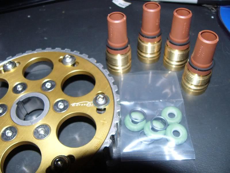

          • Another parcel from GermanAutoParts!
            I should have enough bits now to get it running again over the long weekend.

            • Originally posted by Peter Jones View Post

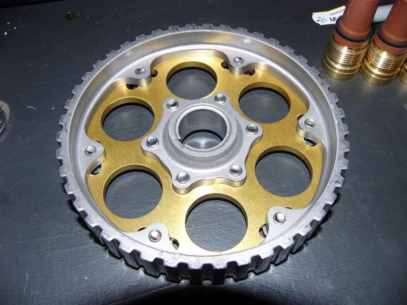

              Nice 8v cam timing sprocket. I made my own instead of buying one.
              Good stuff pete, hope you get it humming again soon!
                My simple machining skills aren't quite up to that yet.
                This one is pretty neat but seems a bit heavy @ 528 grams
                It's a standard sprocket with the spokes milled out and the new center fitted.
                Here's the flip side FYI.

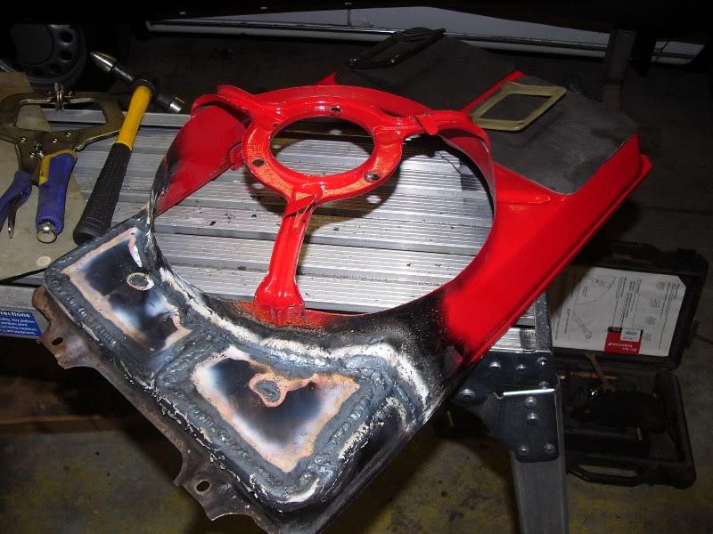

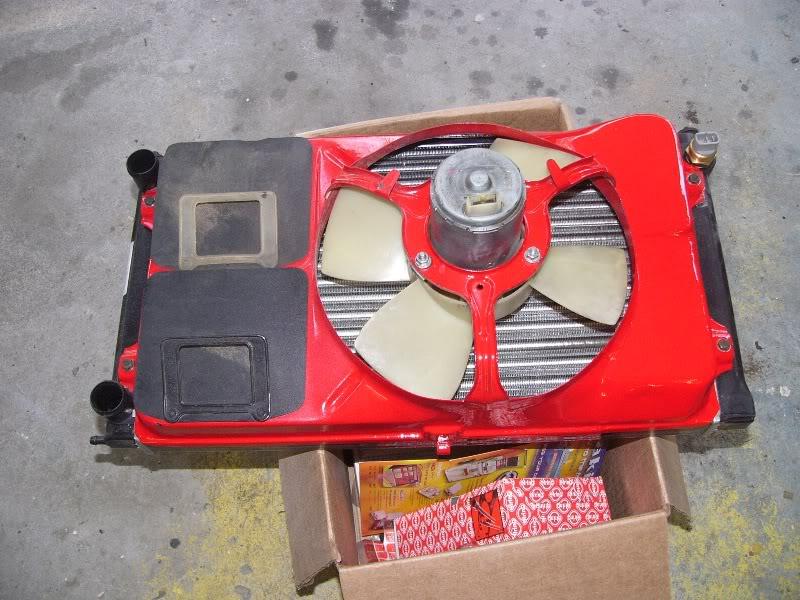

                • Things took a bit of a detour when i was putting everything back together yesterday. The new radiator I bought turns out to be a Mk 2 one.
                  Well fair enough I figure it is a MK 2 motor after all, so I set about making it fit.
                  The mounting holes were easy, the studs line up with a couple of captive nuts that weren't used, so I drilled them out.
                  Thhe bigger problem was that I didn't realise that a MK 2 radiator is about 2 inches wider than a MK 1 radiator.
                  Ladies and Gentlemen I give you the MK 1.5 Fan housing!

                  • Great stuff Nice choice with the Eurospec gear - they make really tidy gizmos
                    • That fan shroud is pretty neat Pete. VW Just used a bit of mecanno to stretch out to the boltholes. Yours will probably cool more.
                      • Originally posted by Golf Loon View Post
                        Yeah, I considered doing that too, but I'd just filled the oxy bottles and I had a spare fan housing lying about.......
                        The mecanno would just have annoyed me 'till I did some thing like this anyway.
