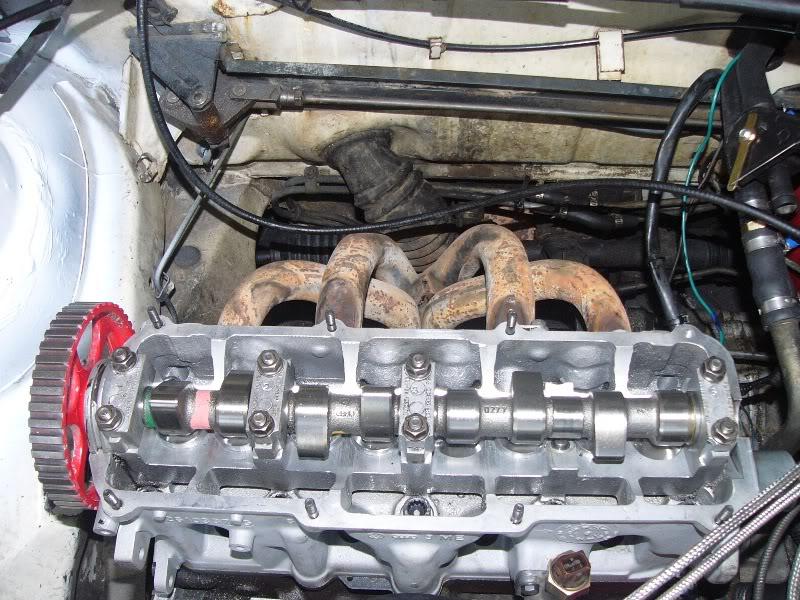

            • Slowly coming together now.
              I spent a lot of time replacing hoses while the head was off. Those ones through the fire wall were a challenge.
              All new hoses and quality clamps throughout now.
              Here's the head with the cam and new lifters installed.

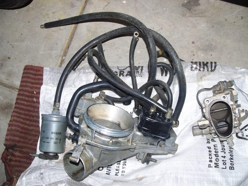

              • I went down to the metal yard yesterday to dispose of the remains of the Vento clip, I got $85 for the steel and anothe $40 for the catalytic convertor.
                My pockets freshly full of cash I popped in next door to pick a part and scored these.
                It turns out my throttle body IS already this size 52/35 Doh. Oh well now I have a spare or one to trade.
                The fuel dizzy is off a 2.3L 240 Volvo. Wasn't too hard to get out and looks to be a drop in replacement for the golf one. I grabbed the injectors, lines, and warm up reg all in one piece as well as wthe fuel filter just so i know where all the lines go.
                I'll get the car up and running again before I try this out.

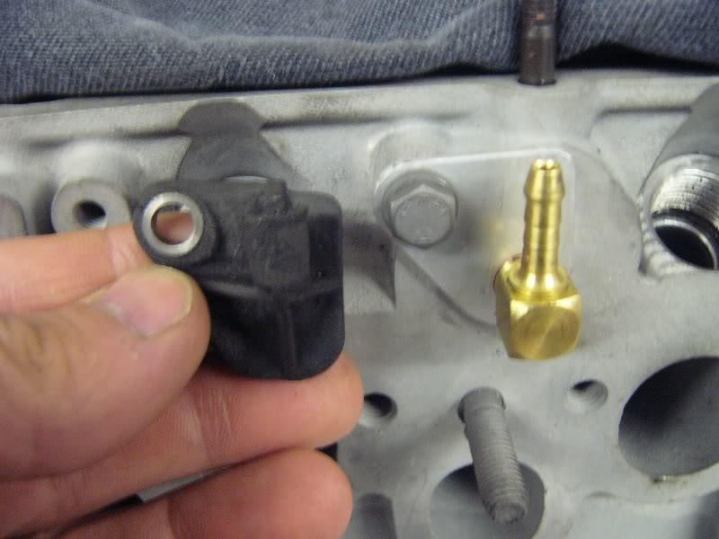

                        • We've been a bit busy the last few weeks looking after a friend whos going through a seperation so I haven't had much time to play with the Mk1.
                          Here's where it's up to at the moment.
                          Made up a new vacuum connection for the airshrouds on the injectors. I'm waiting on a delivery with the new insulators, should be here next week.

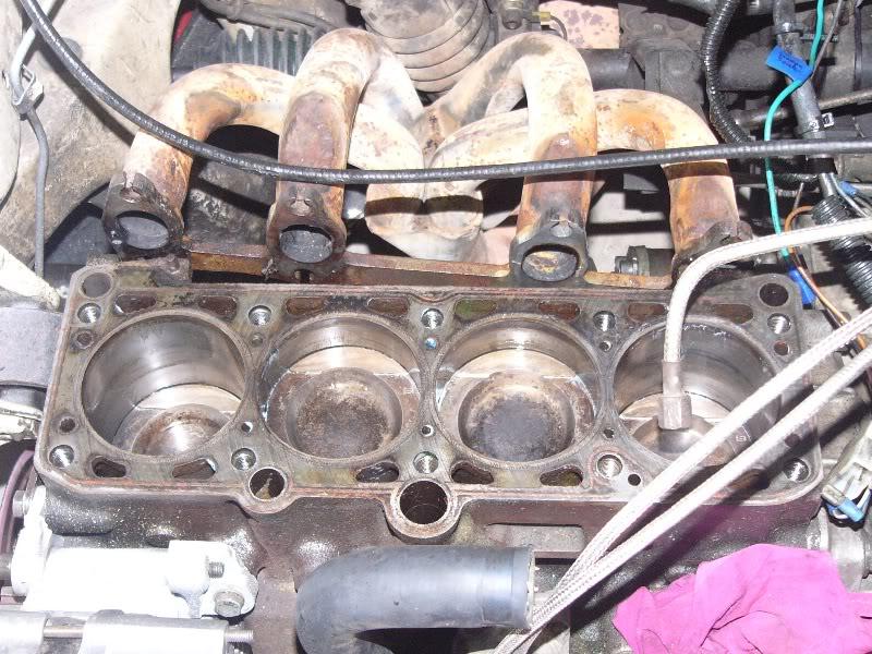

                          Here's why I never could figure out the timing, see I'm not going crazy!
                          When the mark is here,
                          The pistons are here !!
                          I guess whoever bolted up the clutch / flywheel didn't know what they were doing!
                          As it sits now,
                          Head back on, exhaust bolted up hoses re-attached. Still need to pop some assembly lube on the new cam and lifters before firing it up, its drenched in light machine oil at the moment.
                          Hopefully I'll get some work done this week and be ready for when my parcel arrives.

                                It was more the cam timing that was confusing me with the markers all out of whack. When I got it the intrmediate shaft was out of phase too which wasn't making things any clearer.
                                It's all good now though.
