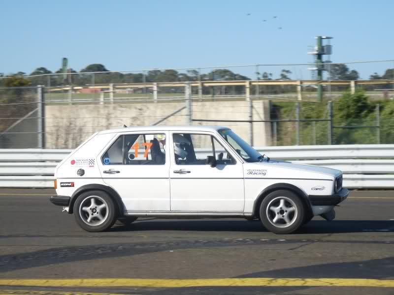

        • Here's a few photos to look at while I'm editing the video.

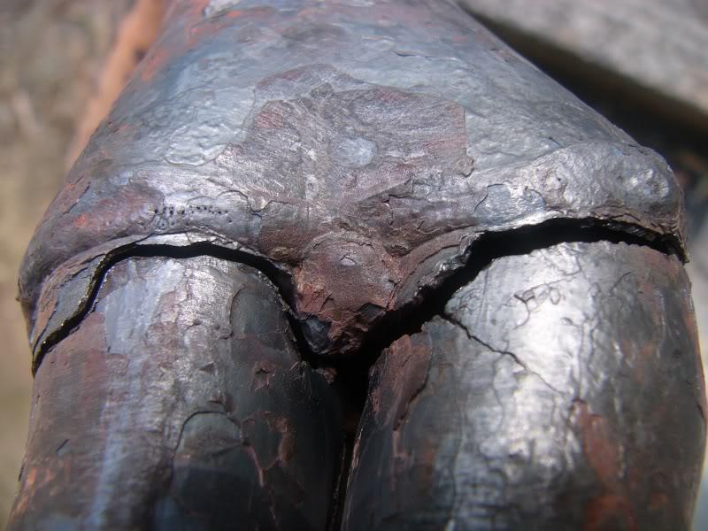

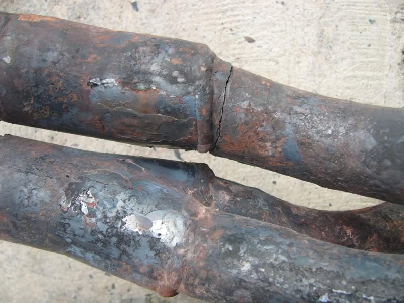

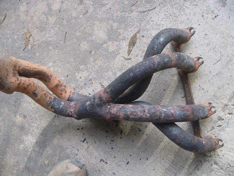

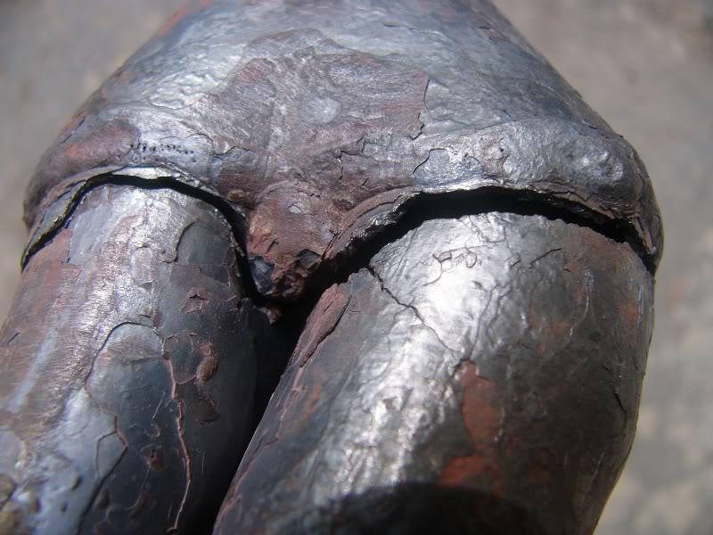

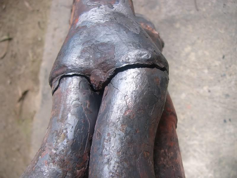

                        • Pulled the extractors out today and welded them up. Two of the pipes had come adrift at the first collector.
                          If you were wondering why heat wrapping mainfolds reduces their life, take a look at these photos.
                          Looks like some sort of annealing process going on.
                          These things would be glowing red hot during a race, they're not going to stand up to much more than another year of this I think.

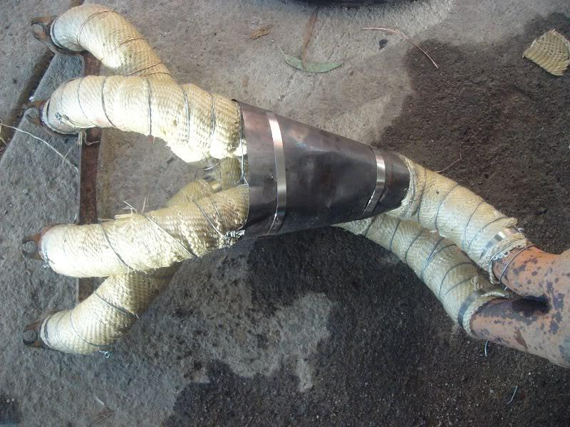

                          Re-wrapped and ready to go back in.

                          • looking good dilbert!!
                            thats some serious crackage
                            what does wrapping the exhaust manifold actually achieve?? does it keep the heat in the pipes to keep the engine cooler?:S
                            '76 Golf LS Swallowtail 4dr
                            '76 Golf Swallowtail 2dr
                            '89 Golf GTI 16V 2dr
                            • Helps with flow. Hot exhaust gas doesn't like to pass thru a cold pipe. The pipe takes away the energy and you lose gas speed. Keep the pipes hot, less energy lost= Better flow.
                                Yeah, wot he said. Am trying to keep engine bay temps down too.
