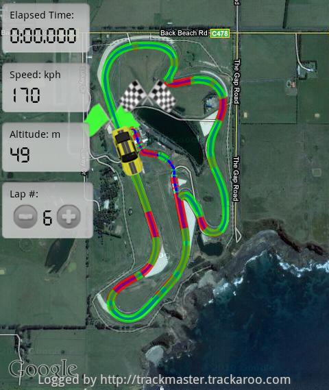

  • Here's an example of a pretty good lap.
    Green is acceleration, Red is braking and blue is coasting.
    I used to see a lot of blue on previous outings.
    Turn 1 isn't ideal on this lap but the rest of the circuit is pretty good, especially the acceleration all the way from turn 10 through to turn 1

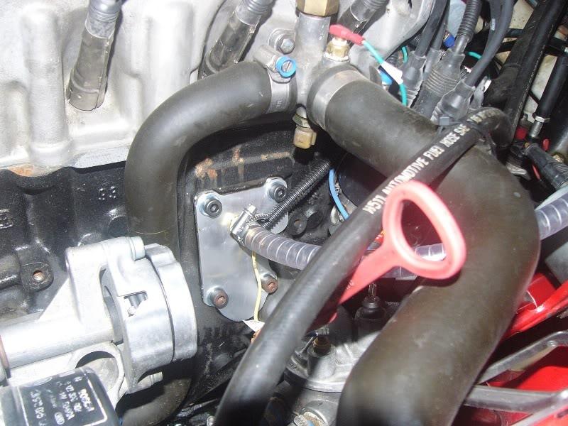

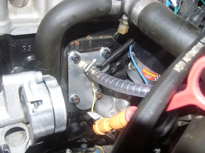

    • Last couple of races I've had a small oil leak from around the distributor. I can't really see a good reason for it other than excessive crankcase pressure.
      I'm also getting a bit of a leak from one of the pulleys too.
      I replaced the dizzy seals and added some non hardening sealant to address the obvious source.
      Than I added a breather to the plate I'd made to block off the factory breather. (Hmm, maybe should have done that when I made the plate)
      Here it is along with some new hose I picked up today.
