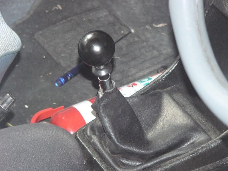

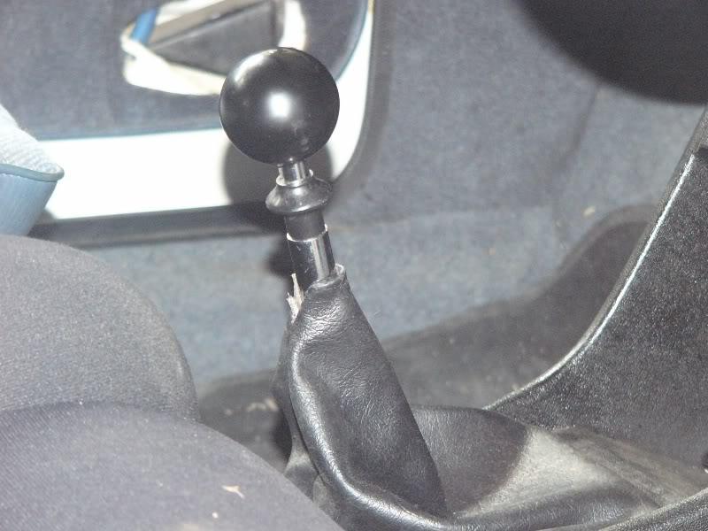

                              • All packed up now.
                                I installed my EMPI shifter, figured if I was going to stuff about adjusting the linkages I may as well.
                                Oddly I just put in and got it right on the first go Gets all 5 gears better than before. Reverse is locked out by the pull up collar.
