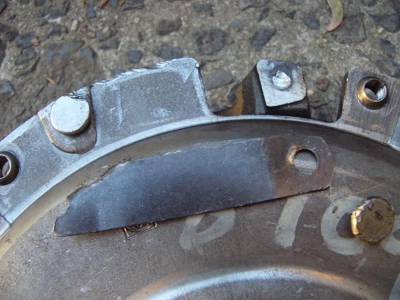

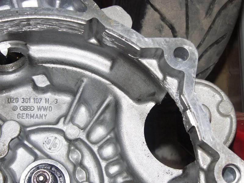

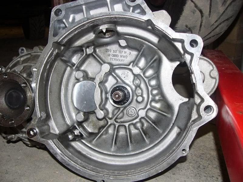

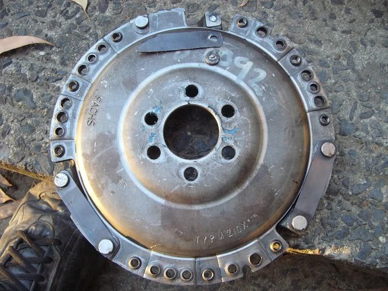

          • Box is out and even beofore I've got the clutch apart I've found bits of the pressure plate in the bell housing.
            Pics later.
            Pete
            7? MK1 Caddy
            79 B1 Passat Dasher Project
            12 Amarok
            • It's official, I've blown my first clutch!
              One of the spring plates has come off the back.
              Bit of a relief really, to have found the source of the noise.
              Now to put it all back together.
              Pete.
              7? MK1 Caddy
              12 Amarok

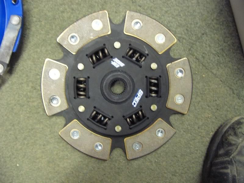

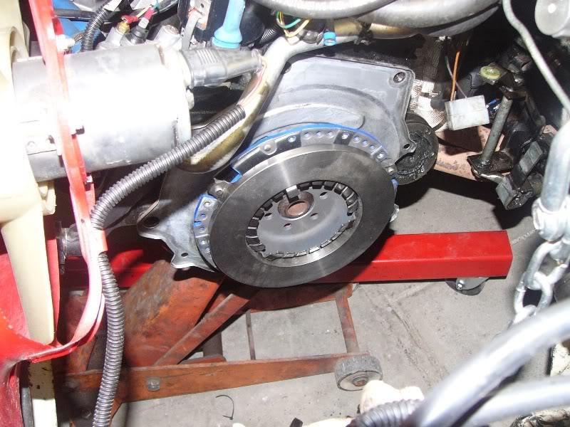

              • Box is back in re-attaching stuff now.
                I fitted the Bildon / Spec clutch - stuff it - you don't win races with your best parts on the shelf.
                http://www.specclutch.com/products . Stage 3 - 6 pucks and springs.

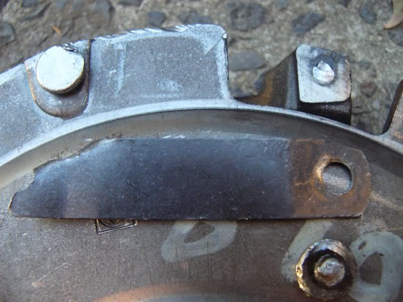

                    • Clutch carnage.
                      This was a 16v pressure plate too, should have been up to the task.

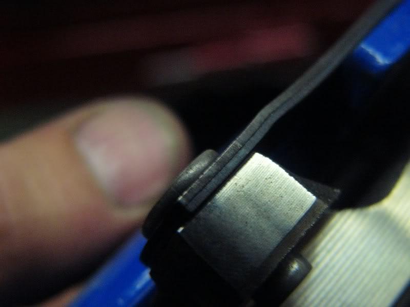

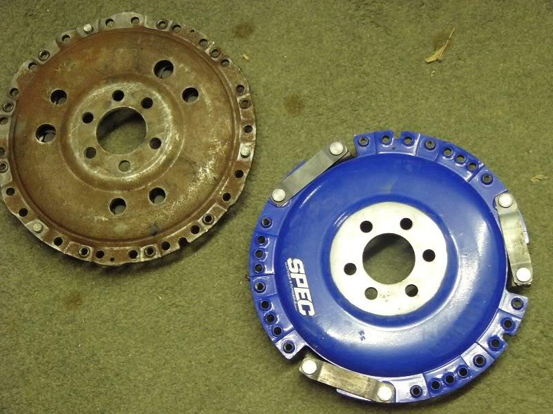

                      • New Clutch (shown next to a stock LUK pressure plate.)
                        The SPEC Unit has double springy plate thingys.
