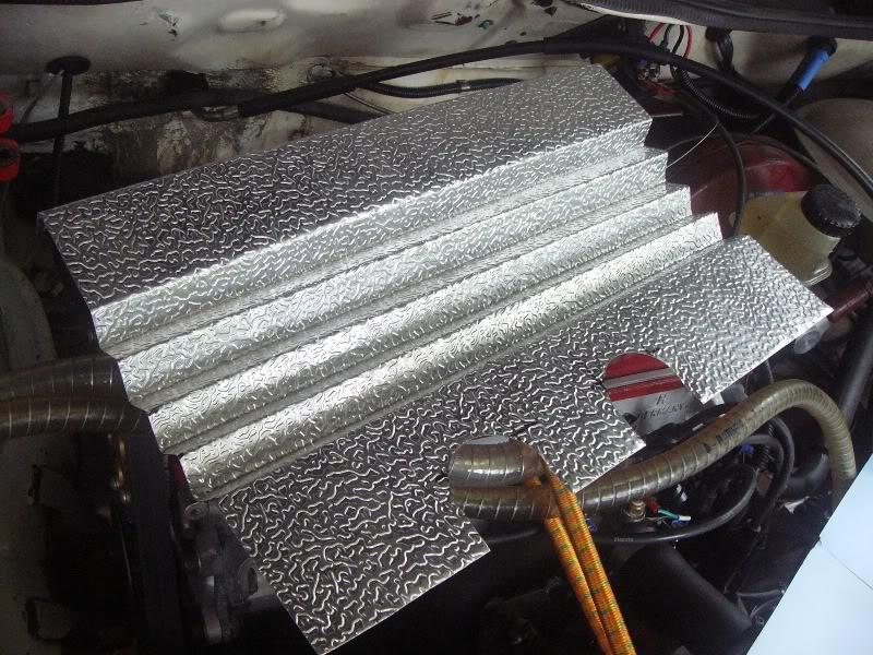

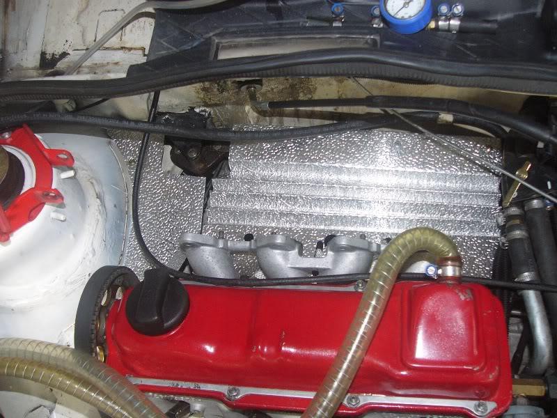

                      • Made a heat shield today.

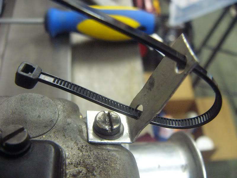

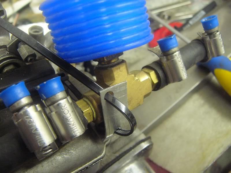

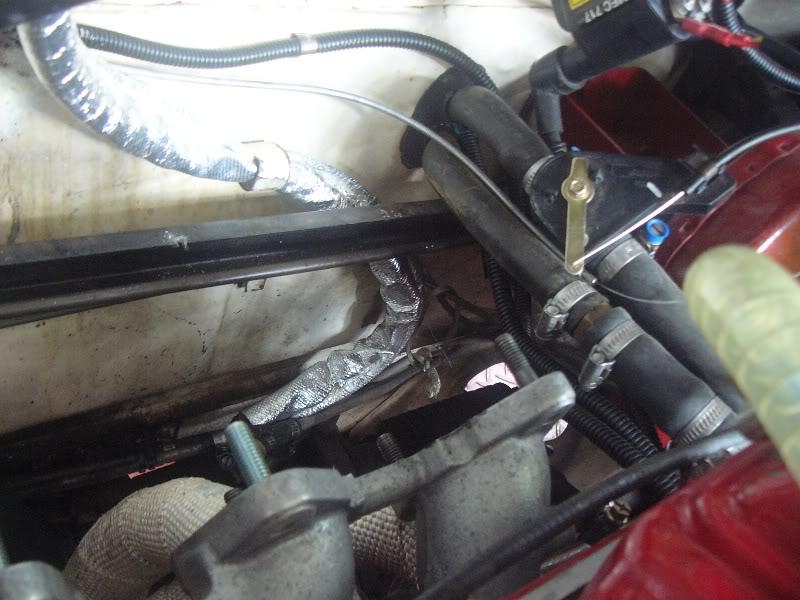

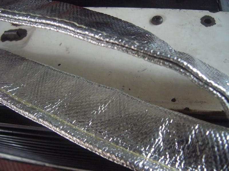

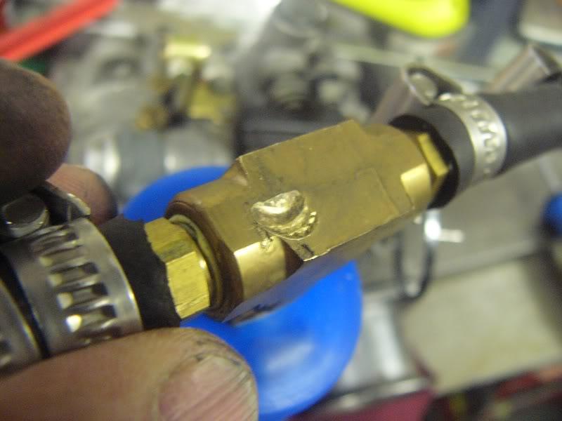

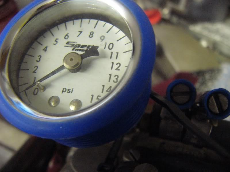

                        Racing does strange things to cars. I've lost 2 of the manifold studs on the track somewhere. The T piece for the fuel pressure gauge had undone one of the carby screws too so I had to make a little bracket to steady it.
                        To further alleviate any heat related issue I put a thermal sleeve over the fuel line.

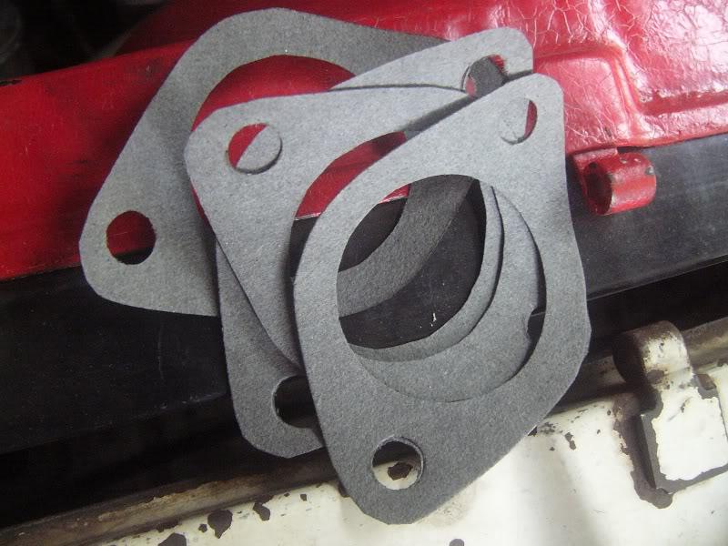

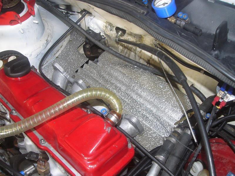

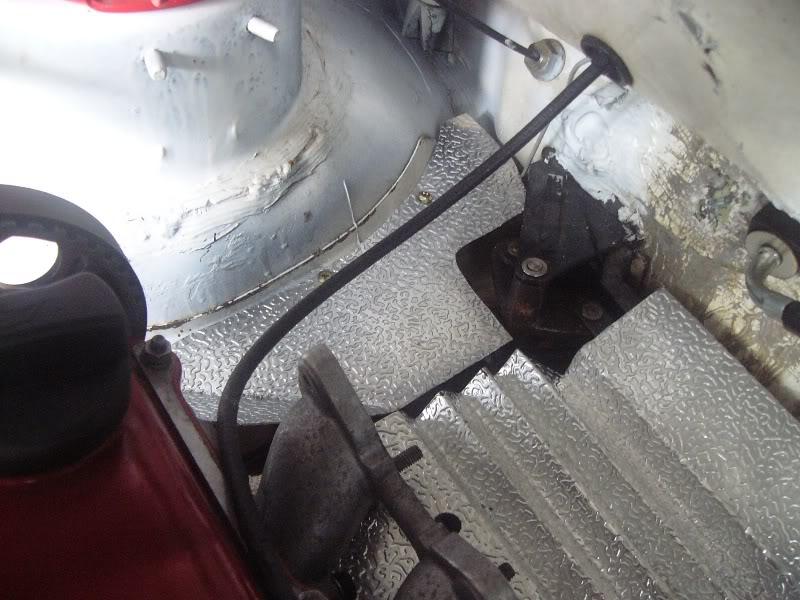

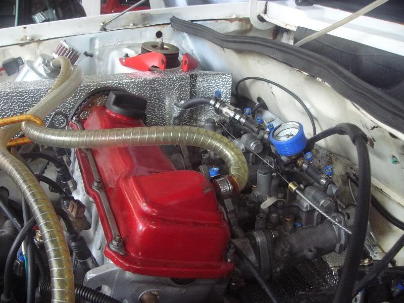

                        • Made some new gaskets.
                          Made up a duct to get some cold air blowing towards the carbys.

                          • Nice neat shield!
                            APR S2/Whiteline/H&R/Enkei/Carbonio/13.68@101/Winton-1:44.52
                            • Cool concept, Pete. I like it.
                              • Cheers guys,
                                We'll see how it goes tomorrow at Sandown.
