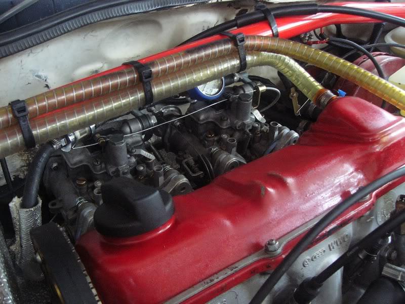

Parts arrived for the carbs.
If you're looking for small parts for Dellortos or Webers, EuroCarb in the UK provide an excellent service.
Dellorto and weber carburettors online
Only took a week to arrive.

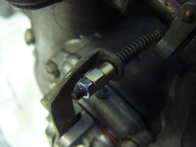

- Pump actuator rod nuts.

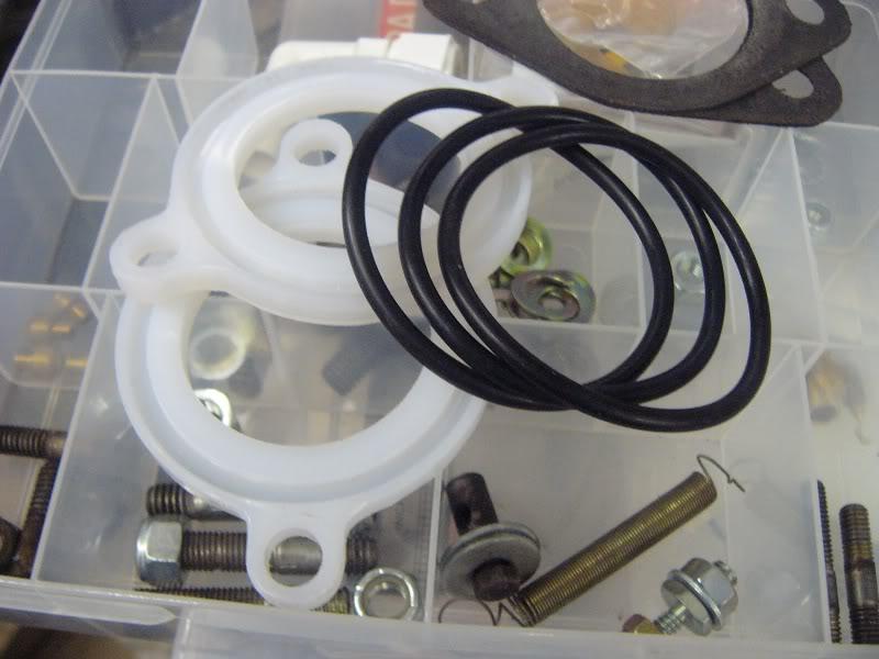

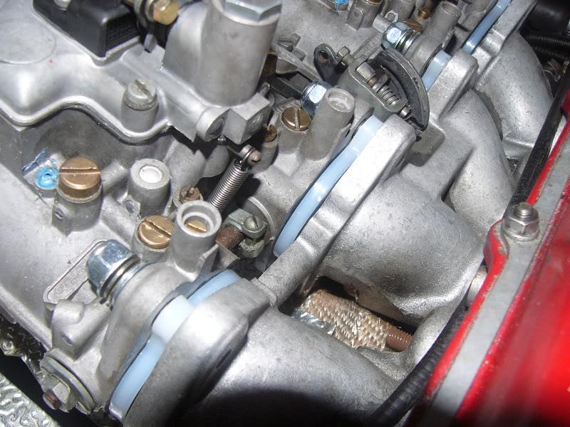

Today I installed the soft mounts and replaced the floats and needles.

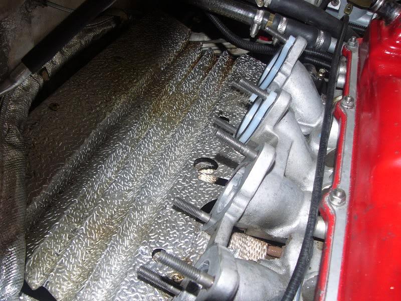

Longer studs in and loctited in place
Soft mounts, hopefully these will save the needle and seat from some vibration. Should also prevent heat soak from the manifold.
I had to order these two nuts in, the origianals rattled loose and fell out on a race track somewhere.

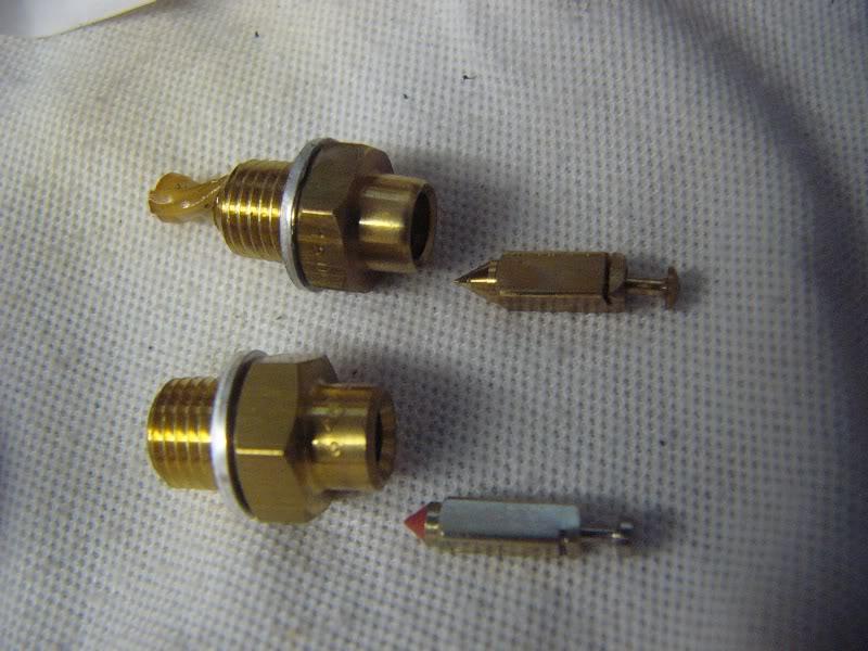

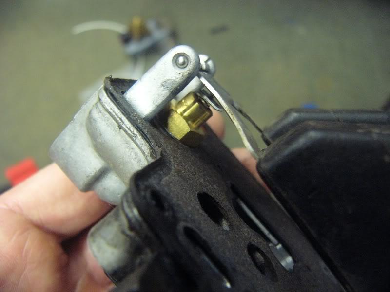

Non genuine needle and seat on the top and genuine Dellorto unit below.
Setting up float levels.

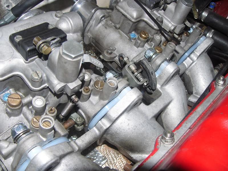

Soft mounts in place and carbs secured with thackery washers under the nylocks.
All back together again.
