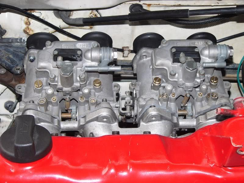

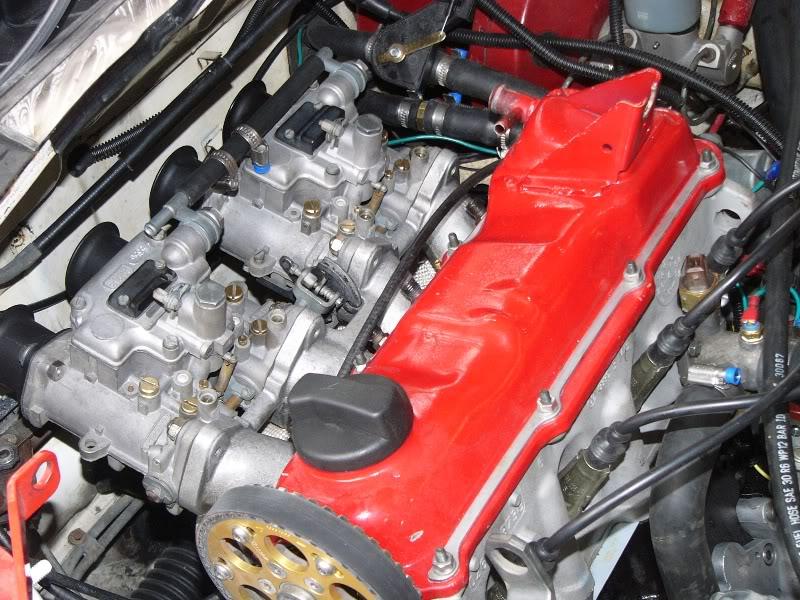

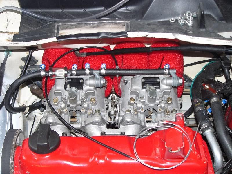

                            • Watch this!
                              Before
                              After
                              Fitting that manifold took a lot of time, whoever designed it never actually tried to intall it.
                              About 6 hours of trial fits and clearancing to make it fit.
                              I'm sort of running out of time tonight to install the fuel pump, although I'll try to do some prep work under the back of the car.
                              Still got to finish making the throttle cable. (It's a modified $2.99 Huffy universal brake cable from K-Mart.)
                              They're Dellorto DHLAs by the way. I believe they've passed through a few hands here.

                              • Delortos.. Aye?
                                Very clean, Pete. Nice and tidy. Should have a bit more top end oomph now! And sound.. Well.. Infinately better..
