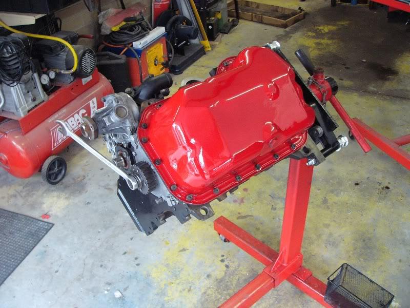

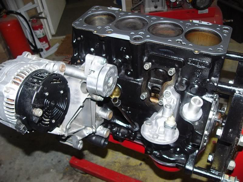

    • Still can't (shouldn't) put too much weight on the knee so I spent some time today with some of the fiddly bits and cleaning.
      Got to use my crank sproket bar again.
      New seals throughout means cleaning the crud off the surfaces so the oil seals don't chew out straight away.
      This motor looks pretty good so far, all original gaskets and not one was leaking. Mind you some of the oil seals really didn't want to come out.

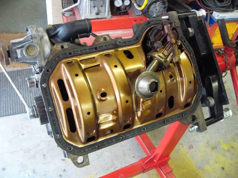

      VW Motor Sport windage tray fitted up.
      I've been missing my red spray can lately.
      The alloy parts brighten up well with a steel wire brush.
      I'll write up the specific stuff you have to do to run one of these blocks in an earlier car and post it up in the conversions section. You can see here I've partly blocked of the crankcase breather setup with a 40mm welsh plug, I've still got to make up a plate to block off the rest of it yet. You can also see the dizzy adaptor I'm making up, there's still a lot of turning to do on that one, I'm waiting on a spare 1600 dizzy for reference measurements.

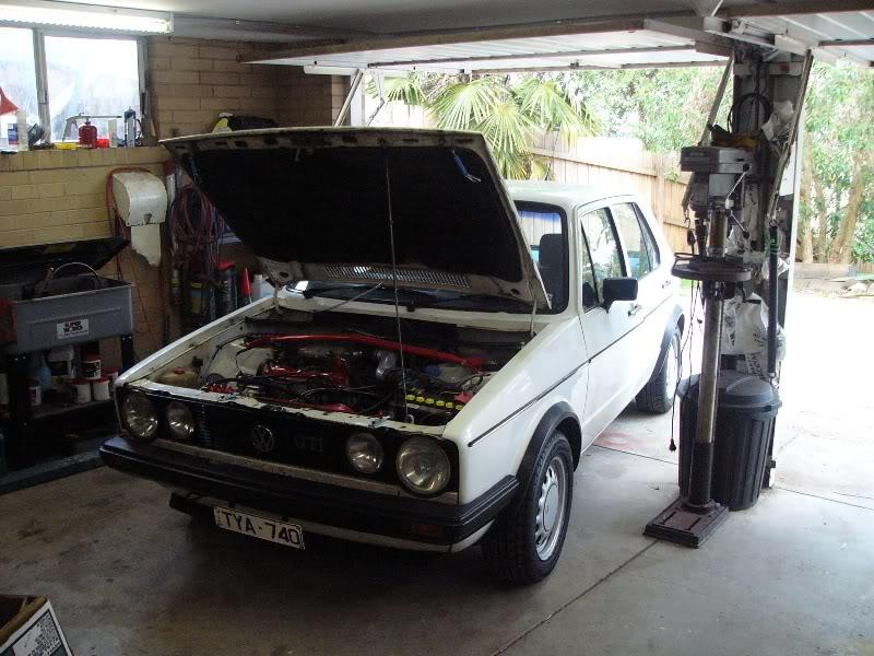

              • Motor's coming out tomorrow. I'm taking a day off to catch up on the car work . Plenty of pics to follow.
                Probably won't get the new one entirely back in tomorrrow there's a few things need doing while the engine bay is clear.

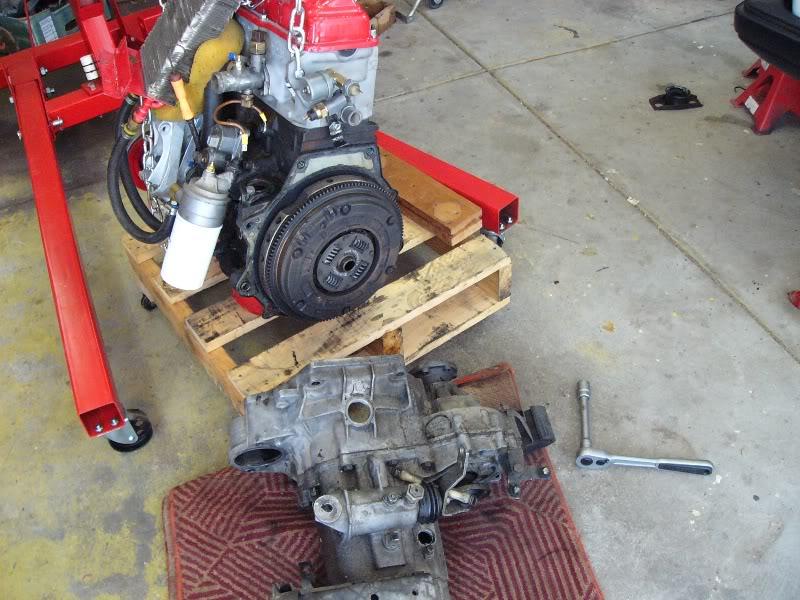

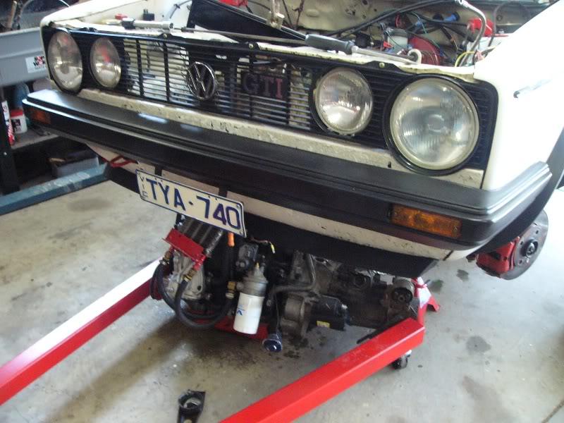

                      • Got the motor out by 12:00. Finally figured out the timing issue, some moron had bolted the flywheel to the pressure plate the wrong way! Even clamped it down on one of the dowels so it's actually buckled the pressure plate.
                        Anyone want a GX Block?
                        Pics later.

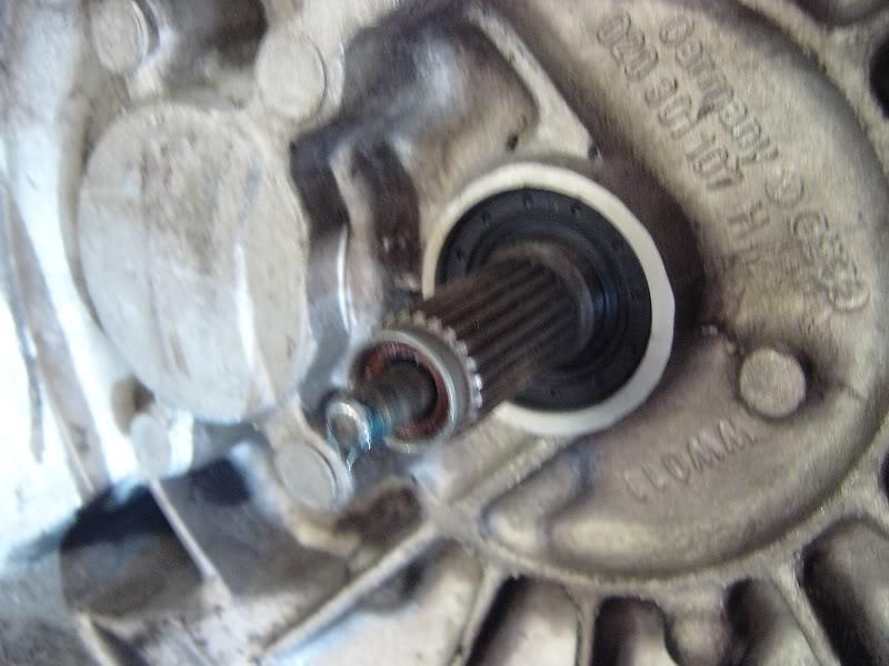

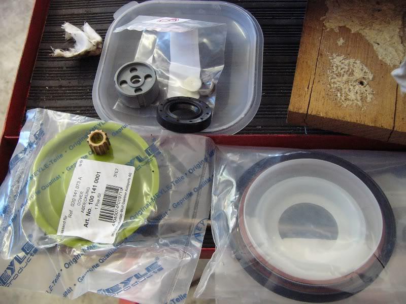

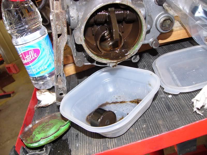

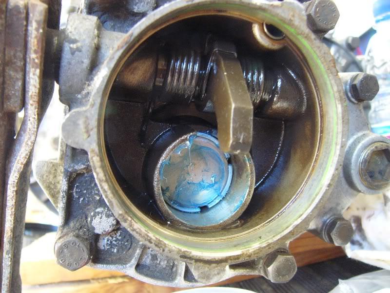

                        • Here's a few pics of the close ratio box getting ready for a new clutch.
                          Here I've replaced the throwout bearing, shaft bearing and oil seal.

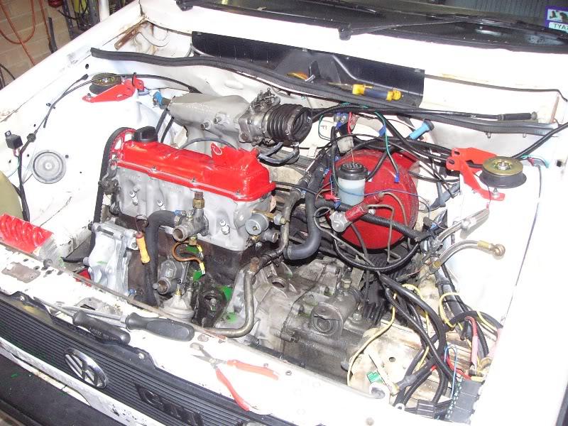

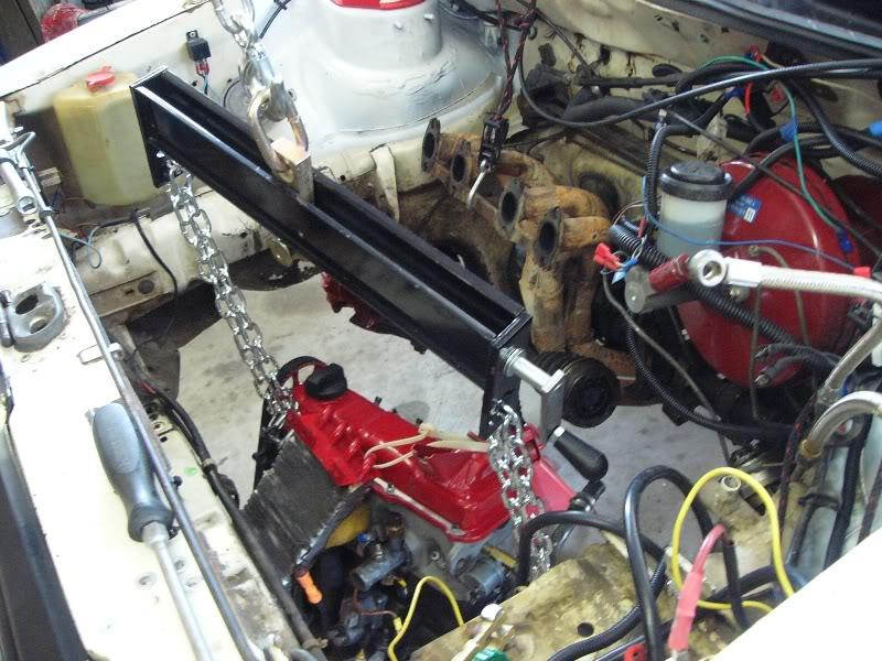

                          • Today's motor removal.

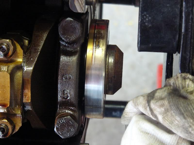

                            • Leaky rear main seal.
                              1800 k-jet head sitting on the 2.0 block.

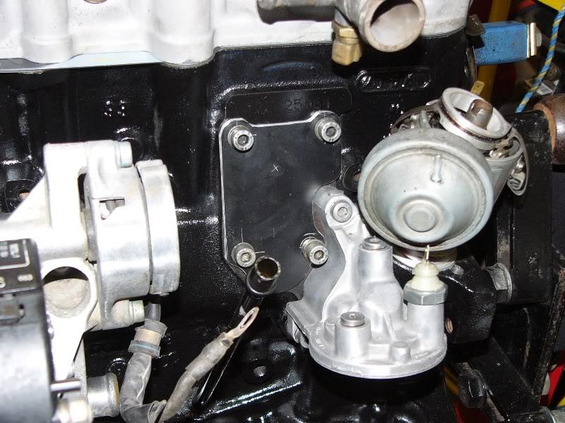

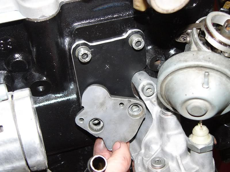

                              • Here's the block off plate I made up to seal odff the 2.0 Breather box.
                                The mounting plate for the warm up reg will bolt right on top.
                                There's a few more fiddly bits to sort out yet, but with luck I'll pop the new motor in next weekend.
