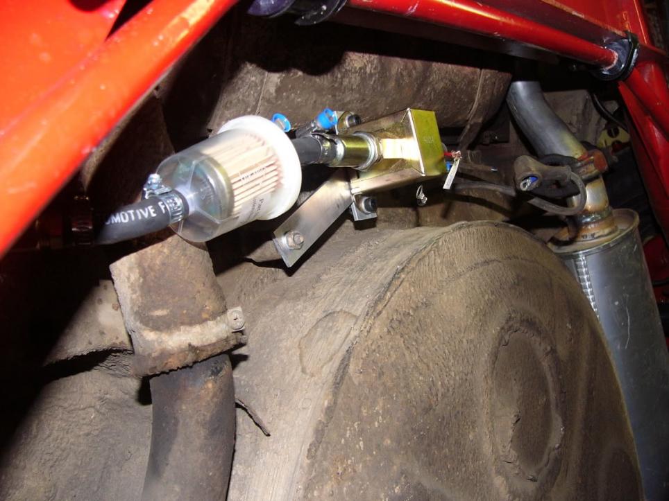

      • Time to go have a look at the fuel pump for a bit.

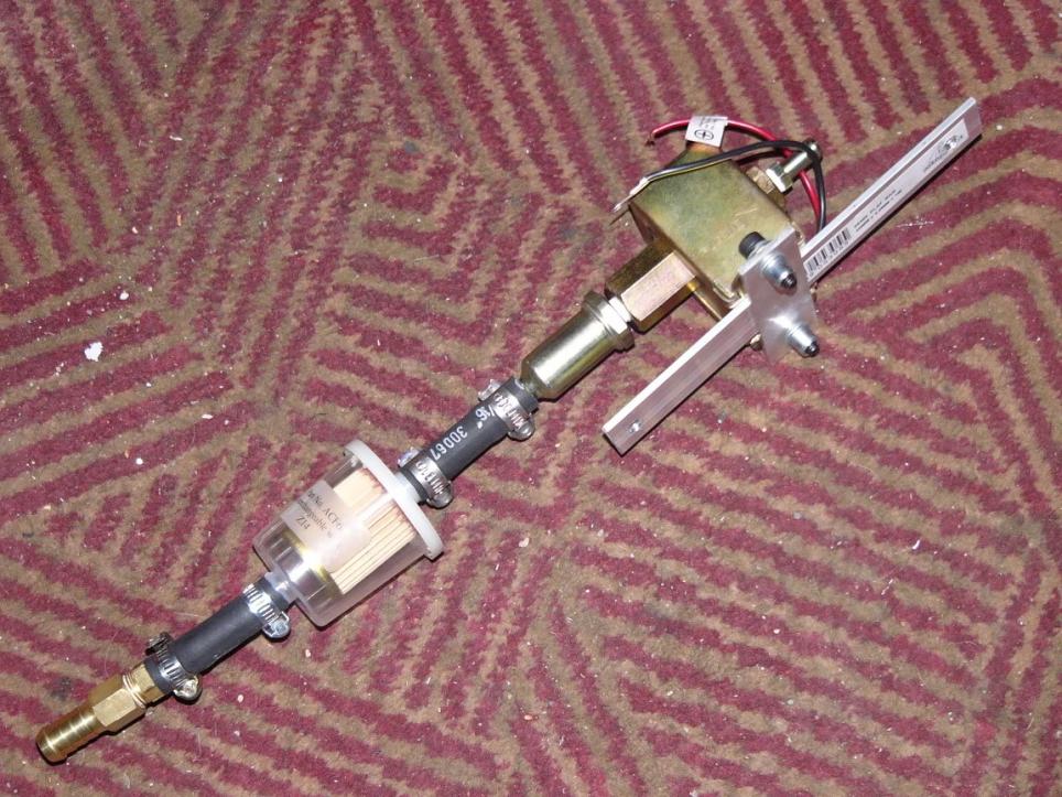

                      Pump's in , just a little facet style monoblock pump, picked one that delivers just the right pressure. Wiring tomorrow, I'll hook it up to the cut off relay as before with the K-Jet to keep it track legal.
                      Made up brackets to hang it off the K-Jet pump rubber mounts.
                      Only a couple of little projects to finish off during the week, wiring and throttle cable then I should be able to make some noise.

                      • yeh i've done the gasket kit on my Weber, was pretty easy.
                        that looks like the fuel pump that i have, however i might go and buy anotherone with the specs that i want so i know i have the fuel supply there and dont have the same problem of an empty float bowl at high RPMs.

                            • Originally posted by GoLfMan View Post
                              I'm surprised that you're running out of fuel with one of these pumps, they'll usually flow litres per minute. I used one on my 1835 beetle feeding twin 40 DCNs and it had no problems, even with some pretty massive fual comsumption under race conditions. (About 5 + litres / lap of the old Morwell Hillcimb track)
