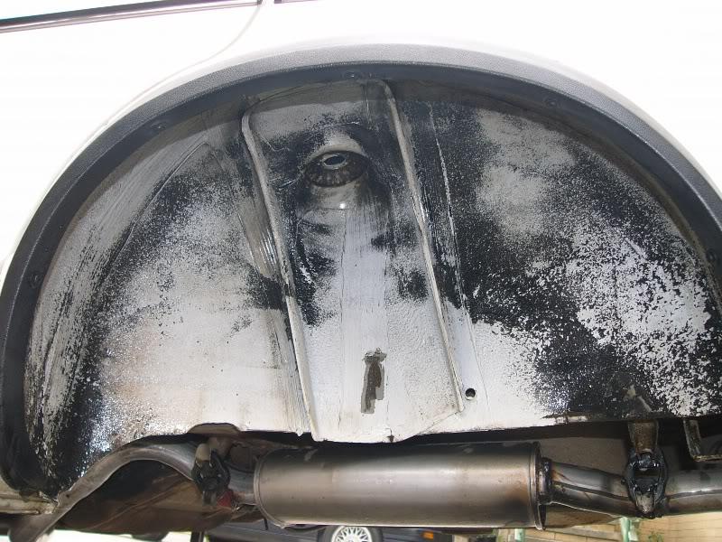

    Cleaned under the guards while I was in there.

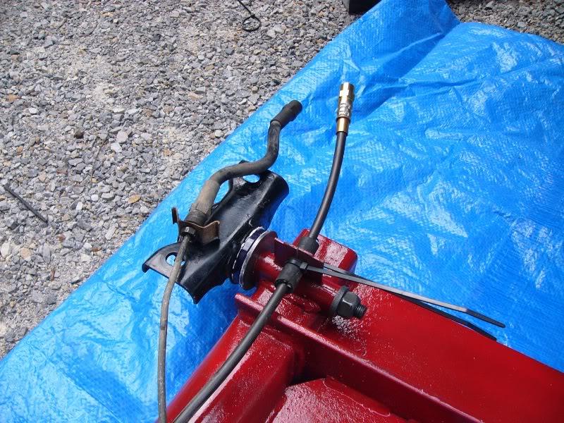

    New braklines. I had these made in one piece. The join on top of the beam is hard to get to in the car and it was cheaper this way. That's the old line next to it for comparison. I sleeved the brake line with rubber hose and slit the bracket to put it in there. I'm not making sense am I? Just look at the picture.

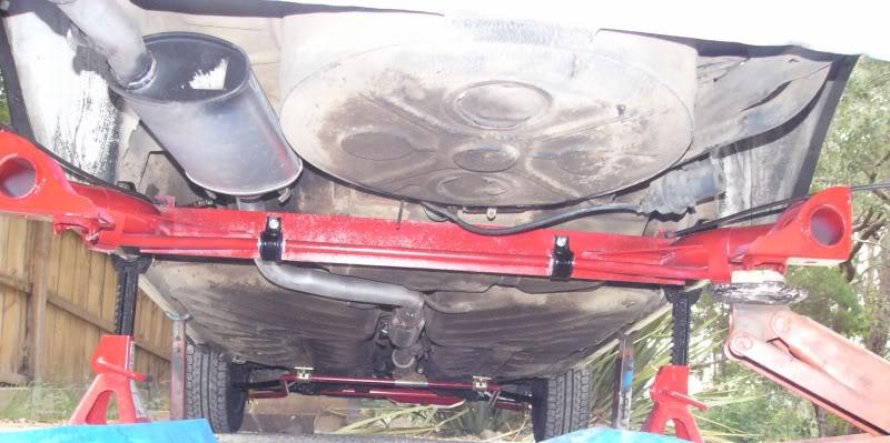

    Ready to go back in.

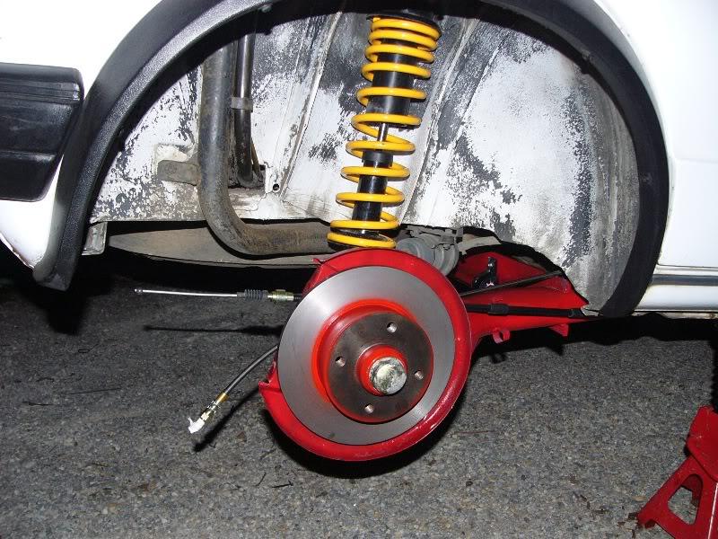

    In!

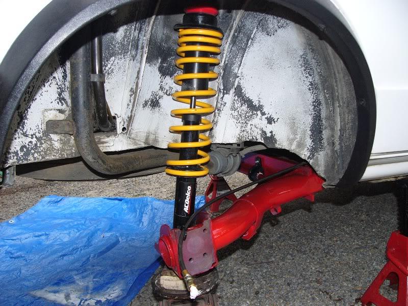

    Shocks going back in, now with urethane mounts.

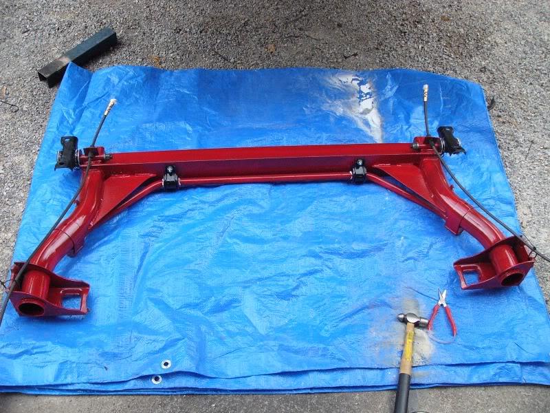

    I've never really understood the design of this bar, but here's a picture anyway.
    And this is as far as I got.
    I would have got the lot done but it took me a while to work out how to install the suspension bushes and the red paint took ages to dry.

      How difficult is it to get the rear bar off? 4 bolts and she's done is it?
      Easy.
      Just remove-
      Handbrake cables.
      Brake lines.
      Shocks.
      4 bolts and it's out!

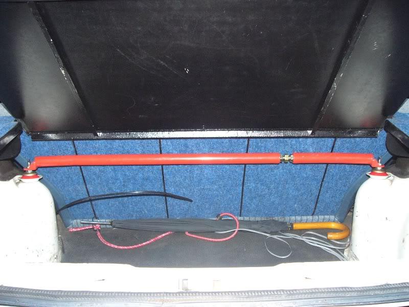

        In regard's to your rear strut brace, I reckon it should be triangulated like the Neuspeed. At least it tie's both the strut tower's not only together, but also to the chassis rail's.
        I have thought about buying one of these, but when you carry stuff around all the time, it's not viable for a street car IMHO.
        • #64
          Regarding the rear strut brace, I've got in the back of my mind that I heard somewhere that some classes don't allow for the rear towers to be braced.
          I'm investigating a harness bar (which might perform the same function ) but have more research to do.

              Yes production class rules: Rear brace must be in the hoop (Roll Cage) dint know why but thats just the way it is
