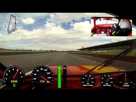

  • Here's the second timed session.
    The data display runs out about 1/2 way because I accidentally truncated the log data in the conversion process.
    I got warned for being too loud after the first run so for the next 2 runs I short shifted to 5th gear on the main straight.
    The car read 80dB and the limit for that day was 75dB. I'll fix it by fitting an airbox.
    Oh, and yes, I do miss a few gear changes along the way in this round. I think I need to make some adjustments to the shifter.

      • Originally posted by fthaimike View Post
        i guessed so pmsl at your above comment, good save though.
        what is the top speed at the moment Peter...mph
        also do you left foot brake, it didn't show up on the graphs?
        The top speed I've seen so far is just over 180km/h or about 110mph. 5th gear is a limiting factor here. The box builder must have used a 0.75 5th instead of the 0.91 I thought I'd supplied.
        If you look at the RPMs in the videos it's dropping nearly 2500 RPM in 5th which just isn't right.
        Some quick calculations confirm a 0.75 5th but I'll have to explore a little further yet.

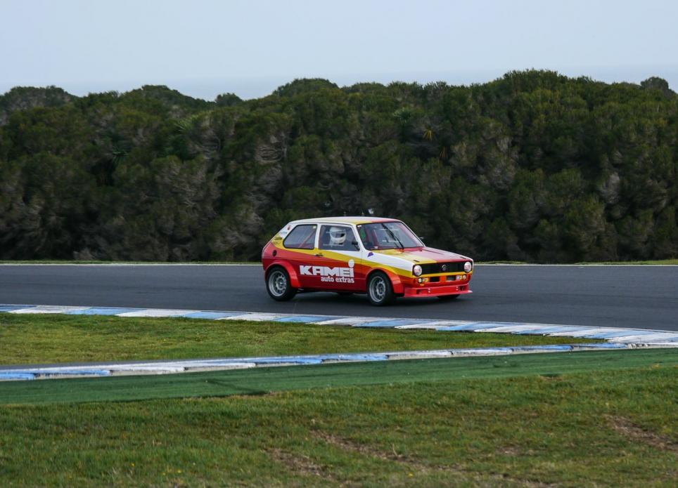

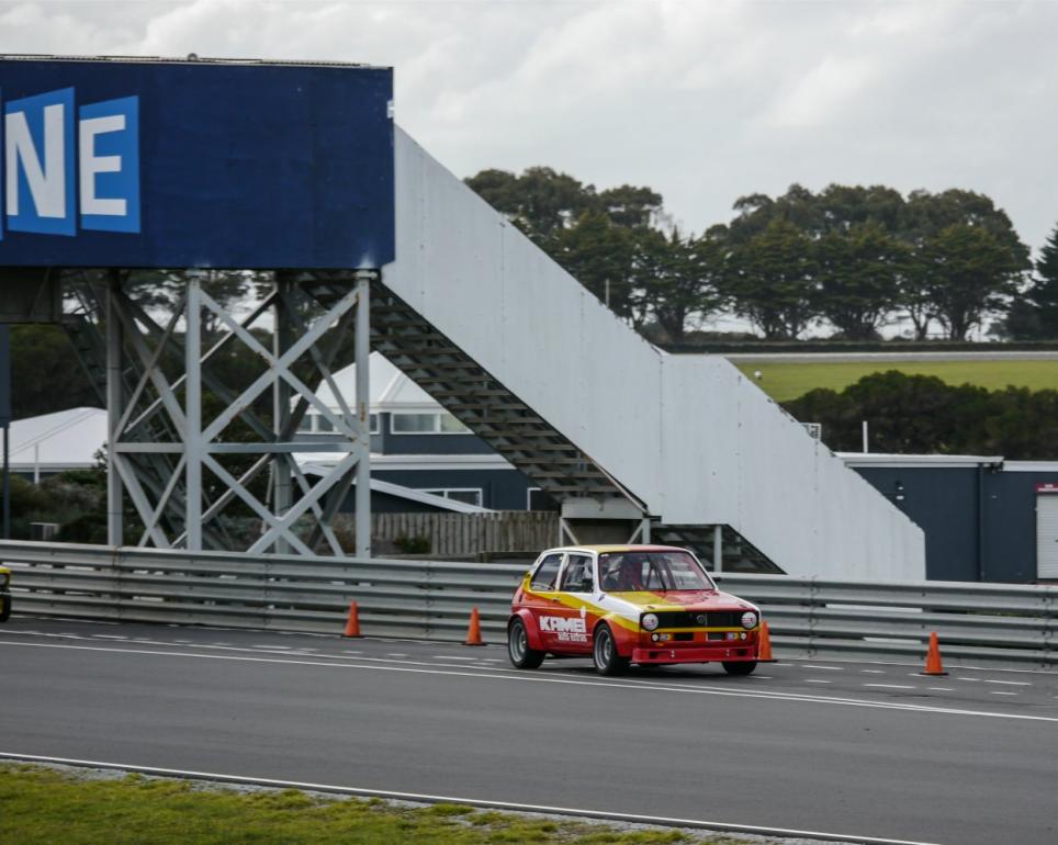

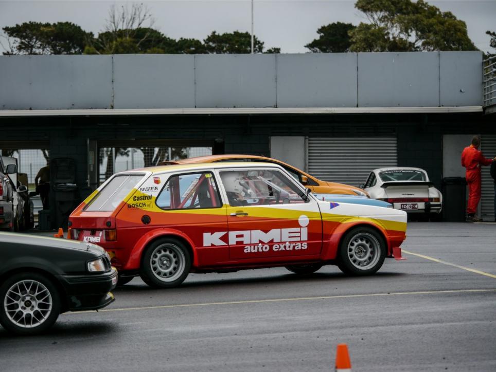

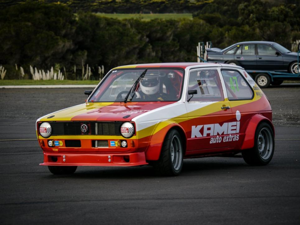

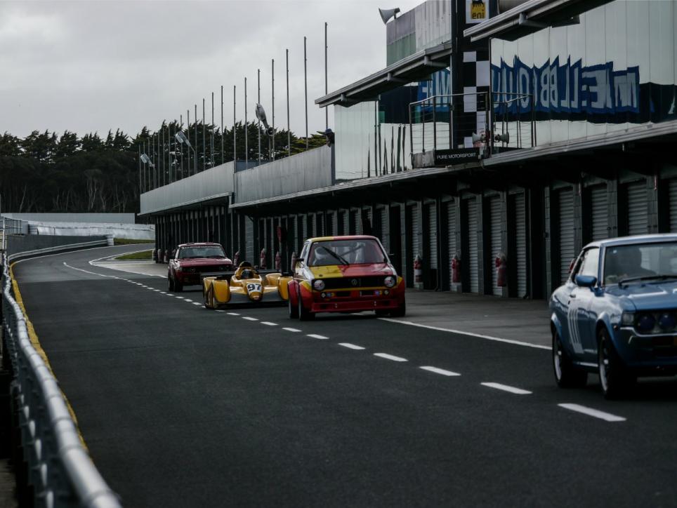

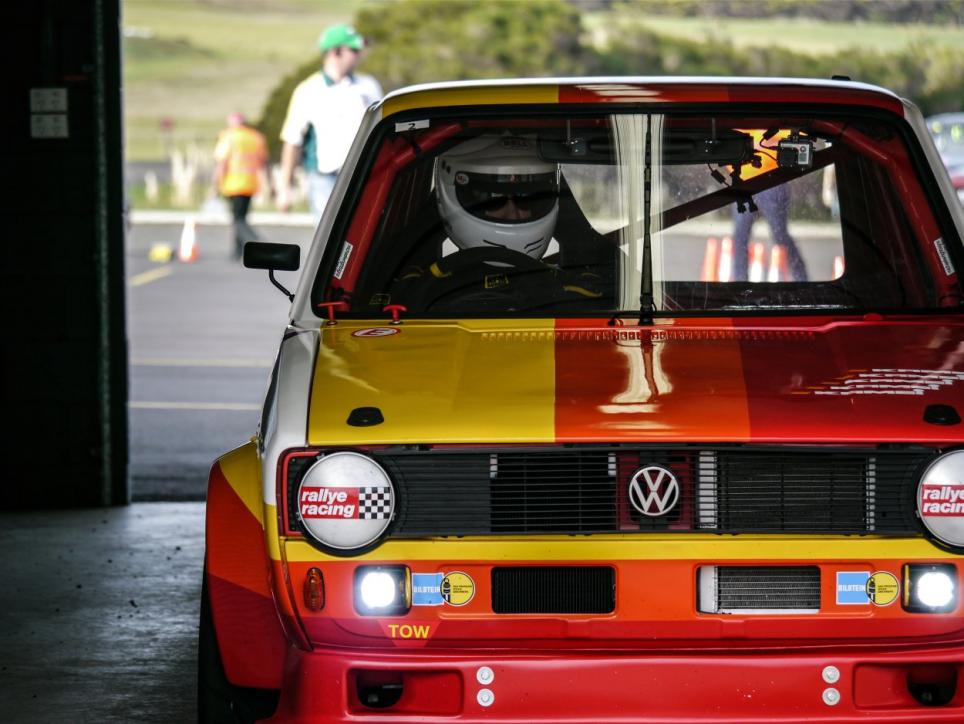

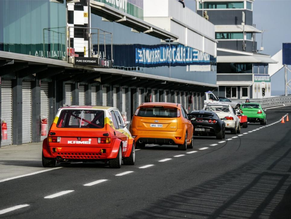

                      • Some photos from Sunday.
                        7? MK1 Caddy
                        79 B1 Passat Dasher Project
                        12 Amarok

                              • Do you know what the car #97 is?
