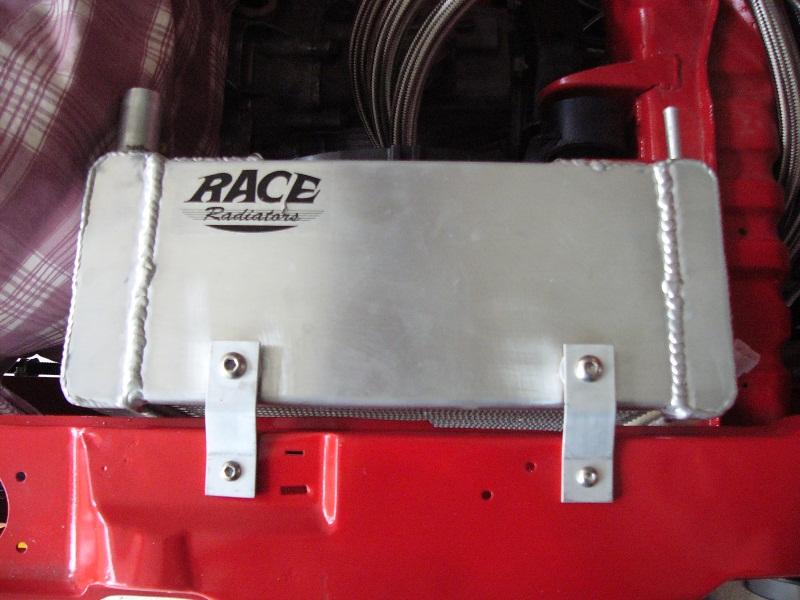

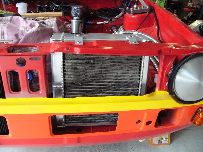

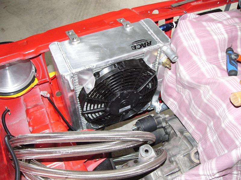

      • Radiator is done.
        Bushes
        Dual stacked 55mm cores.
        Setup to run a late model expansion tank.
        The ECU can run the fan but I had a MK1 style fan switch fitted In case I need it later on.

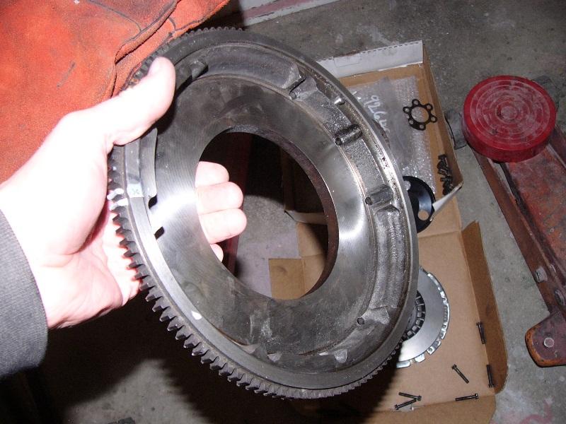

        • Flywheel is back from Crankshaft Regrinders..
          It's been lightened, resurfaced and balanced.

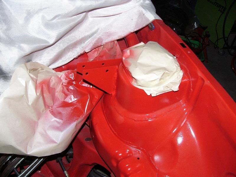

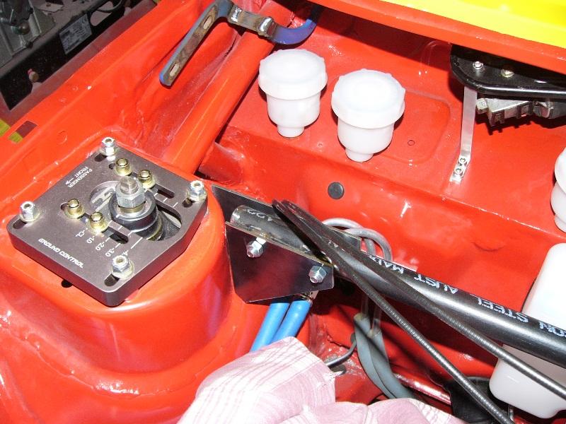

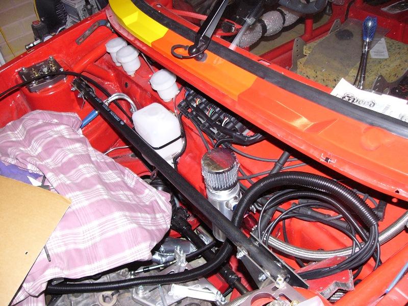

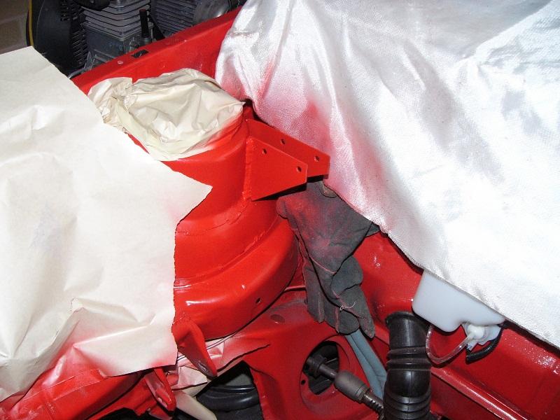

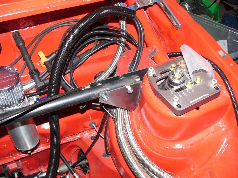

          • Now that I know how everything fits in the engine bay I can make and fit the strut brace.
            I'll weld the brackets in tomorrow and make up the lower brace as well.

            • that' radiator is mighty thick!
              (it also gives away a few clues about the engine )

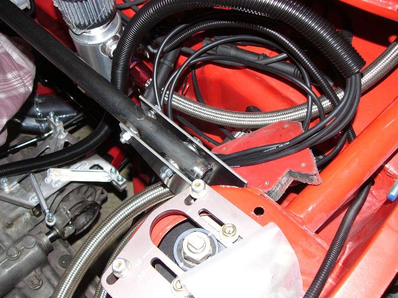

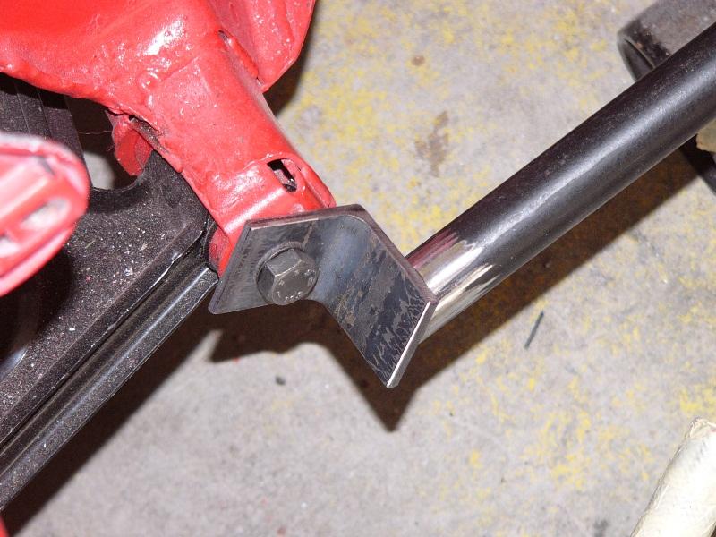

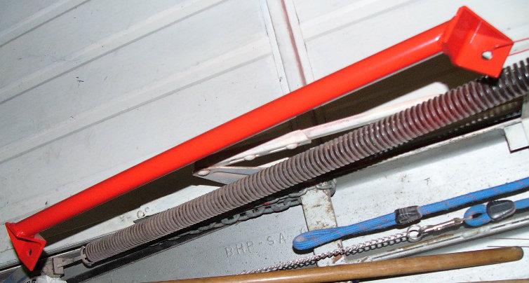

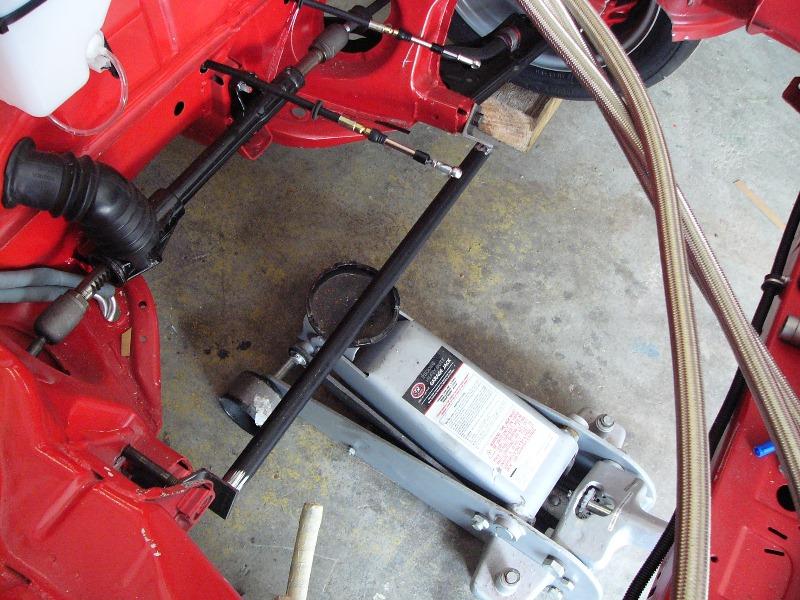

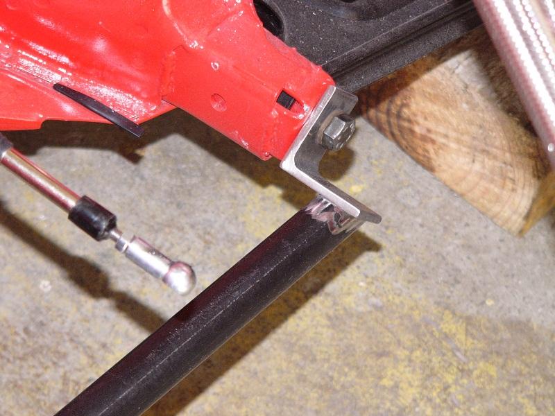

              • Made up the lower brace and welded in the mounts in for the upper brace.
                This is a pretty common bark yard design.
                Wire edged a couple of places I'd had to trim too.
                Lower brace painted up.

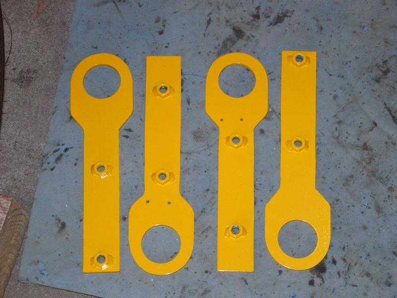

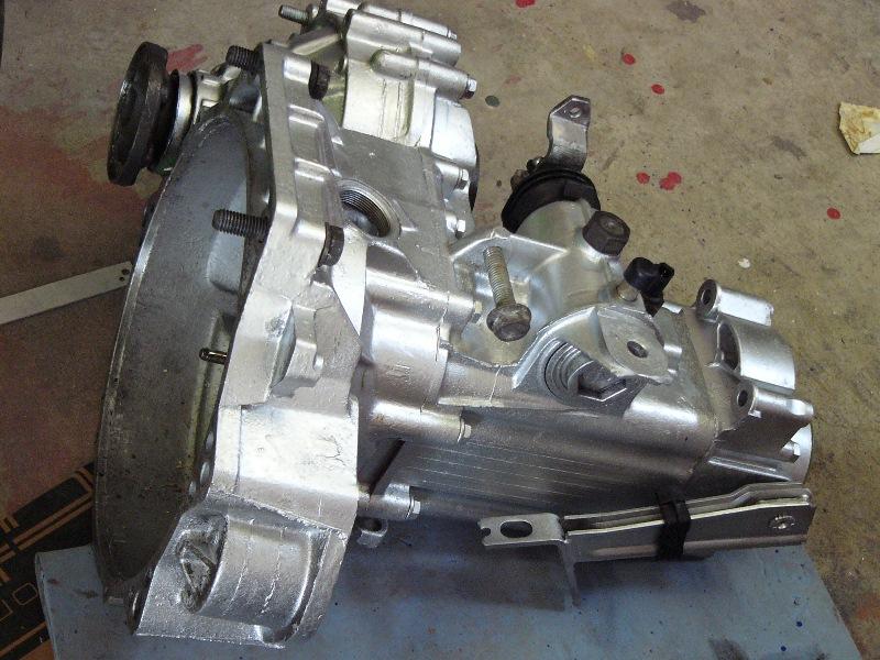

                • Got the gearbox ready, It had 100mm output flanges on it so I swapped them over for 90mm ones off another box.
                  The 100mm flanges took a lot to get off, had to use a set of 20 tonne pullers.

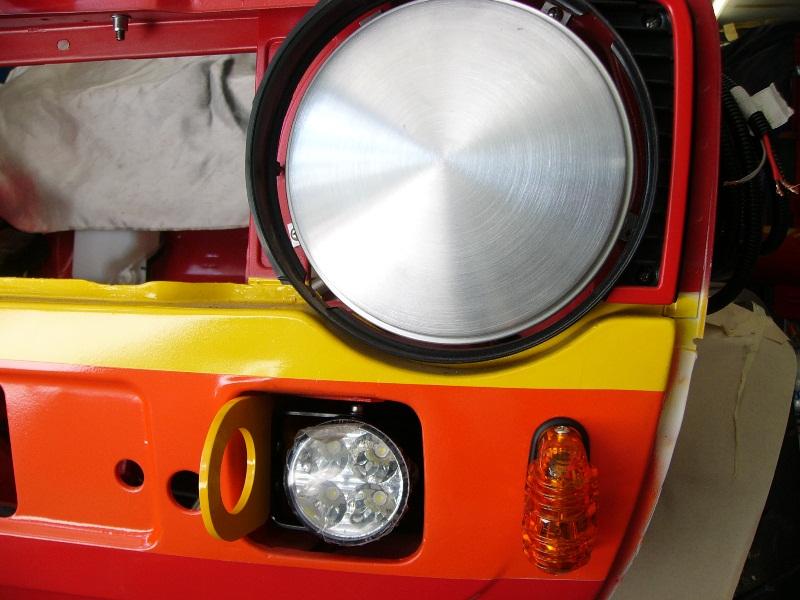

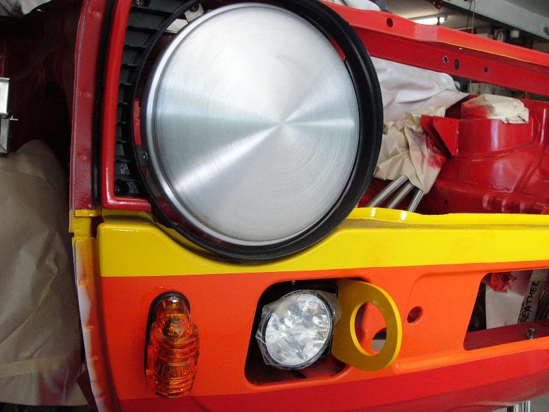

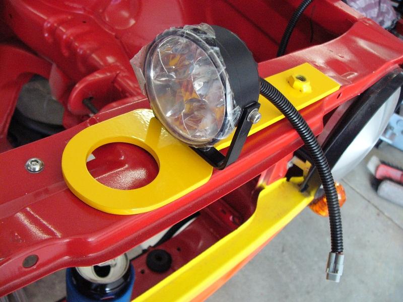

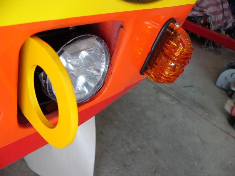

                  Tow hooks came back form powder coating and got installed.

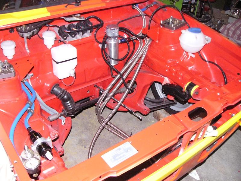

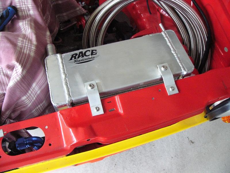

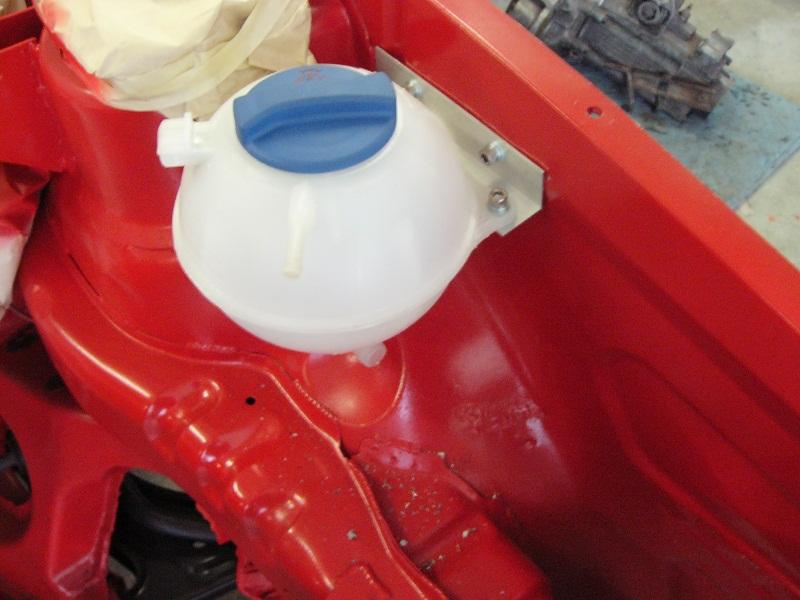

                  Made up brackets and mounted the expansion tank.
                  Engine bay is starting to look pretty busy now.

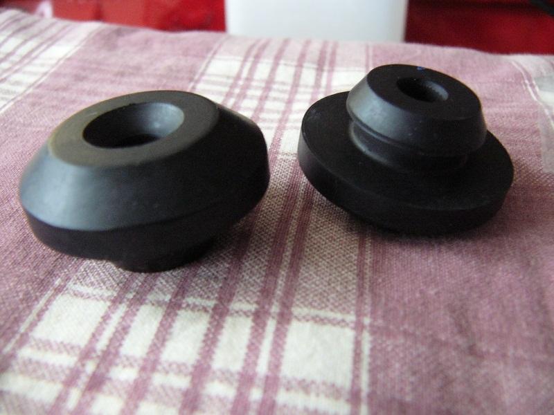

                  Those BFI engine mounts are a joke. They seem to be made from reasonable materials but the dimensions are all wrong. The bolt hole was too small for the bolt to pass through and the whole thing is too wide.
                  The drivers side one is notched to clear a bolt but the notch is in the wrong place.
                  Don't buy them unless you've got access to a lathe and linisher to fix them.

                      I recall Tim Bailey having similar troubles with the BFI inserts
                      • Same ones, I bought these off Tim

                          • I've got nothing but good things to say about the BFI mounts I have fitted a treat.
