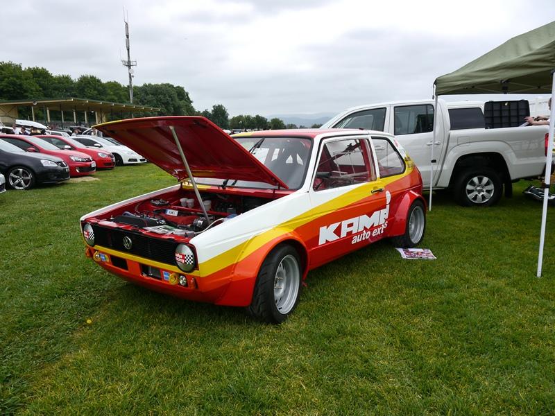

            • Hi all,
              saw this in the flesh at DOVW today, words fail me as to how good it looks!
              Congrats on an amazing build and thread!

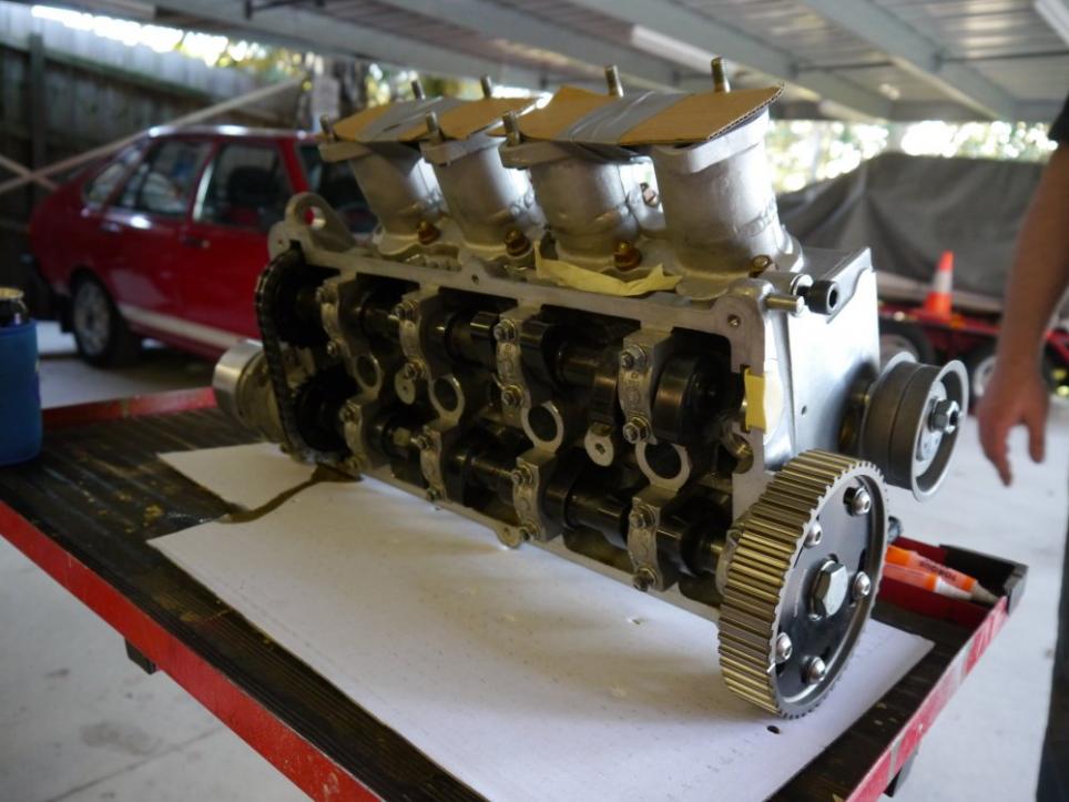

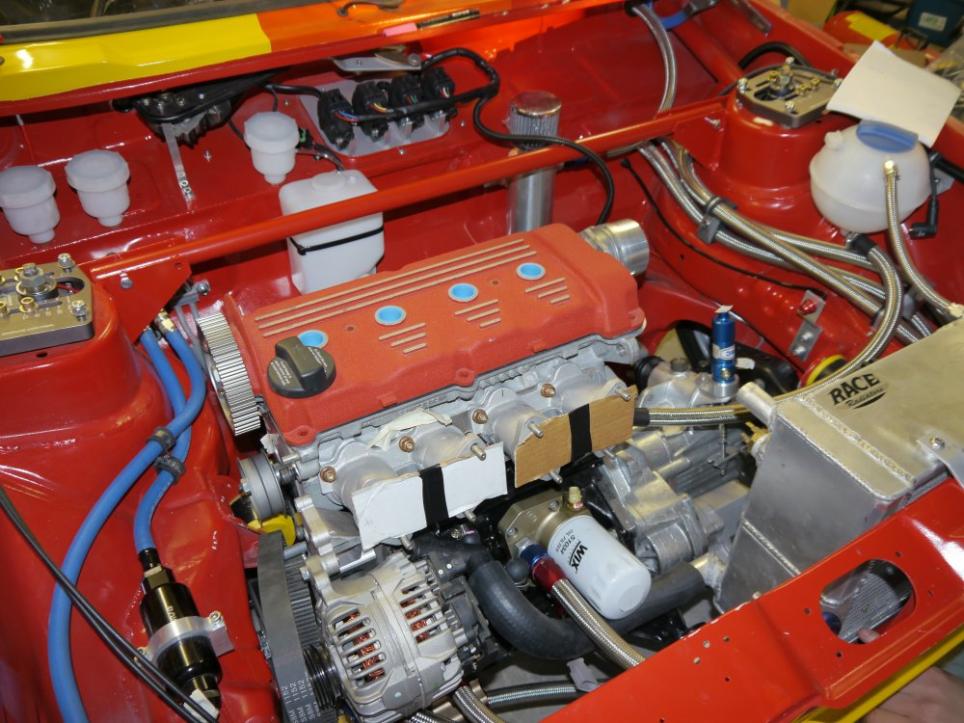

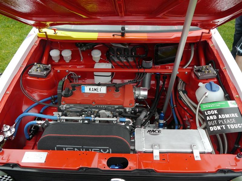

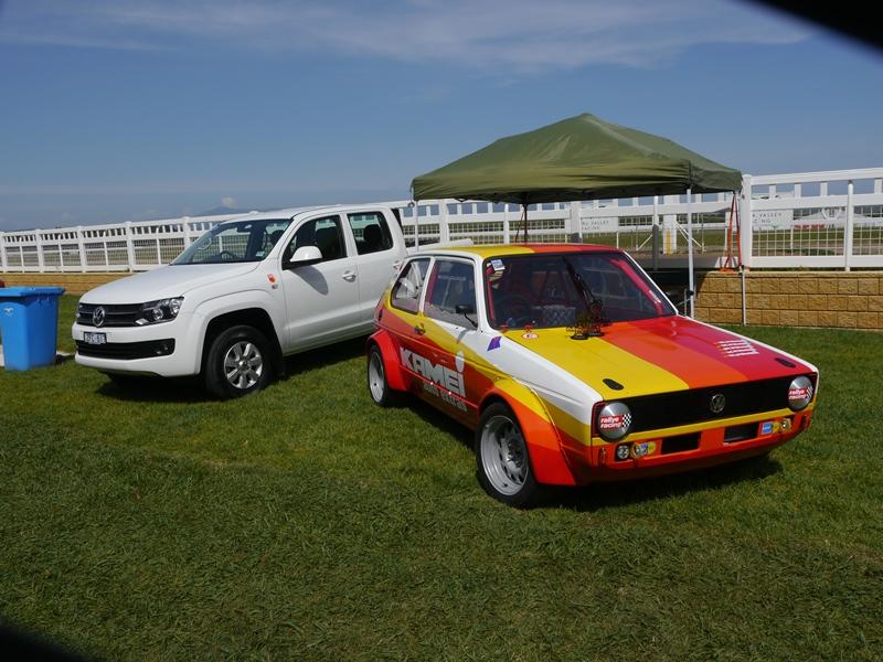

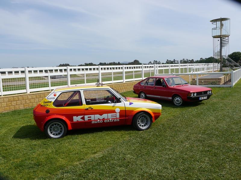

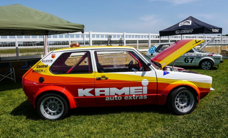

                  • Here's a few photos from today, I'll be posting up the engine details soon.

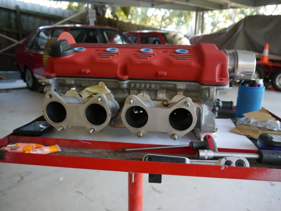

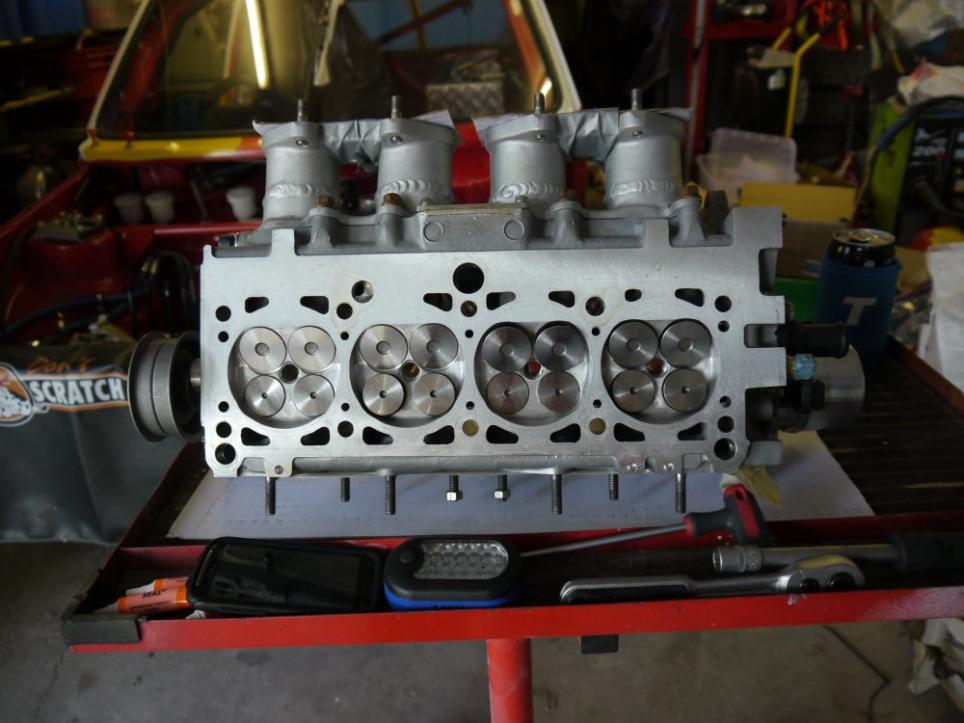

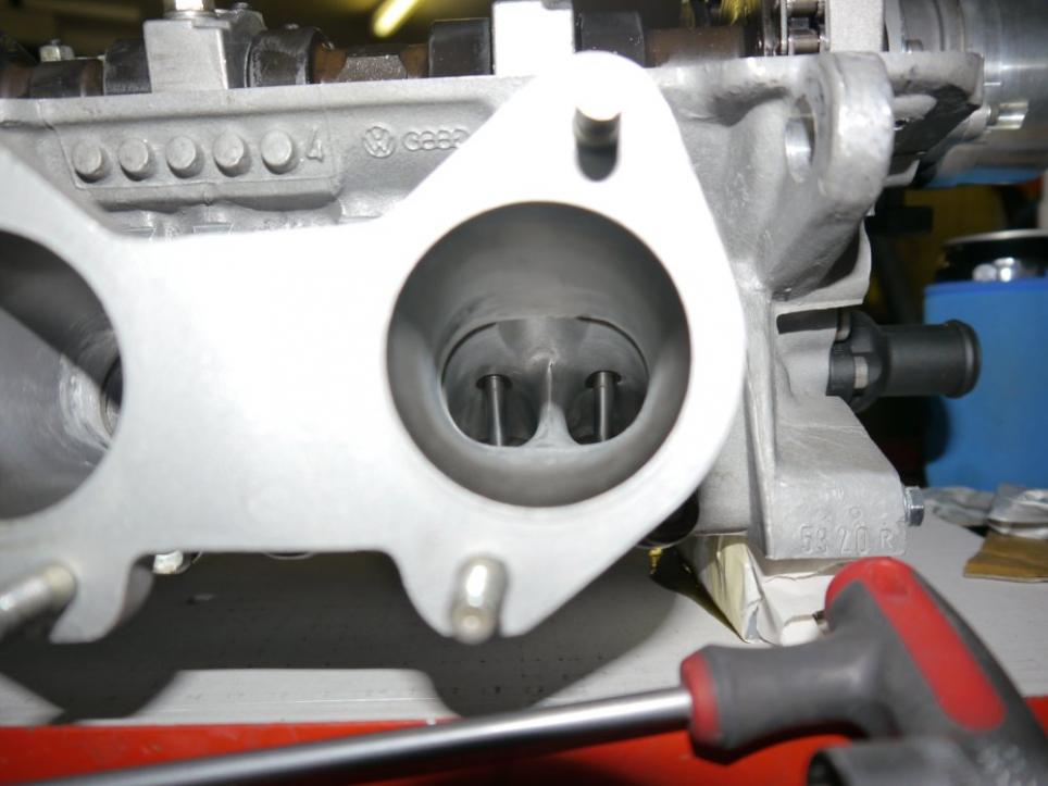

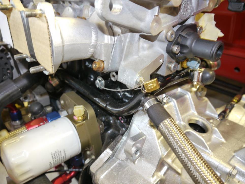

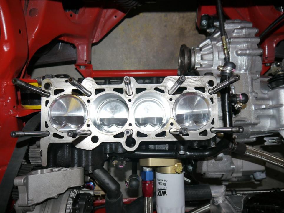

                    • Here's some photos from the CAMS inspection of the motor.

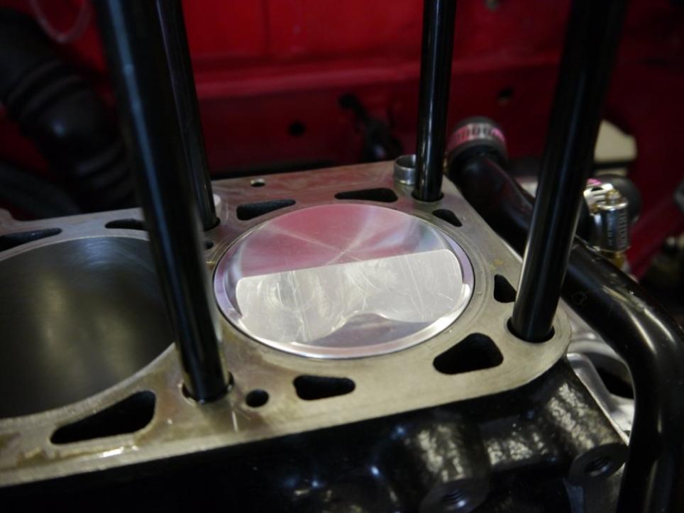

                      ARP undercut head studs and custom high compression JE pistons
                      Ports were CNC machined and finished by hand.
                      Anyone recognise the block yet? (I'll write up the motor story soon)

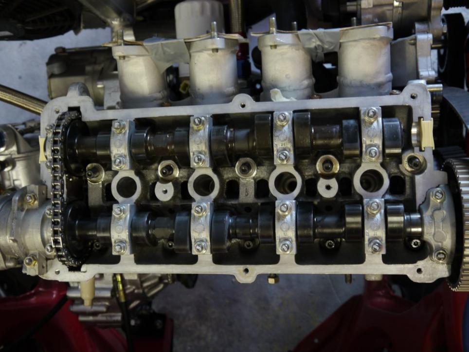

                      CAT cams with solid lifters.
                      Valves are 34 x 28.5
                      Dry sump adapter on block. I was also playing about with radiator hoses at this point.

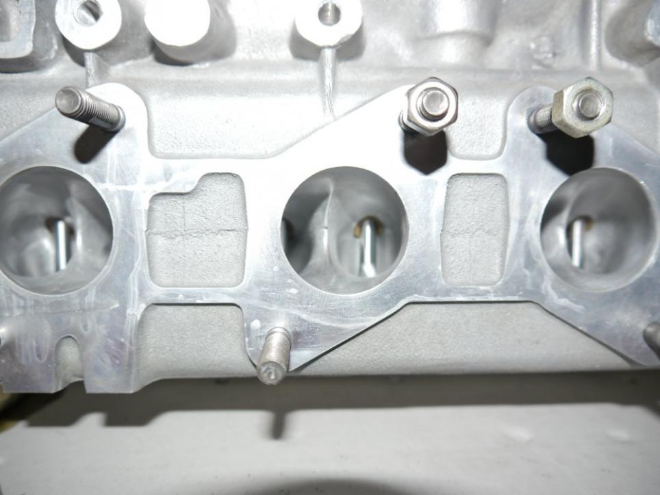

                      Inlet ports.
                      Exhaust ports

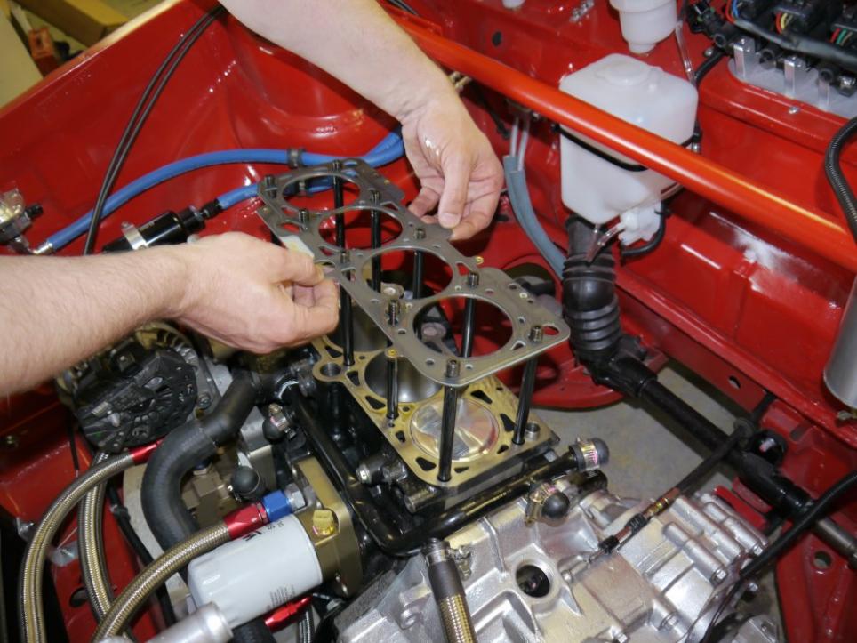

                      Customised head gasket.
                      The CAMS engine seal.

                      • The motor was built by EuroSpec for me in the US. Eurospec: High Performance Parts for Audi and Volkswagen
                        I had initially approached them for one of their FIA spec crank, rods, and piston sets to go into the ABF motor I've got here.
                        It turns out those kits are designed for the shorter blocks and it became rapidily apparent that trying to machine the block in one continent and make parts to go into it in another one wasn't going to work.
                        I was trying to negotiate with a head company in the UK for the head work at the time but they just wouldn't respond to ay form of communication.
                        Steve (The owner) and Eric from EuroSpec were super helpful and offered me a head they had built as spare for one of their race cars.
                        They also had the Jenveys and manifold in the spares cupboard and made me an offer I couldn't refuse.
                        After lengthy discussions and much head scratching we settled on the 06A block retro fitted with the ABF 16v head.
                        There's many advantages to the 06A including the internal water pump, crank angle sensor and the readily available dry sump system.
                        Going with a KR or ABF block would have required a lot of development work to make a dry sump system.
                        I'm not sure what the final output will be, conservatively 250HP, optimistically 300Hp. It's really tough to say until I get it on the Dyno after running it in.
                        Here's the vital stats,
                        O6A block with ABF 16v head.
                        Bore 84mm
                        Stroke 90mm
                        Capacity 1995cc
                        Combustion chamber volume: 48cc
                        13.5:1 compression
                        Valve size: 34x28.5
                        Tungsten Valve seats with 5 angles
                        Bearings were molly coated and baked before installation
                        The cams are from CAT cams and run on solid lifters.
                        CAMSHAFT PARTNR. : 7641108
                        ENGINE TYPE : VW 16V, KR, ABF
                        INLET EXHAUST
                        VALVE CLEARANCE (hot) : 0.15 mm 0.15 mm
                        (cold) : 0.15 mm (-0,10 / -0,05) 0.15 mm (-0,05 / -0,00)
                        CAM LIFT : 12.70 mm 12.15 mm
                        ROCKER ARM RATIO : 1.00 1.00
                        VALVE LIFT : 12.70 mm 12.15 mm
                        DURATION @ 0.1mm Valve lift : 308 ° 294 °
                        DURATION @ 1.0mm Valve lift : 270 ° 258 °
                        PEAK DIFF.: maxlift @ : 106 ° ATDC 106 ° BTDC
                        Valve lift at TDC w/o clearance : 4.72 mm 3.90 mm
                        1. w/o clearance at : 0.25 mm valve lift 0.25 mm valve lift
                        Valve opens : 49 ° BTDC 73 ° BBDC
                        Valve closes : 79 ° ABDC 42 ° ATDC
                        2. w/o clearance at : 1.15 mm valve lift 1.15 mm valve lift
                        Valve opens : 29 ° BTDC 55 ° BBDC
                        Valve closes : 61 ° ABDC 22 ° ATDC
                        VALVE SPRINGS
                        partnr. : D15009 -
                        fitted length : 36 mm - mm
                        RETAINERS partnr. : - -
                        CAM FOLLOWERS partnr. : CC005 -
                        REMARKS : B/A TDC= before/after top dead centre
                        B/A BDC= before/after bottom dead centre

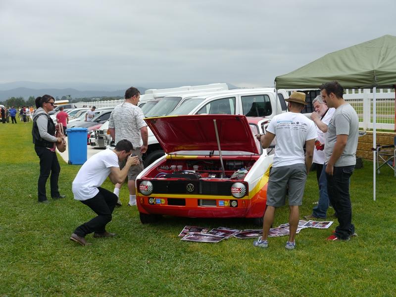

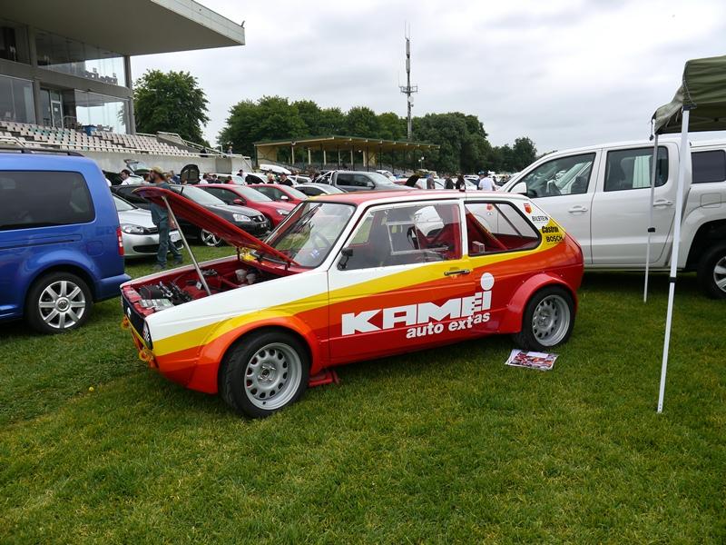

                        • A few more photos from today.
                          I won best MK1/2 modified and best of show modified which was a unexpected surprise.
                          I hadn't really considered actually winning a trophy.
                          The motor isn't running yet, there's still a little wiring to do and an ECU to program. Then it should be just a matter of adding fluids and firing it up.

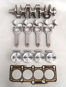

                          • A little more detail on the bottom end kit from the EuroSpec website.
                            This new stroker kit is based on the FIA kit car specification. With a 90mm stroke by 84 mm bore and using a 150 mm connecting rod, this configuration delivers the best balance of bore and stroke on an 88 mm bore center, while still maintaining a connecting rod ratio of 1.67:1. Consisting of an all new super light Eurospec 4340 forged crankshaft with a 46 mm rod journals, Eurospec 4340 H beam connecting rods with Forged JE’s on a 19 mm pin. Including main bearings, rod bearings and a steel head gasket at the very affordable price of $2,250.00. Available for all two, four and five valve configurations and in compression ratios from 8.5:1 to 13.5:1.
