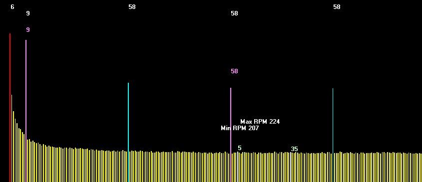

          • These DTA ECUs are pretty neat.
            There's diagnostics to help you setup the sensors.
            Here's the trace on the crank and cam angle sensors.
            I'm using the stock 60-2 wheel and VR sensor from the 06A block.
            Hence the blue lines indicating 2 missing teeth 58 teeth apart.
            Pink lines are the distributor signals.
            Still a bit of head scratching to figure out the offset between the crank angle sensor and the crank itself, but I think I can figure it out with a timing light.

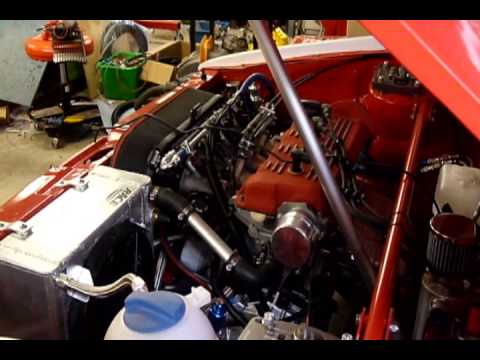

                • Started it up tonight.
                  It ran a little rich until I remembered to calibrate the Lambda sensor.
                  At this stage I've only run it long enough to break in the cams.

                  • Nice one Peter looking and sounding great.
