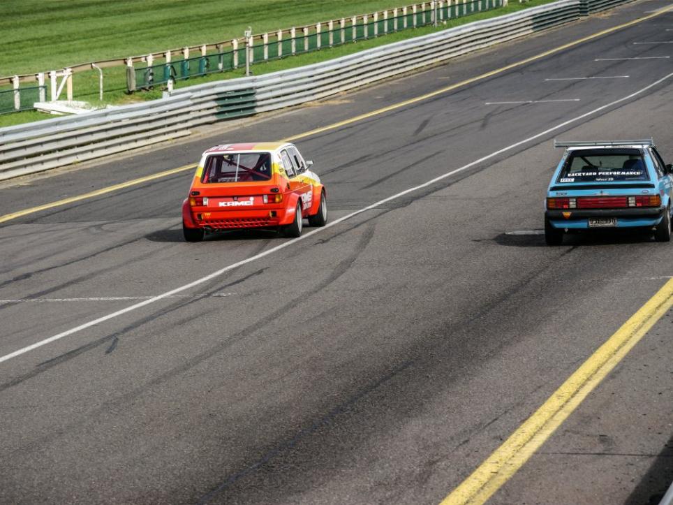

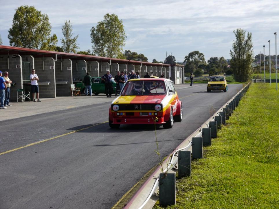

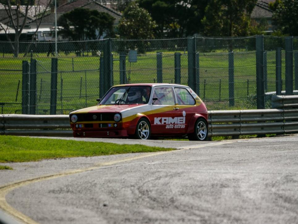

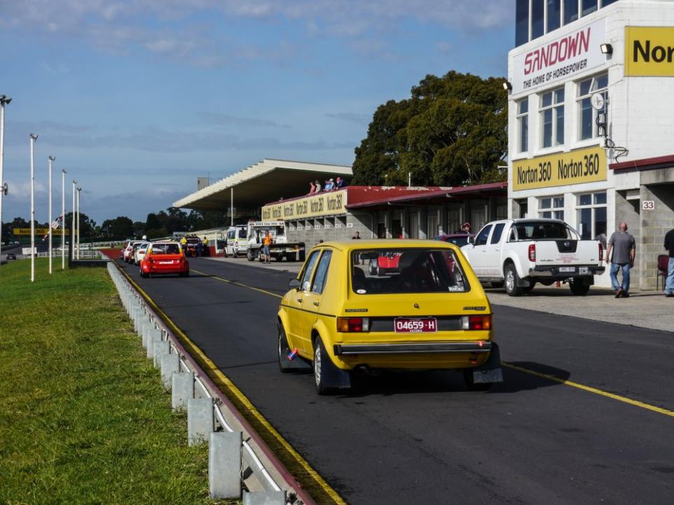

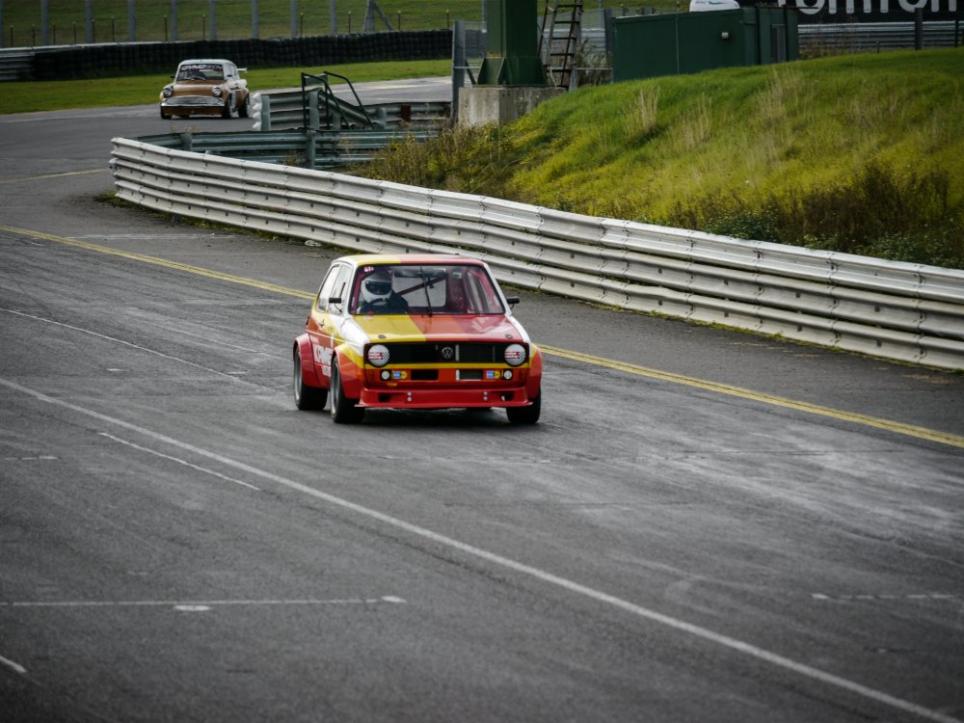

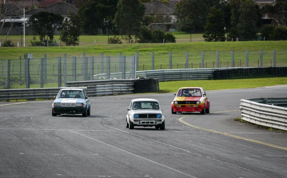

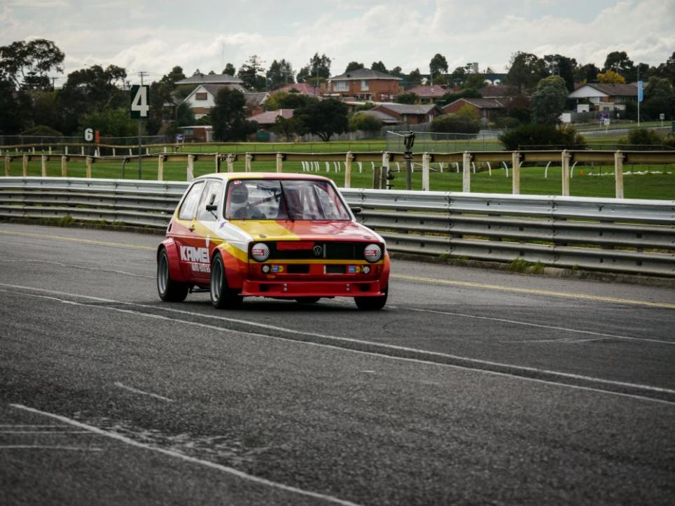

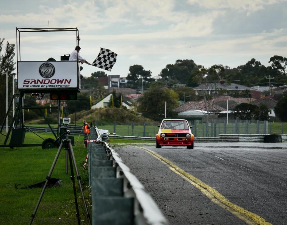

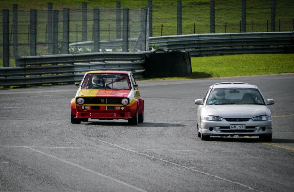

                            • OK I'm pretty tired so no a lot commentary.
                              I flew back from the USA yesterday and raced today, the jet lag thing is making it hard to type right now.
                              Geoff Hale came out to play today in his MK1 "Mule"
                              The Kamei Golf goes really fast! This is the second outing and I'm starting to get the hang of it but I'm nowhere near the kinds of corner speeds it's capable of and I'm not anywhere near the limits of the brakes either.
                              Here's some pics whil eI clloect my thoughts.
                              Video and data worked properly today so I'll have some videos to share over the next few days as I get time to do the editing.
