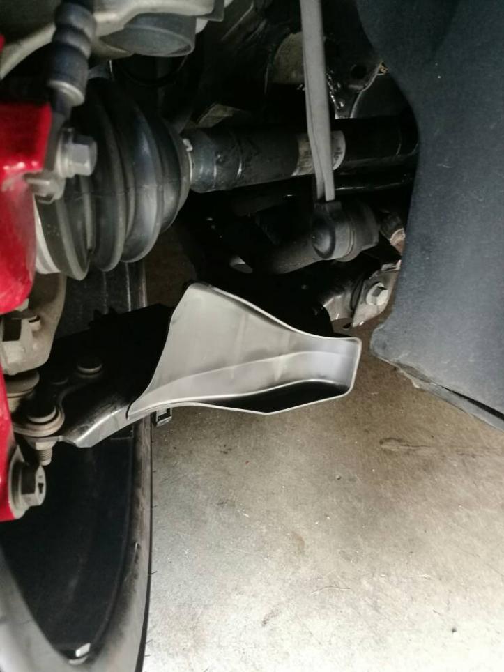

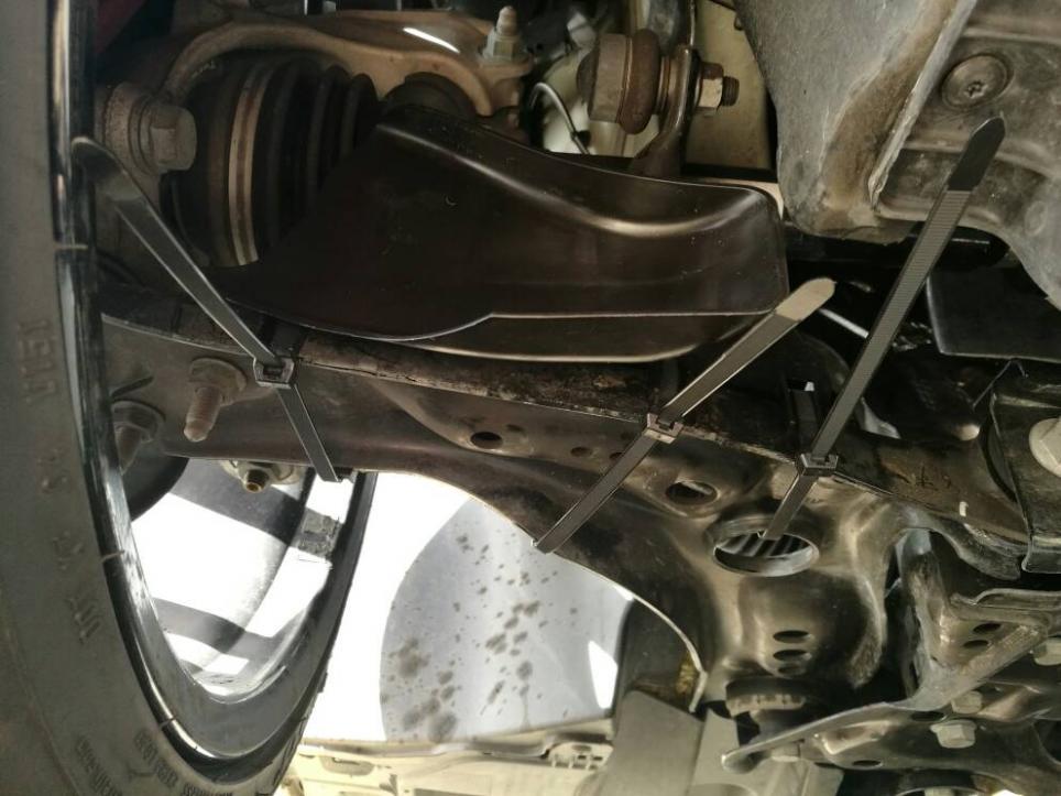

                    • Skoda Friday, RS3 Brake Ducts...
                      Ordered some Audi RS3 Brake Ducts via a group buy via Facebook page 'SkodaModderz'.
                      Part numbers:
                      8V0407811
                      8V0407812
                      Not sure if they will help on track, but they can't hurt...
                      Busted a clip, so just be careful and make sure the duct will clear the wheel arch.
                      Photos weren't final install as it felt it was to close to the wheel arch.
