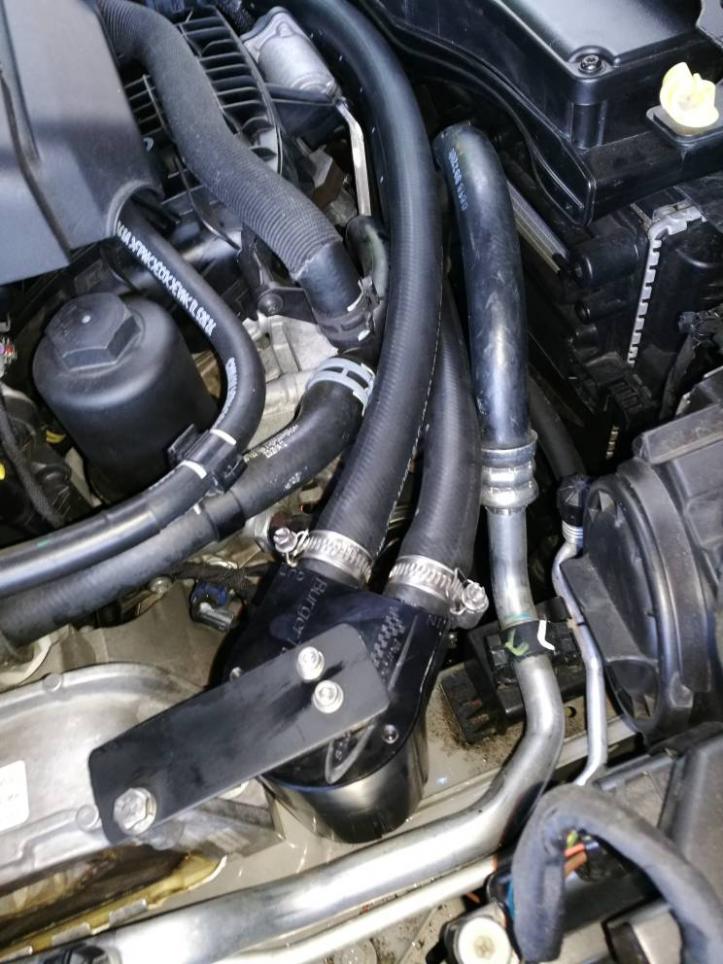

 Ripped the Oil Catch can out, unfortunately it vibrates around the firewall. I filed the Dowl off and tapped and put a bolt thru for a longer dowel. Still not very nice, so its off the car.
 Its a nice bit of kit, but the mounting point has let it down.
 Ill look at other options once the Clutch is sorted.

 Re install BMS catch can to the engine mount.

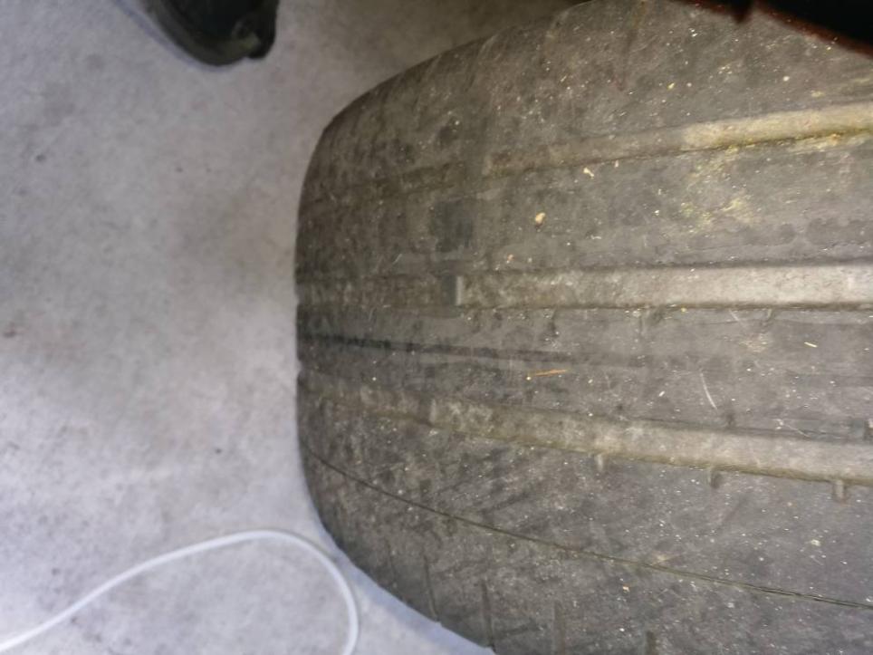

 Found front tyres are well shagged, so will sort them out this week
 Skoda RS230
 New P Zeros on today, the Current Tyres have lasted bang on 24,000km, Prob not bad for the hard life they have had....
