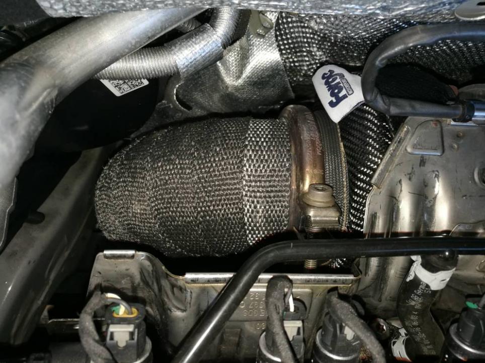

      Downpipe out and heat wrapped, sounds a lot better now, it's lost its tinny-ness.
      Forge turbo blanket on, needed to remove heat shield, like 4 bolts.
      Both these should keep some heat out.

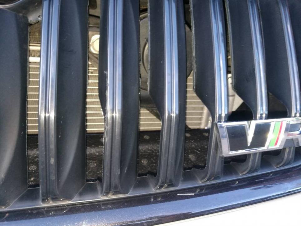

      Also cut the other half of the front grill out, which should help with air flow...

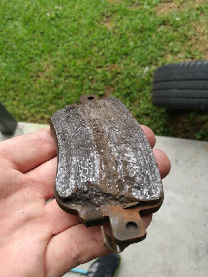

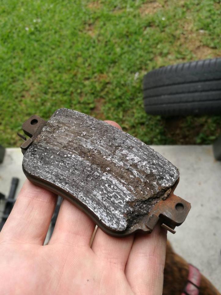

                            Noticed the rear rotor had a rust ring, so had some time to pull the pads out and found that the pad has broken down, I'm guessing I got some solvent on it while washing the wheels or something
