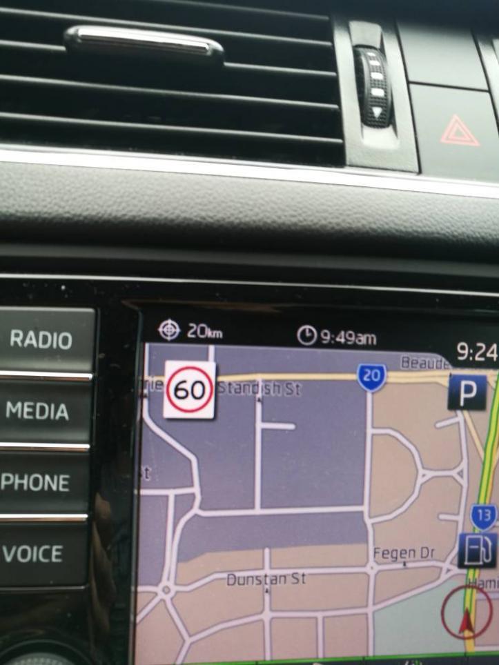

                    • so i installed the P76 (ROW 2019) maps - all good, and speed signs are showing as normal, as they were before.

                      MY17 Superb 162TSI, Business Grey, Tech+Comfort Pack, APR ECU+TCU Stg 1, SLA, Rieger Splitter + Side Skirts, Eibach Pro-Kit Springs, Hardrace Swaybar, TPMS

                        • Originally posted by dArK5HaD0w View Post
                          [ATTACH=CONFIG]40034[/ATTACH]
                          Nice to hear, yea speed sign turned up Sunday, will keep an eye on it
