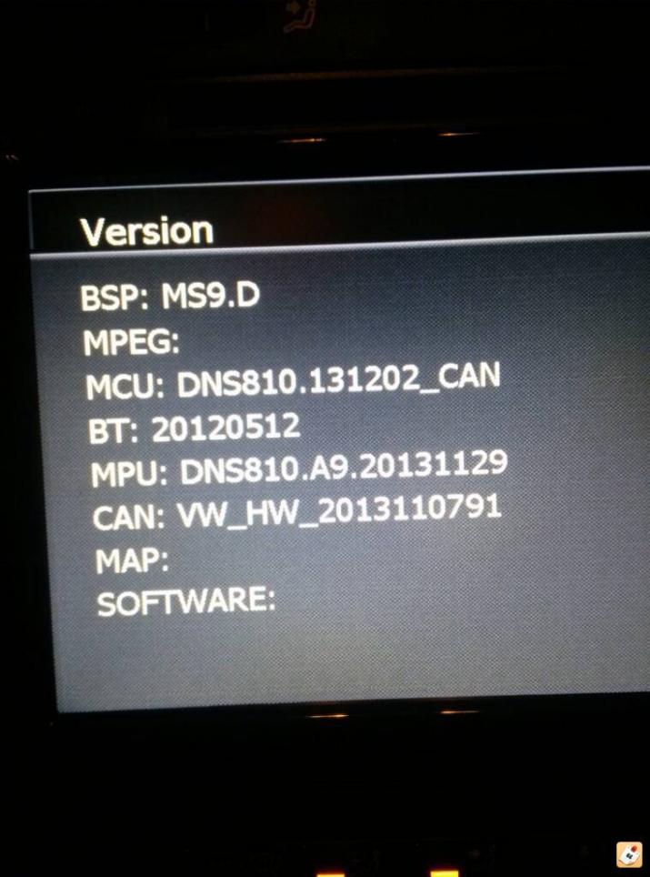

Im getting these monsun.exe errors more frequently now. Which usually results in a key pull (ignition off, key out).Originally posted by kwalsh24 View Post
First bug of new fflash, well actually iits an old one, SD playback, crash with this error & system freeze. Monsun.exe
Bluetooth playback still poor, sysfem sometimes flips from input to radio then back.... still static in the background of SD playback.

Can you please tell me what version of firmware the unit shows to be running now? That monsun.exe error only came up for kwalsh24 as far as I am aware, and he has a definite faulty unit. You may be in the same boat, if your firmware is current. It is not a memory message, it just says the program monsun.exe had a critical error and must be ended.Originally posted by Fdandy View PostIm getting these monsun.exe errors more frequently now. Which usually results in a key pull (ignition off, key out).
Sandy - were you able to translate this issue? Is it the meory leak one?

Originally posted by DkN View PostCan you please tell me what version of firmware the unit shows to be running now? That monsun.exe error only came up for kwalsh24 as far as I am aware, and he has a definite faulty unit. You may be in the same boat, if your firmware is current. It is not a memory message, it just says the program monsun.exe had a critical error and must be ended.
Latest firmware I believe.
