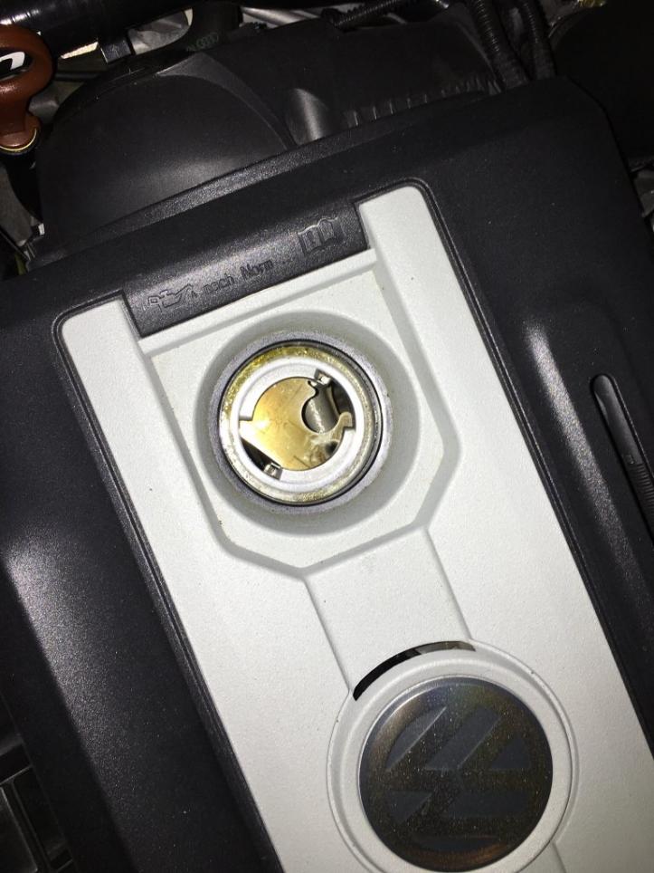

    and turns out that the issue was not an exhaust valve but an oil baffle distributor which had fallen out and hit a cam shaft, damaging it and the rocker plus various engine seals. Which evidently mean't the cylinder head had to come off.
    Putting aside the fact that I had been without a car for more than a month, I had to deal with warranty issue claims, car ownership errors and taking my car to 3 alternative places other than my mechanic to source what caused the issue and how to repair it. After taking some advice I finally took the leap and booked it in at Denlo VW. They, much like this thread Oil Baffle has fallen into my head supposedly!! diagnosis'ed the cause of the issue by "someone" pushing the oil distributor down and ultimately weakening the baffle until it fell into the head. This is this piece that fell in. I know nuts right...!

      Don't know how that baffle fell off - its bolted in place. You don't need any special "tools" to service the Mk6 GTI engine so that line is bollocks. I've been servicing my Mk6 GTI myself every 6 months since i bought it just over 3 years ago and never had a single issue in this regard (the car had had its fair share of other issues like PCV valve blown, rear main seal leaking oil, charcoal canister failure...) but none of these are related to general servicing.

          I don't believe that line about the funnel used either. No plastic funnel is going to damage or break that metal baffle unless someone is doing something really stupid.
          So what repairs exactly were done to cost $4k ?
          Pics of my car for reference showing the part that i understand we are talking about.
            Yeah that's part... And there's another thread here with the same issue Dealer messed up horribly during oil change. I for one do not know how this can be broken or fall off but 3 mechanics all looked down the oil whole and didn't even notice that this part was missing. Only till recently have I come to know that it could have been a 30min diagnosis's and potentially repaired it even cheaper.

              Maybe your mechanic used a metal funnel rather than a plastic one and jammed it in when it stopped short due to the baffle and the oil overflowed. Just a guess.

                          Without reading all the previous thread etc I will advance a theory for what it is worth. A funnel, oil gun spout or whatever has become jammed in there and the mechanic has weakened it trying to get the jammed item out instead of taking the cam cover off and releasing it properly. My 2 cents worth for what it is worth. BTW does the mechanic have an apprentice, people make mistakes and people also have to learn their chosen trade and they can't do that without working on cars in this case. If none of the above fits then ignore me.
