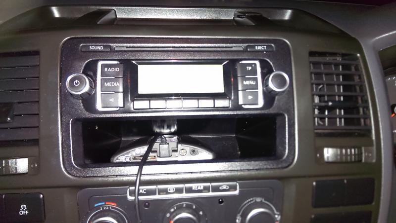

OK - the radio is an RCD210.

Hi again Jamwin the GPS antennae is easy because you can mount it underneath the top plastic piece as it only needs to be exposed to the glass area all of ours are in this location and they work perfectly , the camera is a little more work as you have to remove the tailgate trim and then run the wires up to the top corner and then out through the transfer boot then once inside the wires are run along the inside of the hood trim to the front passengers windscreen pillar trim which just pulls off removing the glove box will make connecting easier it has some some plastic covers over the screws once removed it also just pulls off . Once you have sent a photo of the unit I can give you some more specific help .
Just had a look that is the same style unit that's the upgrade model has , This one looks the same as the Zenec but has more features for less than a 5th of the price but no fitting included ES1029AU 7" HD CAR DVD Player GPS DVB T Ipod Wifi 3G VW Skoda Passat Seat | eBay Cameras are around $30
