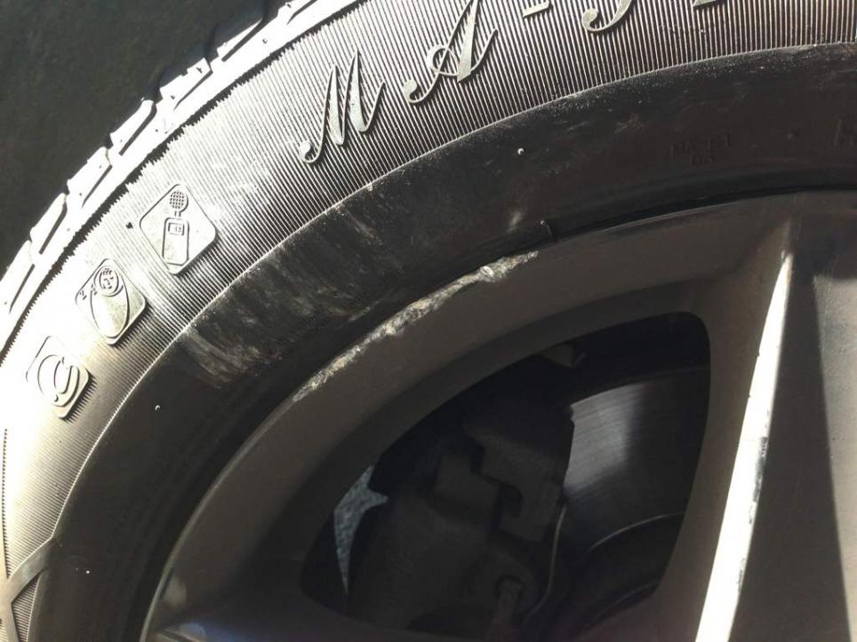

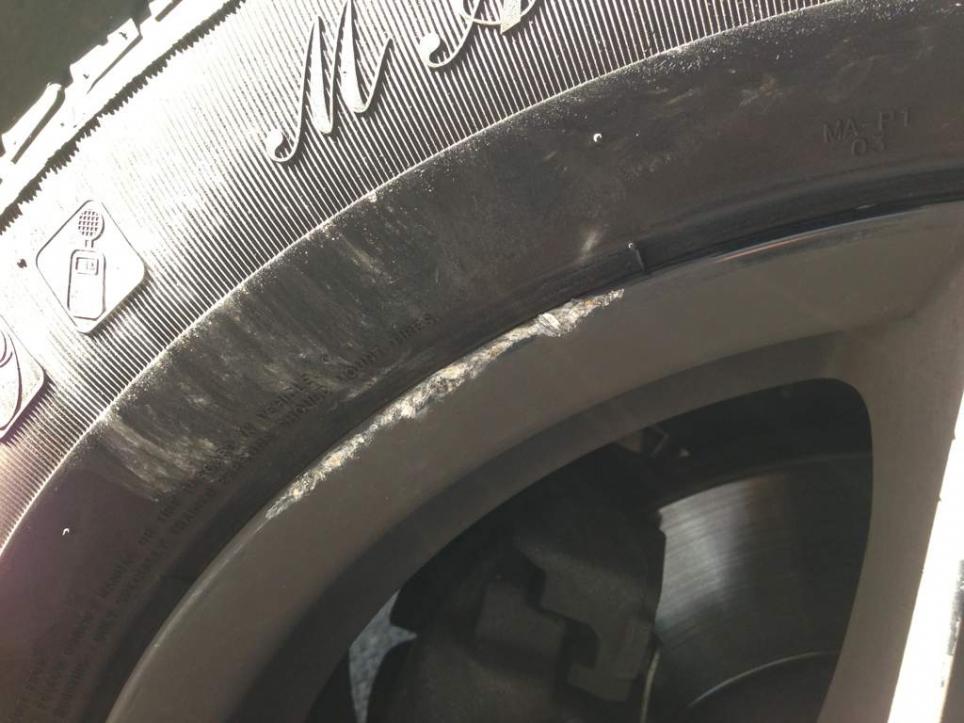

                  On a side note i found my front passenger side wheel has a nice big chunk out of it, the van has been moved around onsite there a few times. Pretty much every time I went in it was somewhere new. Was told to call back Monday when the service department is open. I've taken pics of the damage and the freshness of it. What do you think my chances are of compensation for it?

                    That's pretty nasty I would be mad as hell if it had been mine hope you get a fix for that, did you find it after leaving or while at the dealer ? . As for the Pre warranty check maybe its just me but if you stop and think would they tell you if there was something that they would need to fix at their cost or just say nah mate its all good and the following week or whatever something goes bung and they leave you holding the bag . Maybe an independent mechanic would be a safety net to make sure the dealer is not dodging something , I know not all dealers would be like that but there does seem to be some who have a reputation for missing the obvious .
