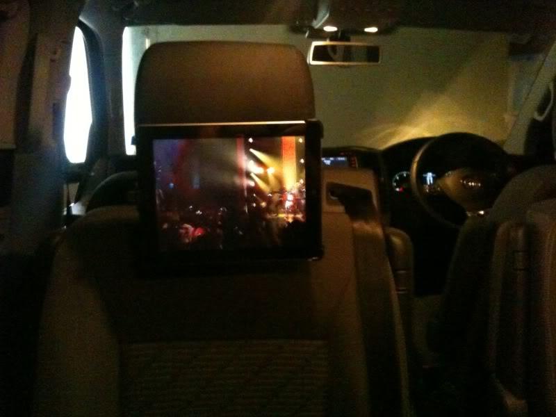

              • #37
                Finally got around to configuring an IPad as a media player in the Multivan. Utilises BT Audio streaming (works perfectly) and plays through all the speakers in beautiful sound. Secured at the moment with a headrest mount but will improvise a roof mount. Post update when done.
                Don't waste $$$$ putting a DVD player in ..... buy an Ipad and fit BT ....
