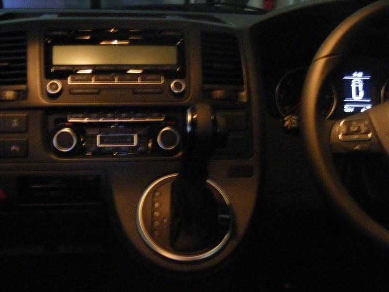

    OEM RCD510
    Good news is that the RCD510 OEM radio fully integrates with the T5.2. It is not an option from VW, but if you can get hold of 1 (about $450 on Ebay), its a 10min install job, did mine this morning. It integrates fully with the factory fitted Bluetooth, Climate Control and Optical Parking System. This is a real value for money proposition .....
    Stock RCD310

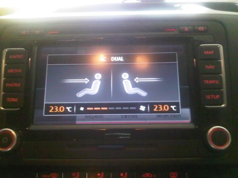

    RCD510 - Climate Control display

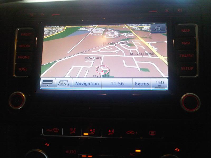

      Finally got around to it ....
      OEM RNS510 - SATNAV
      Even Better news is that the RNS510 OEM radio non-factory fitted also fully integrates with the T5.2 Multivans. It is an option from VW for $3950, but if you can get hold of 1 (about $1000 on Ebay), its a 10min install job, did mine today. It integrates fully with the factory fitted Bluetooth, Climate Control and Optical Parking System. This is a the best value for money proposition .....

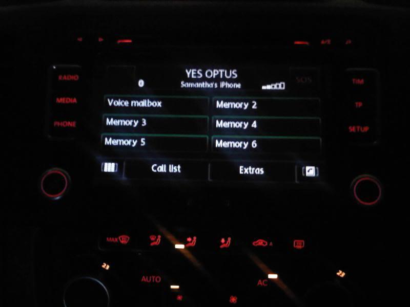

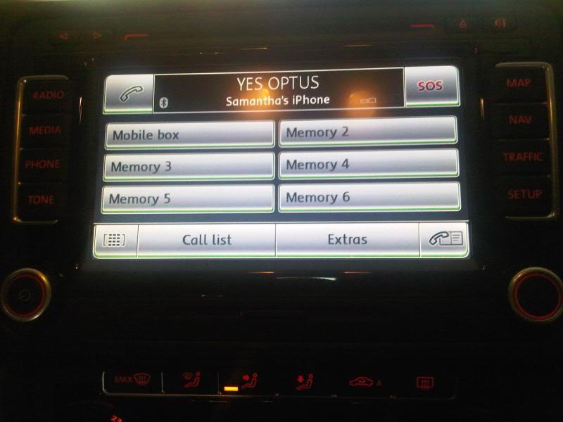

      RNS510 - Bluetooth Integration

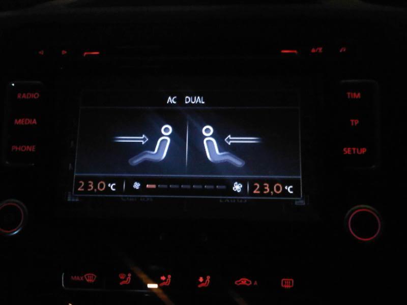

      RNS510 - Climate Control Integration

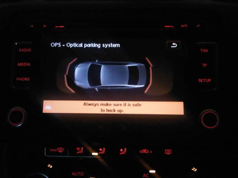

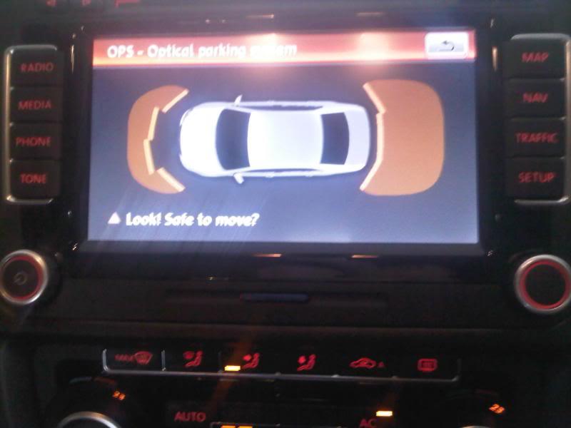

      RNS510 - Optical Park Distance Control Integration

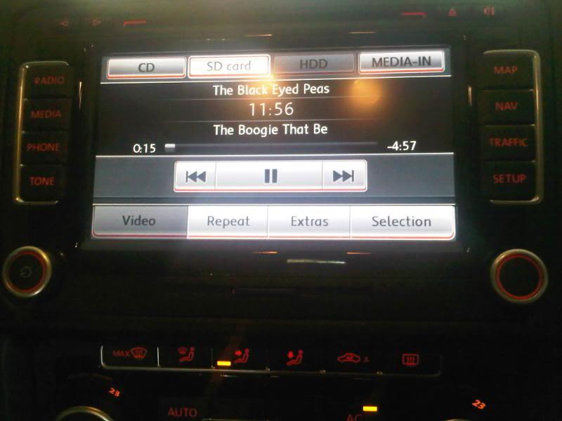

      RNS510 - Media Integration
      RNS510 - SATNAV

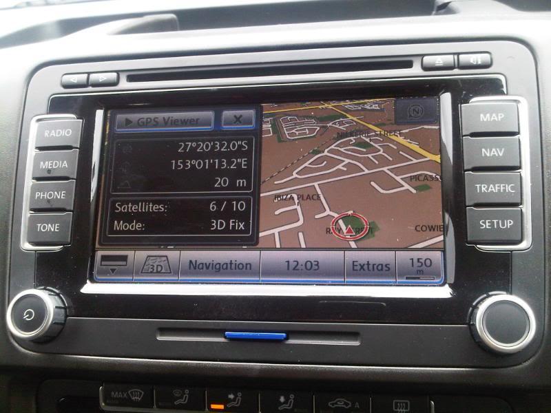

      RNS510 - SATNAV showing 6 out of 10 possible satellites
      The only thing I still need to do is use VCDS to code the display on the MFD. Will do that this week and update .....

                  Its the Optical Park Control/System ... something ..... you need more than just sensors, you need the OPC unit and a CANBUS cable to connect to the rest of the electronics. Those Ebay kits have it all, did a quick search and did not see any though atm.
                  EDIT: Turns out its OPS not OPC. Found a link http://cgi.ebay.com.au/VW-OPS-optica...item3f03c084e0

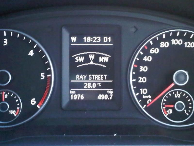

                    With the help of Guy, got the RNS510 coded today using VCDS.
                    MFD now fully integrates with the RNS510
                    Note: the aftermarket RNS510 here as commonly found on Ebay, displays the outline of a car in the Park Distance Control screen. The factory fitted RNS510 displays the outline of a Multivan. This is the only difference found so far.

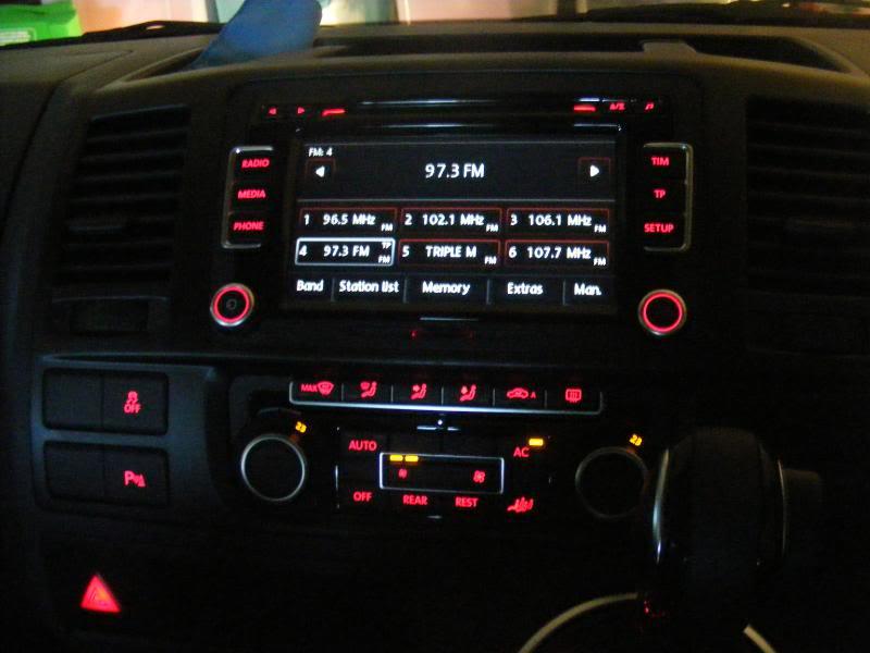

                        Here's a few screen shots of my RCD510 in my MY11 Multivan
