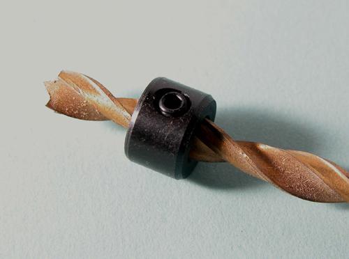

                              If you're going to drill through the floor use a drill stop (or whatever they may be called properly) to make sure you only drill through the floor then no further.
