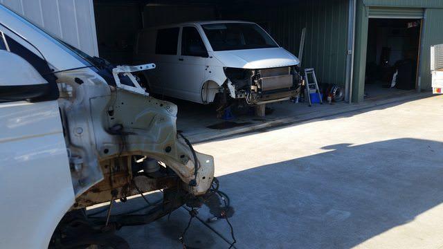

    so i kept checking auctions and up comes a 2017 Trakadu
    35,000 k's.....bi turbo...burnt out camper so no mech damage
    i am presently swapping out the engine
    its also a 4 motion and has lots of other good parts which i will be usig eg.brakes,hubs,all coolers,radio,leather steering wheel,seikel shocks,exhaust,rotating seats(although they do need recovering due to roof melting and dripping on them)with armrests,cluster(has heaps more features than 2010,i just hope its compatable)
    i rang my "go to man" today and told him what im doing.i said i swapped the ECU out too and he told me it wouldnt start unless i swapped cluster too...ah well,i was planning to do that anyway
    first thing tomorrow ill swap cluste rand if theres a problem,i will put back the orig ecu before i get too much put back on

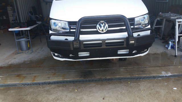

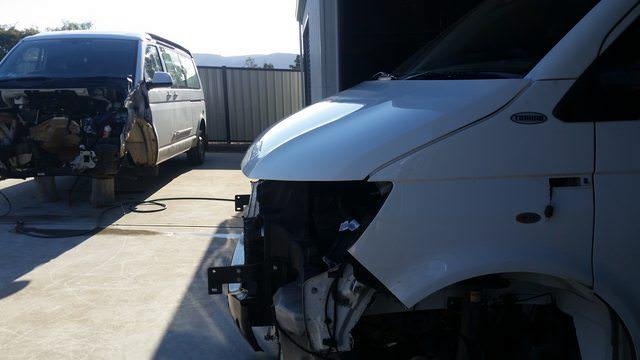

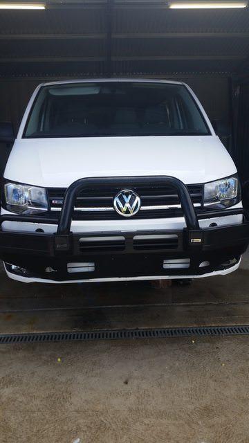

    i also plan to use T6 front end as it has a bullbar...bonnet,front guards are different but they look like they will fit

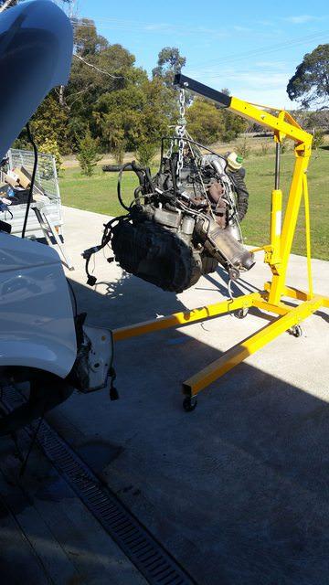

    today i dropped new engine into eng bay and started connecting
    this is first time for me so been taking it slow but now starting to get really keen,seing it come together
    will post mor pics as i get closer

        i could use chuck norris
        those engine hoists need 3 people to steer them
        when i finish this vw i will be putting decent wheels on the hoist
        today got lots done
        the engine bay is finished

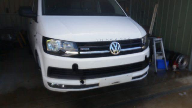

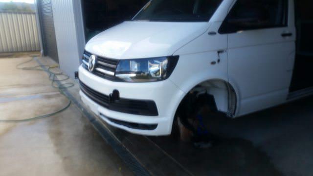

        swapped the guards(wings) and bonnet over and spent half a day aligning same.....wings needed extra mounting hole drilled,and side lights are different so need to rewire same
        happy with result tho
        dry fitted the bullbar so no drama when i go to fit it tomorrow
        hope to finish axels tomorrow,then a lay day as need to go into town for some wire to make loom for 02 sensor
        but its getting there
          I have the same style of hoist but the wheels are bigger and mounted to bars that can slide out to give more stability.
          I'm thinking of putting pneumatic trolley wheels on it so I can pick up rocks with it and move them around the garden.

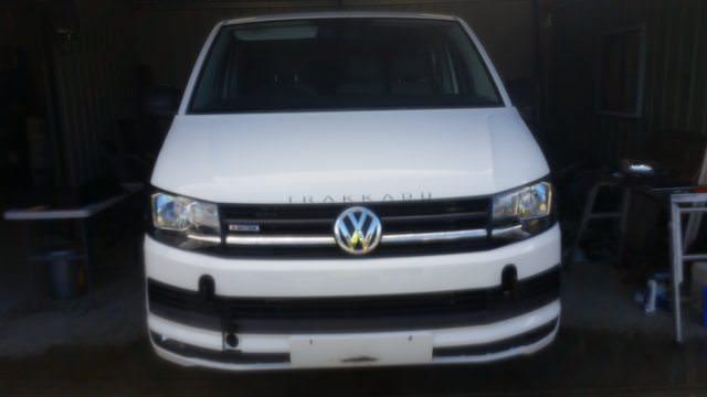

            i fitted the new front today and must say its taken my 2010 van to a new level of aesthetics
            fitted drive shafts and hubs/brakes today so all thats left is:
            bleed brakes
            connect exhaust(need adapter made as new header pipe is larger dia trhan old header.i could swap the mufflers but getting lazy now)
            swap out cluster
            make a longer loom for DPF? pressure sensor(t6 is mounted near tailshaft where t5 is mounted on engine)
            wire in different wing clearance lights
            top up power steering tank(i swapped out full steering rack because t6 rack had low k's tie rod ends)
            put the wheels back on then see if it starts

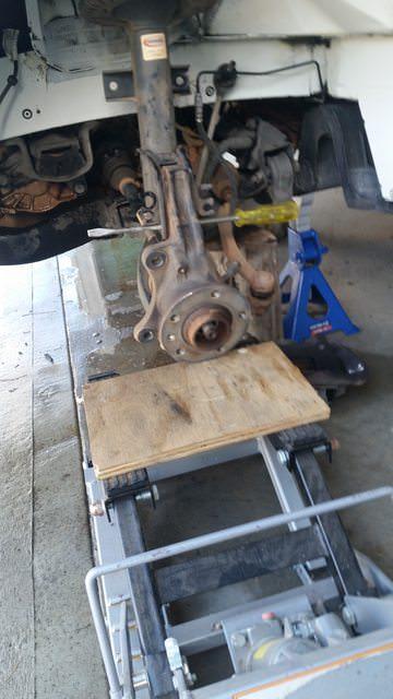

            the last pic is an atv lifter which i use to lift my can am spyder
            it was really helpful helping me with the weight of the hub/cv joint and shaft combined(i didnt split them as was swapping both out)...these were really heavy and im working alone...when finished i flipped the wood and used same as a stool
            T6 front end

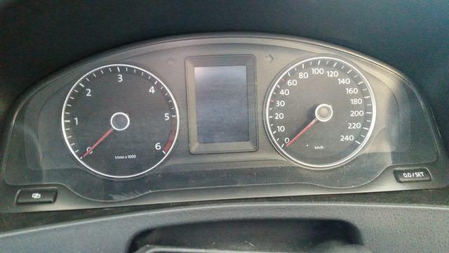

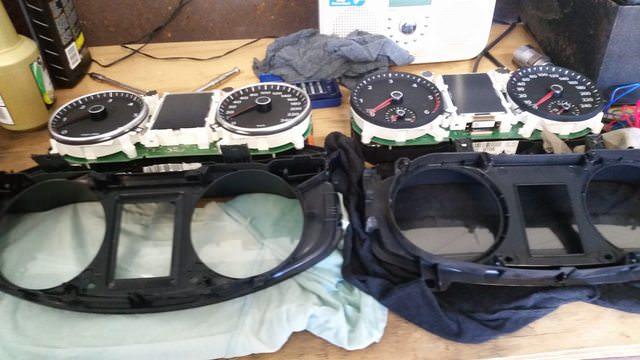

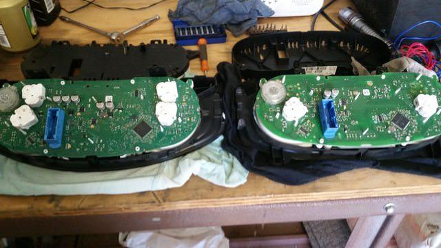

                  got started around midday and the focus today was on the cluster swap

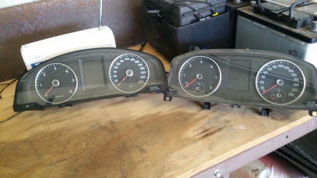

                  i wasnt convinced the clusters were the same,as the reset buttons on both are slightly different
                  so i started on the wreck,and removed the radio,the steering wheel,the cluster and the ignition switch
                  i wanted to change ignitions anyway,as my switch was diabolical....9 times out of ten i couldnt get the key to come out
                  its a real laugh when you go shopping and have to leave your van with the key in the ignition
                  could be difficult to explain to the insurance co
                  when i was talking to go to man,i mentioned this and he said it was prob the gearstick lever button on the side
                  anyway,better to have a near new ignition
                  so carefully removed the bits i wanted,then moved onto the 2010 go van
                  first thing i noticed was how easy it was to remove cluster.....not like the T6 which was way more difficult
                  so then i matched up the 2 clusters,and to my dismay,they are totally different
                  now i am looking at swapping out the complete dash
                  i was contemplating doing that anyway,but not just yet,i want to get the van going first and i cant without the T6 cluster
                  as you can see...diff shape and mounting
                  i did contemplate grinding the lugs off but hey,i was desperate
                  thats when i had an epithany?
                  keep the outside of the cluster,but swap out the inside....i mean,the stuff i want is inside the cluster
                  this proved to be extremely easy....4 screws and the whole thing comes apart
                  and surprise..both clusters are identical inside,mounting,everything
                  so i changed them over(while fervently giving thanks to any deity i could think of)boxed the thing up,then went to fit same

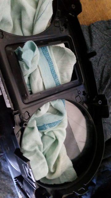

                  alas,what i hadnt seen was an inside of glass which looked like a spider had been in there
                  you can see the grot left side bottom on the glass inside
                  so i pulled it apart again and cleaned the inside of the glass
                  unfort when i went to fit same,i noticed a large piece of white fluff which refused to budge,so i pulled it again and ended up with a perfectly clean cluster
                  im really relieved i dont have to swap the dashes out(yet) as im going away on monday and would really like to fire this van up before then
                  removing and cleaning the inside of the cluster on the T5 proved to be really easy

                          unfort the T6 radio didnt plug in...i must have a T5 or 5.1....anyway will get it rewired later
                          the cluster works well but dosent seem to "page"...may need to sync it
                          the brake lights are on all the time
                          the "crazy Ivan" logo on the cluster is always on....is it ABS? may be connected to the brake lights being on.......appears to be stability control...not sure why this is on

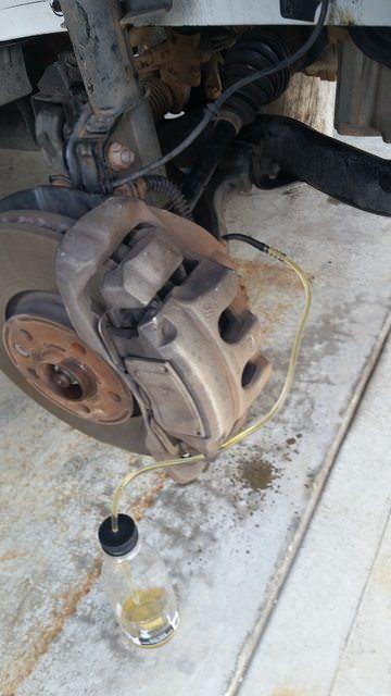

                          bleeding the brakes was a complete doddle...i bought a "one man bleed" gizmo from supercheap and made up a bottle to keep things clean...worked a treat
