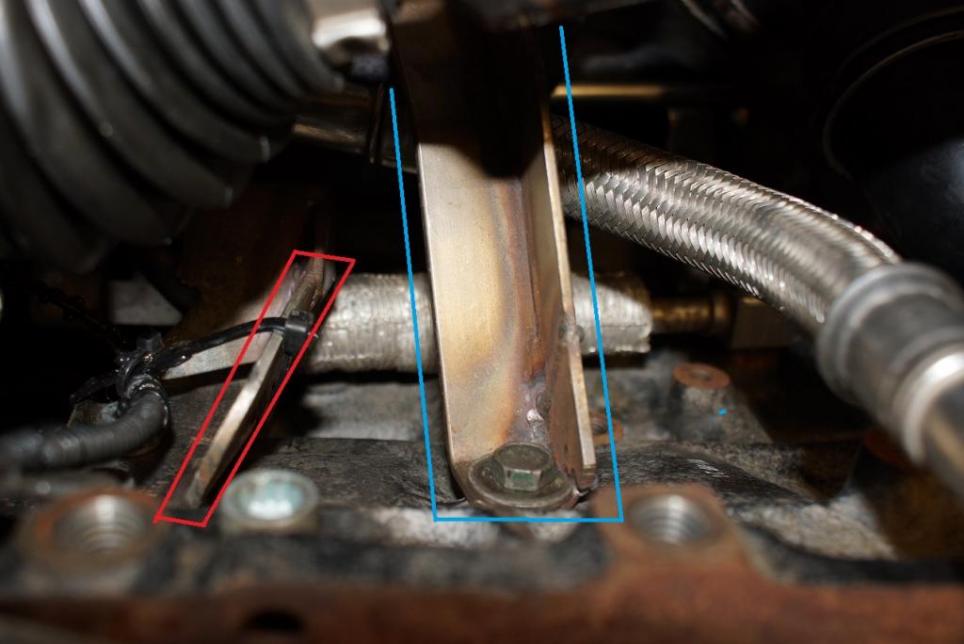

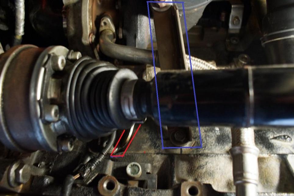

                    O.K. folks here's a couple of pics of the turbo support brackets I done a while back.
                    The first pics shows in red the extra rib welded to the standard support bracket & in blue the bottom part of the extra bracket.
                    The second pics shows the extra bracket where the top of the blue is @ the downpipe flange.
                    Both of these are set up to give extra uplift when doing up the bolts.
                    May be to understand these pics., ya have to have a good look when upside down & underneath.
                    Hoping this helps a bit.
                    Hooroo.
