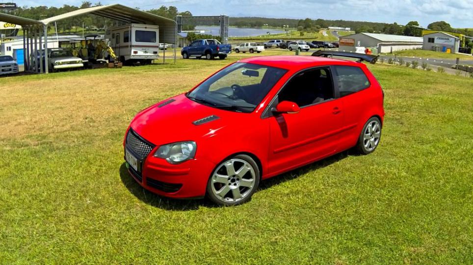

                      It all went really well today. 4 sessions of "carbon cleansing" and no hint of a niggle.
                      Best lap of a 1:03.36 (my PB is 1:03.1), but given it was 31+degrees all morning and full tank of a fuel, I'm very happy with that. Having the rear sway bar on hard was all good too, had a few little slides, but generally happy with the balance. Lap times weren't as consistent as other occasions which I'm putting down mostly to heat soak more than anything. Had a hoot.
