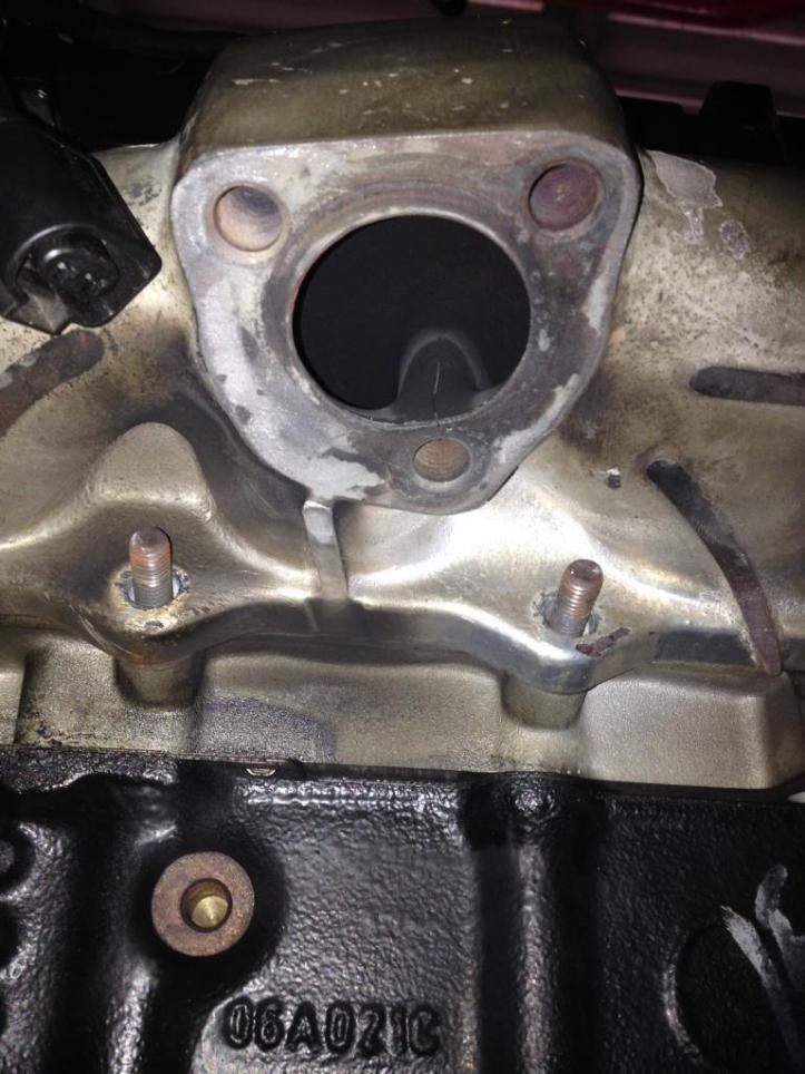

              • Picture of the crack in the manifold while it was on the car. Crack is through the whole way.
                Daily: 2010 VW Jetta Highline

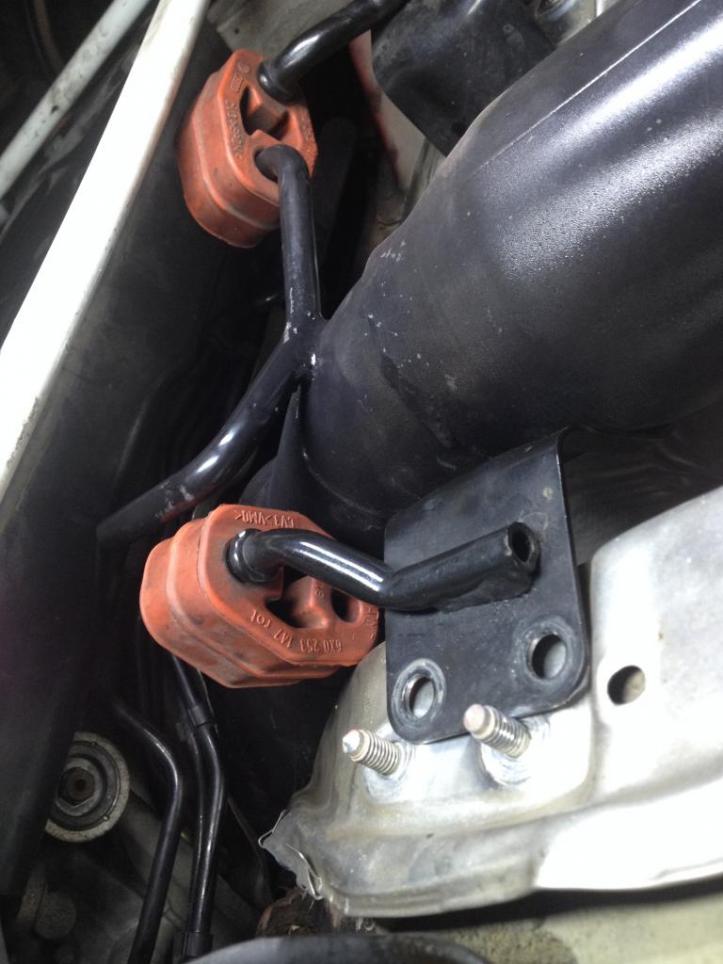

                • [QUOTE=seangti;1097430]Picture of the crack in the manifold while it was on the car. Crack is through the whole way.
                  The bracket that wasn't on the exhaust. There were no bolts.
                  [/QUOT
                  Nice crack, and its the one with the dodgy stud. No nuts on the bracket man that's poor. Never seen that , didn't have the pipe off mind you and that sort of thing should have stuck out, no way they should run off so they musnt have been there, maybe just in there location , that under heatshield, not sure judging by pick? I was paying more attention to the short circuit, ( main reason car was in care, Guess I have to add that , shouldn't but do ) not to worry mind wont help it now. Hope the new manifold holds up , that's making me think big time with the ATP I was going to use on my 20V conv.
                  Jmac

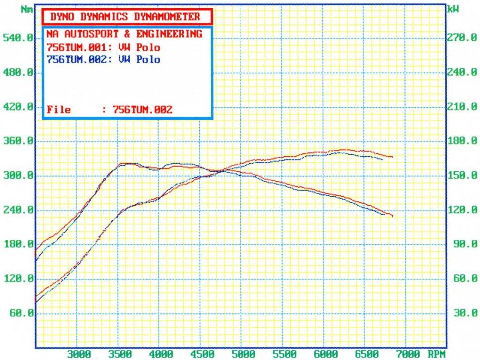

                              • Had a dyno run done on Friday to see how it's all going, made 170.2kwat.
