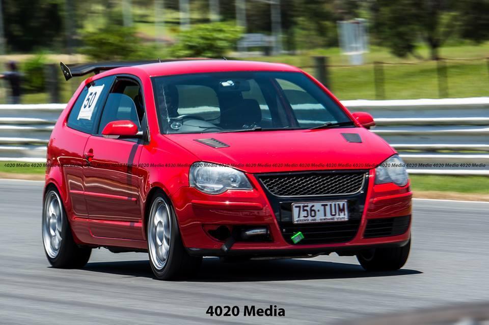

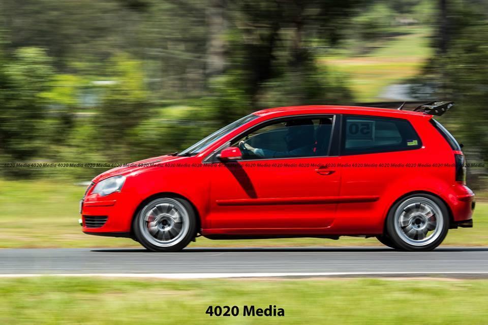

  • I ran at lakeside Timeattack last weekend with the car all sorted and optimized from some earlier fiddling with sway bars.
    I ran a best of 63.6, with my best 3 laps within 0.1s of each other. This is 0.5s slower than I'd ran on the previous turbo and previous old tyres. By way of power/peak speed, my silver car would peak at ~178kph, this set-up was 185-188kph and with the previous turbo and tune was ~192-194kph. There is more time in the car, about a second according to my data, so I may eventually get that 62s lap. Based on the analysis and times achieved, I'd say the car is 0.5s slower in the current state of tune.
    The V70 tyres were really good at speed and good under brakes, a little lesser around mid corner on the tighter stuff, they seemed to roll over a bit more than the Bridgestones RE55s did. I ran them to a hot temperature of 34psi. Corner speed was much the same as the old tyres, though I was incrementally quicker in some sectors than when I did the 63.1s lap... The time loss is mostly down to lesser power to get out of the corners and down the straight.
    With the car running well, I decided to run a session without the wing. Yikes, the difference was obvious. I'd say it's much to do with the relatively aggressive rear sway bar set-up I'm running so it's all complimentary at the moment so I've essentially unbalanced it by removing the wing. By just removing the wing, the rear was very twitchy at speed, the car really wanted to pivot and my corner entry speeds were down by 5-10pkh. It was a crazy unnerving to the point that I came in from the session early. Really good validation.

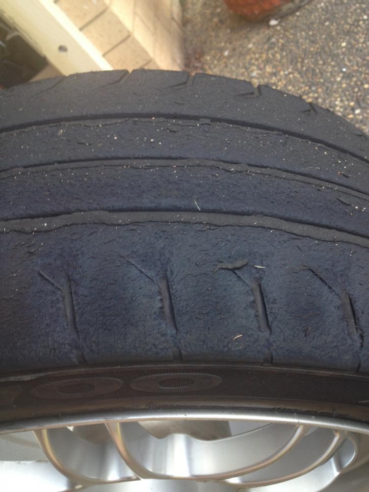

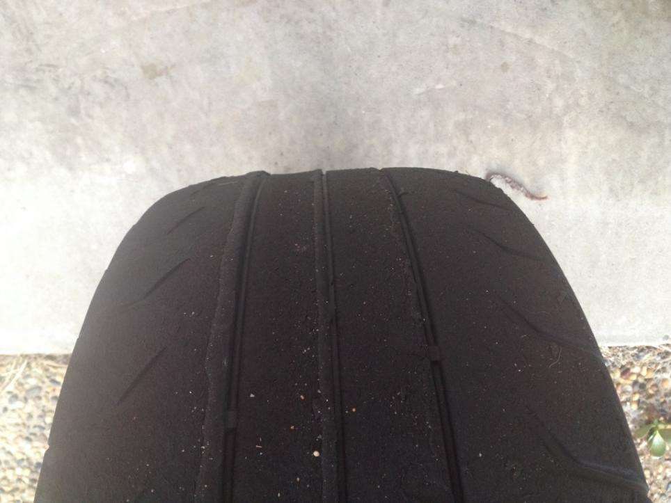

                        • Had the final 2015 TimeAttack on the week, was great to get out again as it's been a few months since running at lakeside. Last time out was the first time I'd ran the kumho V70 tyres and I'd noticed significant tyre wear on the front left as below. I got specialist advice which indicated that the tyre wear was due to lack of camber (and over driving), so got the alignment sorted last week, now running -3.8 degrees camber front left to account for the right handed circuits.
                          The discolouration is from overheating of the tyre. A blend of lack of camber and over driving.

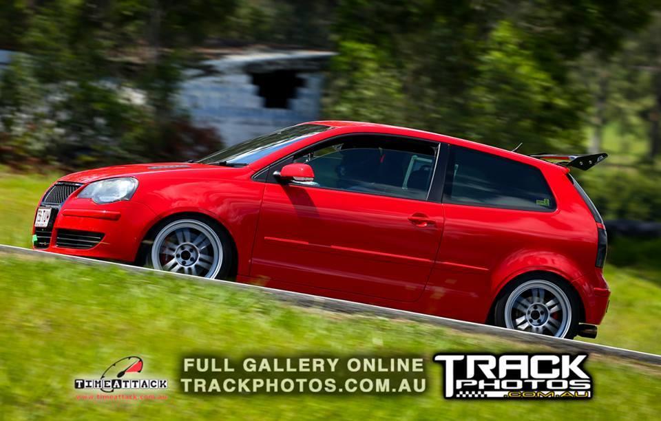

                          Anyway, for timeattack it was a hot day at around the 29-30 degrees though the car ran awesome and felt good with the increased camber. I got a new PB for the current set-up (new turbo and lower boost) of 63.34s. Had quite a few 63s laps which I'm quite happy with. This is still a slower time than I achieved with the previous turbo and higher boost of a 63.18. My goal is to crack into 62's, so that'll have to wait to next year. It's certainly in the car, but it's making me work for it.
                          I'm surprised at the stance from this shot as the car sits reasonably high from a lowered car
