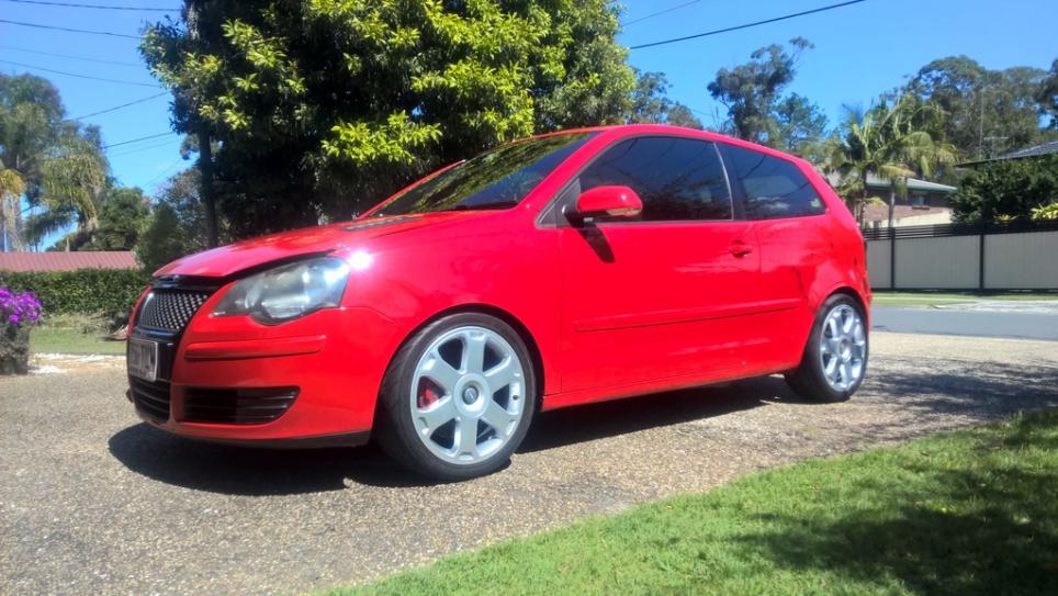

                    • Bit of an update, so the new semi slicks, kumho v70's, are now on the enkei rims to be ran for track days and I had the old Audi TT rims refurbished at The Wheel Workshop at Albion in Brisbane, to now be ran as daily wheels. I've had to raise the front of the car 1cm to fit the kumho's as they are a 215/45/17, not a 40 series tyre. Also decided to remove the wing and only put that on for track days. Wheel Workshop did a great job on the refurb, they look better than new and very reasonably priced. Now the car looks so unassuming �� It also got a good detailing last week, clay bar and polish.

                      • Well done, mate. Can't wait til the next track day!

                            • Looks awesome mate. Will definitely be a lot more "under the radar" with the wing off. The wheels look great too, they turned out better then I expected
