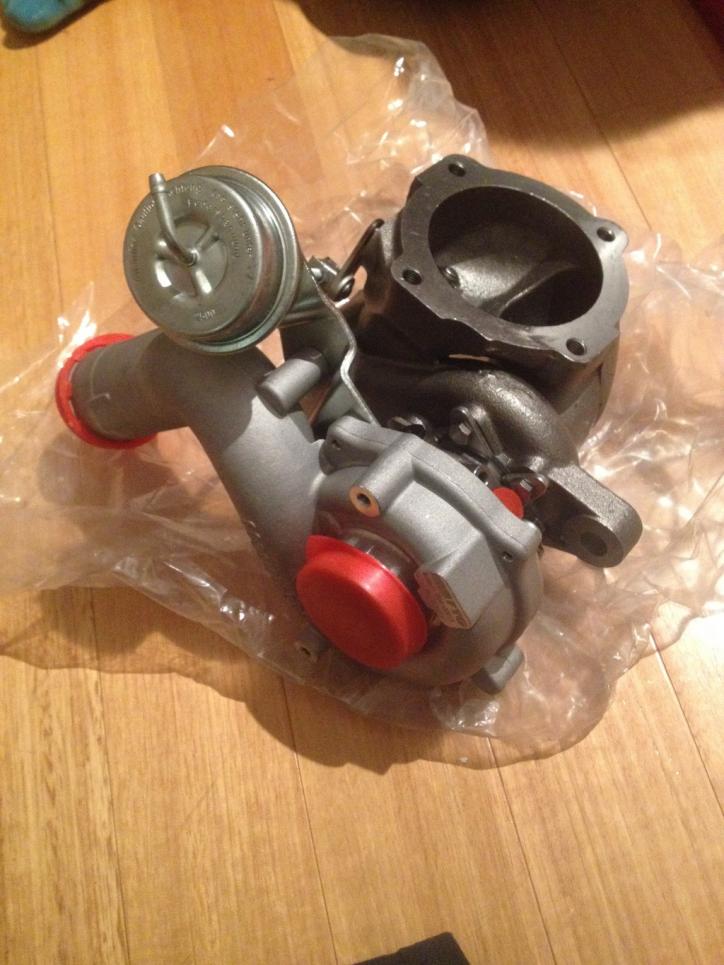

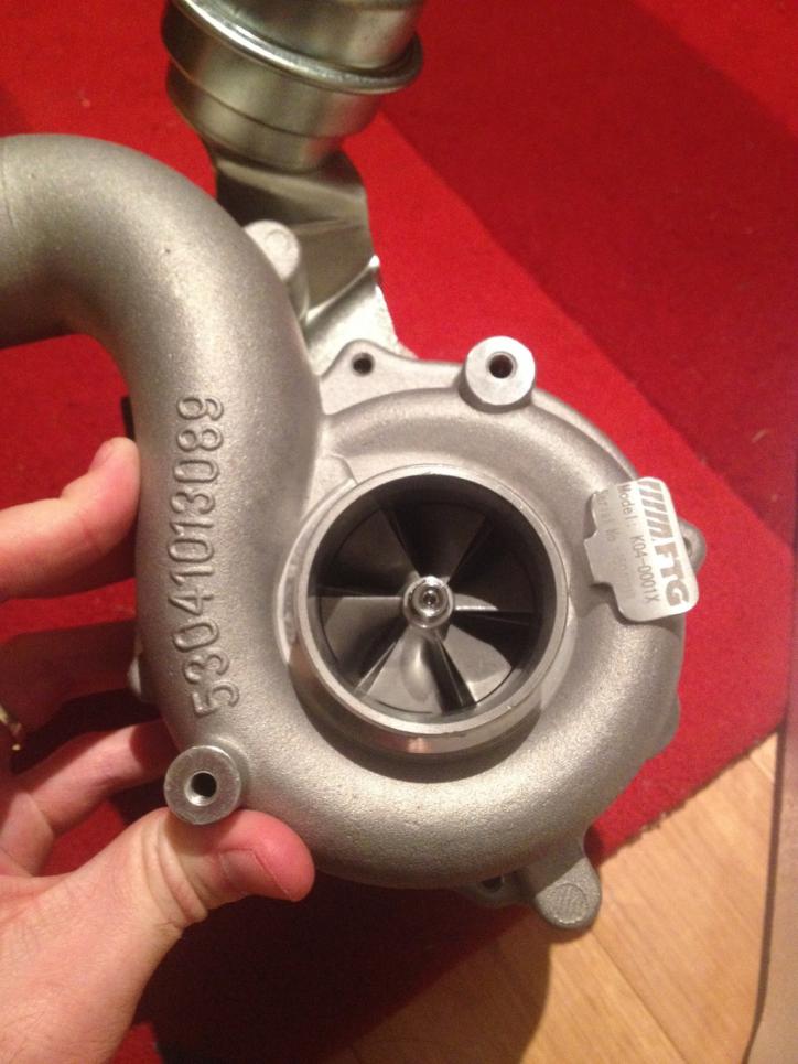

Some progress on things. The turbo has arrived and looks the goods. Have also ordered new turbo bolts and gaskets. Will get to fitting over the next week or two.

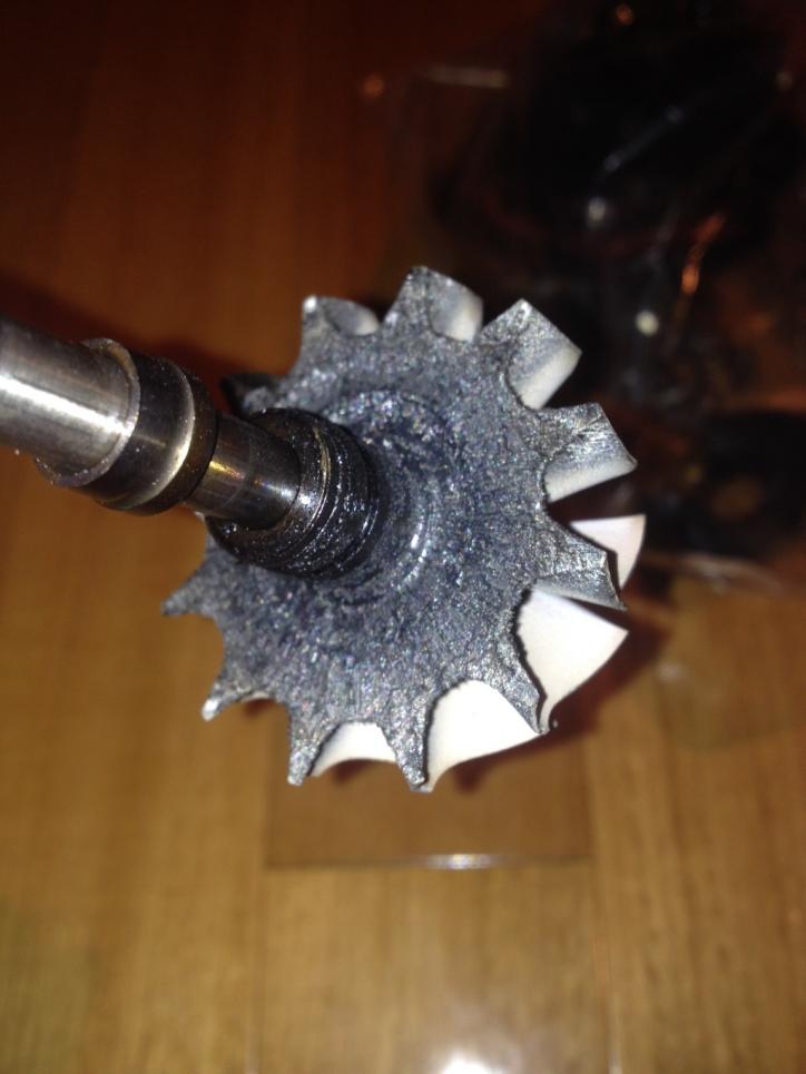

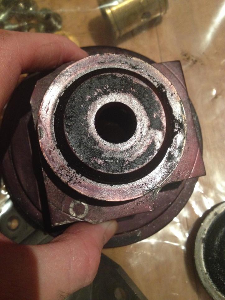

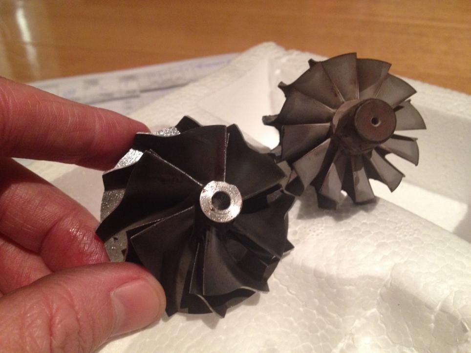

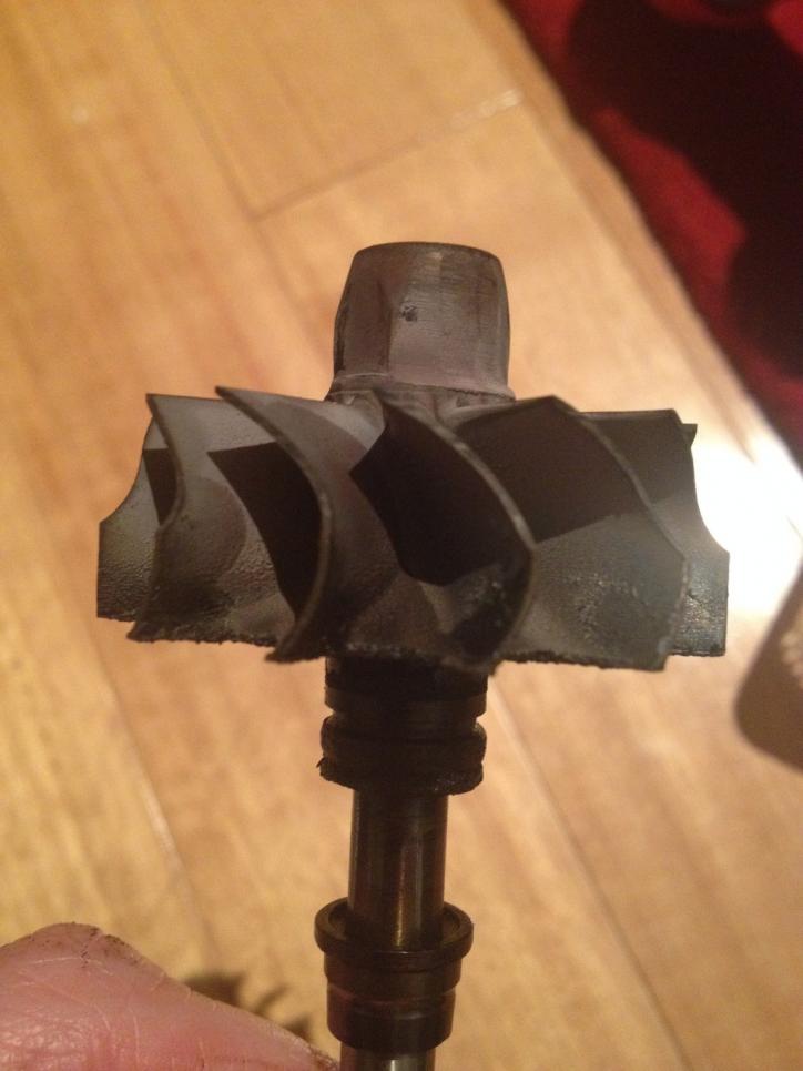

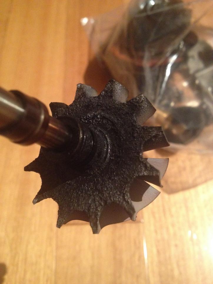

Also picked up the shagged turbo on Tuesday. The exhaust side of the turbo has been well cooked. Though unfortunately still none the wiser as to the real cause. I wanted to rebuild and support locally, even at a higher price, but it'd be madness to get it rebuilt and do nothing different and expect a different outcome. If i can't find the root cause, it's just throwing money down the drain. Oh well, here's some pics. The oil has hardened (carbonised), and metal turned white, really quite interesting to see. Albeit disheartening.
That's the exhaust side housing.Track Car: 06 Polo GTI Red Devil mkII
