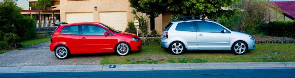

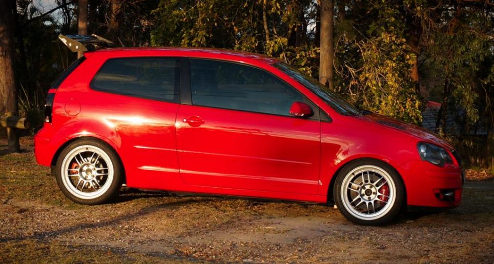

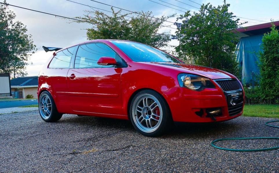

        • Spent the afternoon washing cars. My two and the missus. I won't share pics of hers...
          Ride height wise, from ground to the highest point of each guard, the fronts is 60cm on both sides, rear is 62cm on drivers side and 62.7-ish on the passenger side. Not sure why the difference, could be intentional, or not. All our tracks are right handers, so whether having the rear left marginally higher aids turn in or grip... I'd be making it up to suggest either way.
          The rear is probably near on 2inches higher to how it was when I bought it, so the car formerly known as red devil is now the red giraffe, haha I'm really chuffed with it now. Arghh, come on October 11.

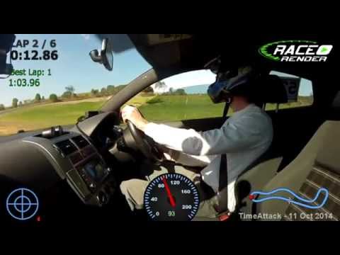

                  Yikes, how'd you find my times so quickly? On the Natsoft site already??
                  Yeah the car felt very good, very stable and didn't throw me any surprises. Knew there was a mid 63 in me/it as I only had one clear session before mechanicals last time. I feel there is a high 62s potential while I work on my braking and tidying a few driving traits. I felt that I wasn't always smooth getting on and off the brakes which unsettled the car a bit. Really had to focus on bracing myself before grabbing the brakes and remembering to modulate the pedal, I found it settled the car and was carrying a nicer entry and marginally more speed in to the corner.
                  For the last session and consistently faster laps, I ran 4th gear through the back dipper (hungry) and hairpin (eastern loop) rather than 3rd. It suffered only a little on exit of eastern loop, but prevented quite a bit of wheel spin and unbalancing the car during shifts, perhaps grabbing 3rd mid eastern loop to get me out may be worth trying. Apart from a missed gear shift, rather than grabbing 5th gear I got 3rd, almost shat myself as it was a 6k shift from 4th gear... , I didn't feel the need to rev past 6k all day.
                  Timeattack yesterday was awesome, not many cars out there. In one session I think there were only 3 or 4 of us. My last session, I didn't see anyway on the track, so clean, repetitive and committed laps.
                  There's more waffling I can/will elaborate on re tyre temps and pressures, will do that later. I'm uploading video at the moment, give it an hour before checking.
