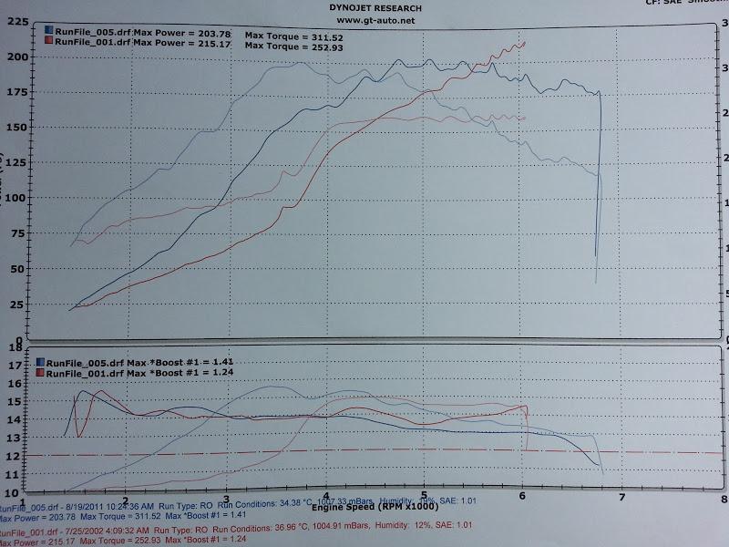

                Nevertheless, I'm going to keep on trying to get it resolved soon, one way or another. In the meanwhile, I've unplugged the MAF sensor to overcome rough idling and lean issues. Here's the recent baseline dyno figures based on stock injector reflected in "red" vs stock k03s setup in "blue":
                There's a huge shortfall I need to recoup. Might not be just the remap, I would think it might be something to do with sensors like MAF, N75 and even boost etc. Oh well
