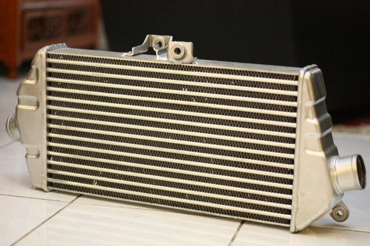

    Mitsubishi Lancer Evo3 intercooler (500mmx300mmx65mm) with all new custom piping

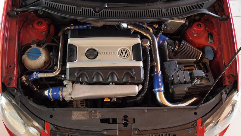

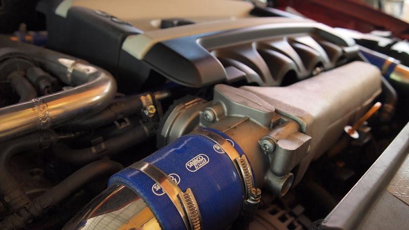

    Engine Bay

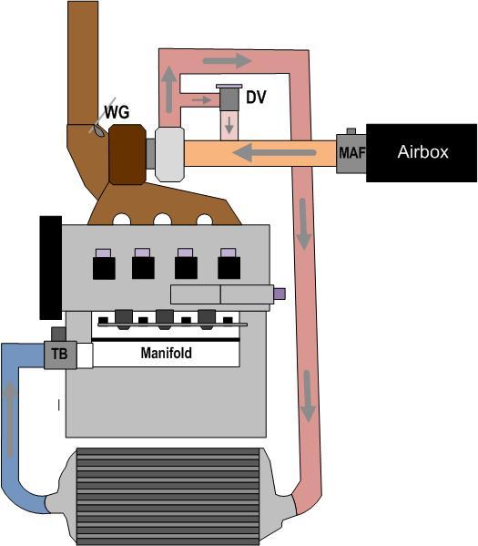

    Idea Behind Custom FMIC
    Evo3 Intercooler
    Engine Bay (Close-up)
    Discreet Front Mount

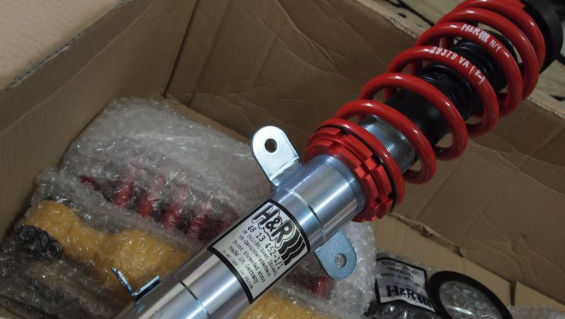

    H&R Monotube Coilovers

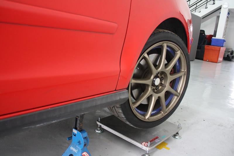

    With H&R Coilovers
    Suspension Setup

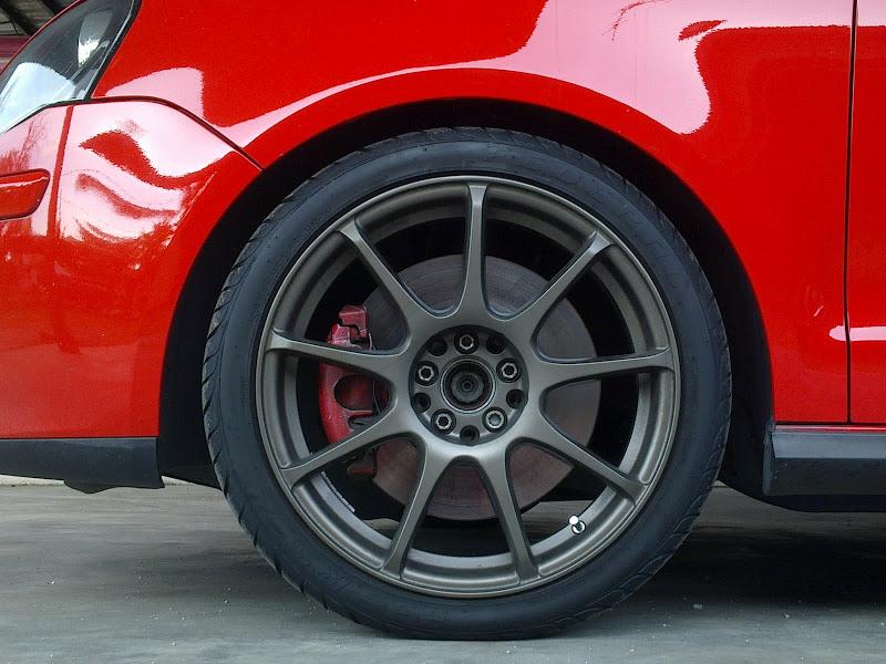

    Wedsport SA70 Replica (Resprayed)

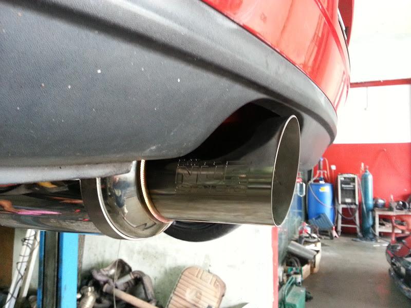

    Custom 2.5” Piping
    Blitz Spec Nur

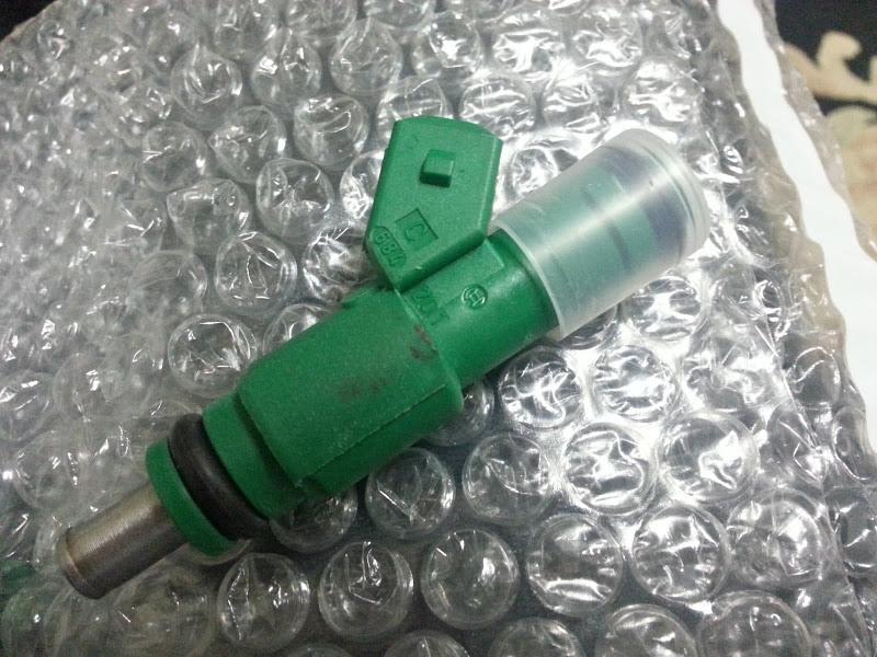

    Genesis 415cc Injectors

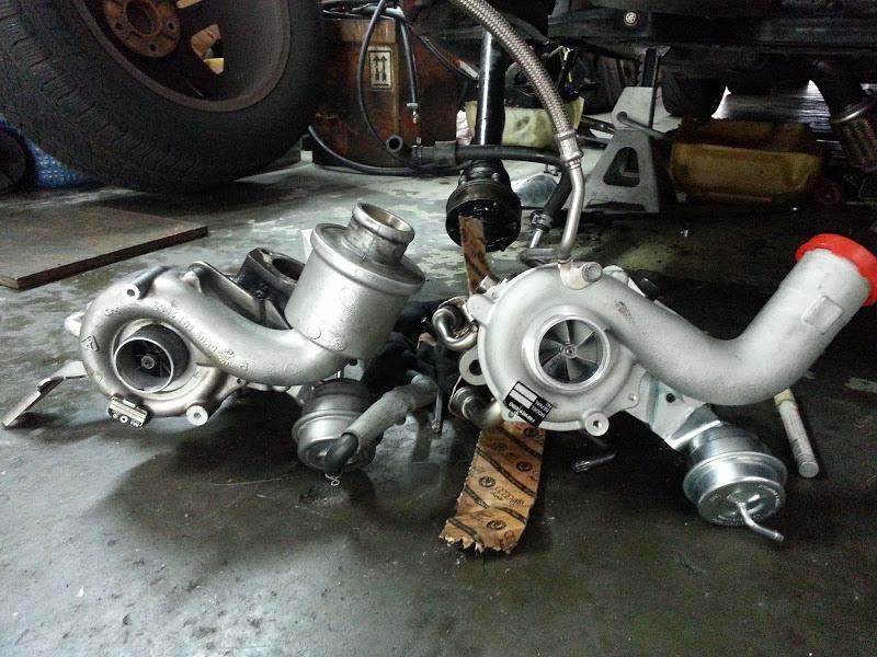

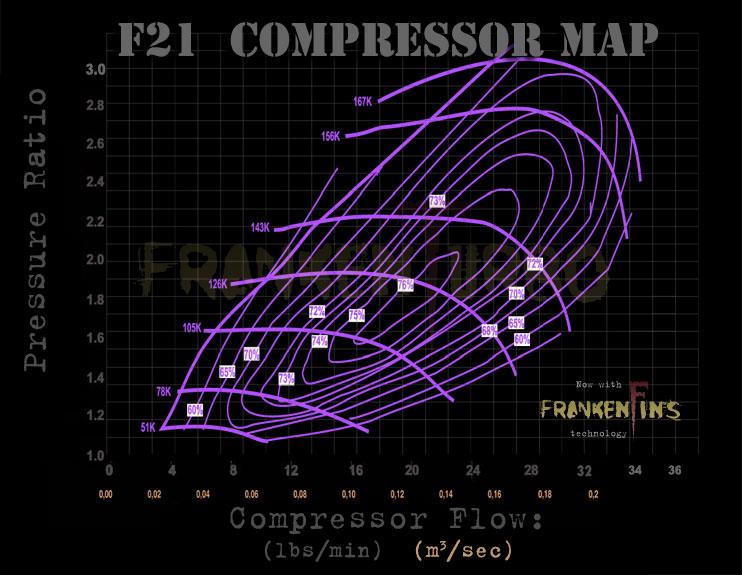

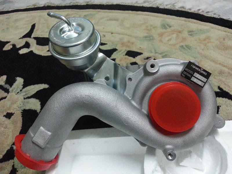

    FrankenTurbo F21T
    Compressor Map
    Comparison Between K03S with F21T

            Your engine bay is nice and neat.
            The wheels suit it. Are they a standard fit or did you have them redrilled?

                    Amazing stuff mate! Especially love the Intercooler set up.
                    But I don't think those fuel injectors are meant for the polo. Could be wrong but I think you'll find the spray pattern all wrong plus I would be surprised if the fit in the intake manifolds injector seats. You need the EV14 style injector I'm pretty sure but check with your installer.

                      They look like AEB stylee ones.

                          Although they're replica, it's almost a standard fit provided if you get aftermarket cones. And no redrilling needed if I recall correctly.

                          The intercooler was done by couple of Myanmese working for friend of mine. Their welding or artwork is pretty good.
                          Injectors. Now you get me scared mate
                          I did went to USRallyTeam.com, basically Genesis provided two options:
                          415cc for VW 1.8T small port (which is this one): Genesis 415cc - High Impedance (1.8T small port/R32) : USRT, Usually Sideways Rally Team
                          415cc for VW 1.8T big port (AEB, AGU): Genesis 415cc - High Impedance (16v/AEB & AGU 1.8T) : USRT, Usually Sideways Rally Team
                          Which one should I go for? Better ring my mechanic asap

                              The second ones look like the correct shape and length bud.
