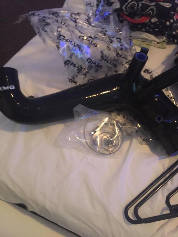

                      • New parts this looks like it will be fun to install haha and car is booked in for Friday for the guy to check the tune and see what's going on hopefully they will find the problem just wish I had time to install the TIP before I take it in
                        • Probably best that you take it back in the same configuration they last touched it with anyways.
                          No point changing things and then complaining about it.
                            You'll need a male to male connector and a small hose clamp for the lower hose connection. The forge ones come with one installed from factory but these don't so it makes life a lot easier if you fit put one in before you install it into the car. I learnt the hard way
                            2006 GTI Polo - Big Turbo Build - Louis19's Build Thread
                            • Thanks mate yeah I looked into it so I know about the male to male connecter I most likely have spares already from my old cars and I have spare clams laying around if I have the time I might give it a go on the weekend but I'll see what happens with the tune first but I know it's low on power cos the streets I drive too and from work everyday that I like giving it little hits use to fry it now no chance even up to 6k can't even make it chirp in second lol
